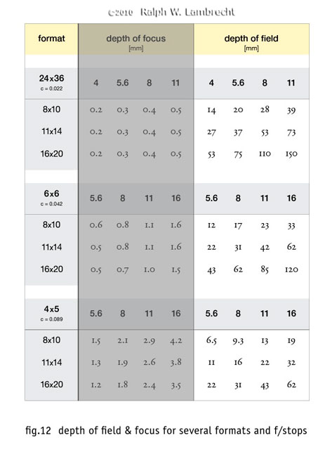

I'm not surprised, looking at the attached depth of field table. Placing a piece of paper under the grain focuser to compensate for the missing paper thickness is theoretically correct but practically pointless. Placing it on a dark easel as a focusing aid is valuable.

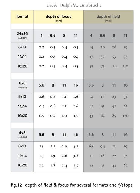

You are mixing issues! Enlager alignment and glass negative carriers make sure, you can live with limited depth of focus (see the next table attached). Depth of focus (tolerance at the negative stage) is critically sensitive for an enlargement, depth of field (tolerance at the baseboard) is not.
