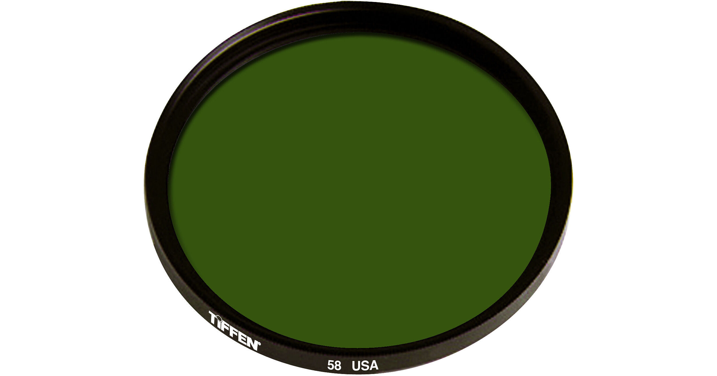

They are indeed hard to find. Luckily I still have a few Wratten greens, as well as a Marumi glass filter.
Here are green filters including #58 and others
Alan Edward Klein
Aug 29, 2017
10,202
New Jersey formerly NYC
Now that I look closely, it seems they are all Special Order for #58 green.
