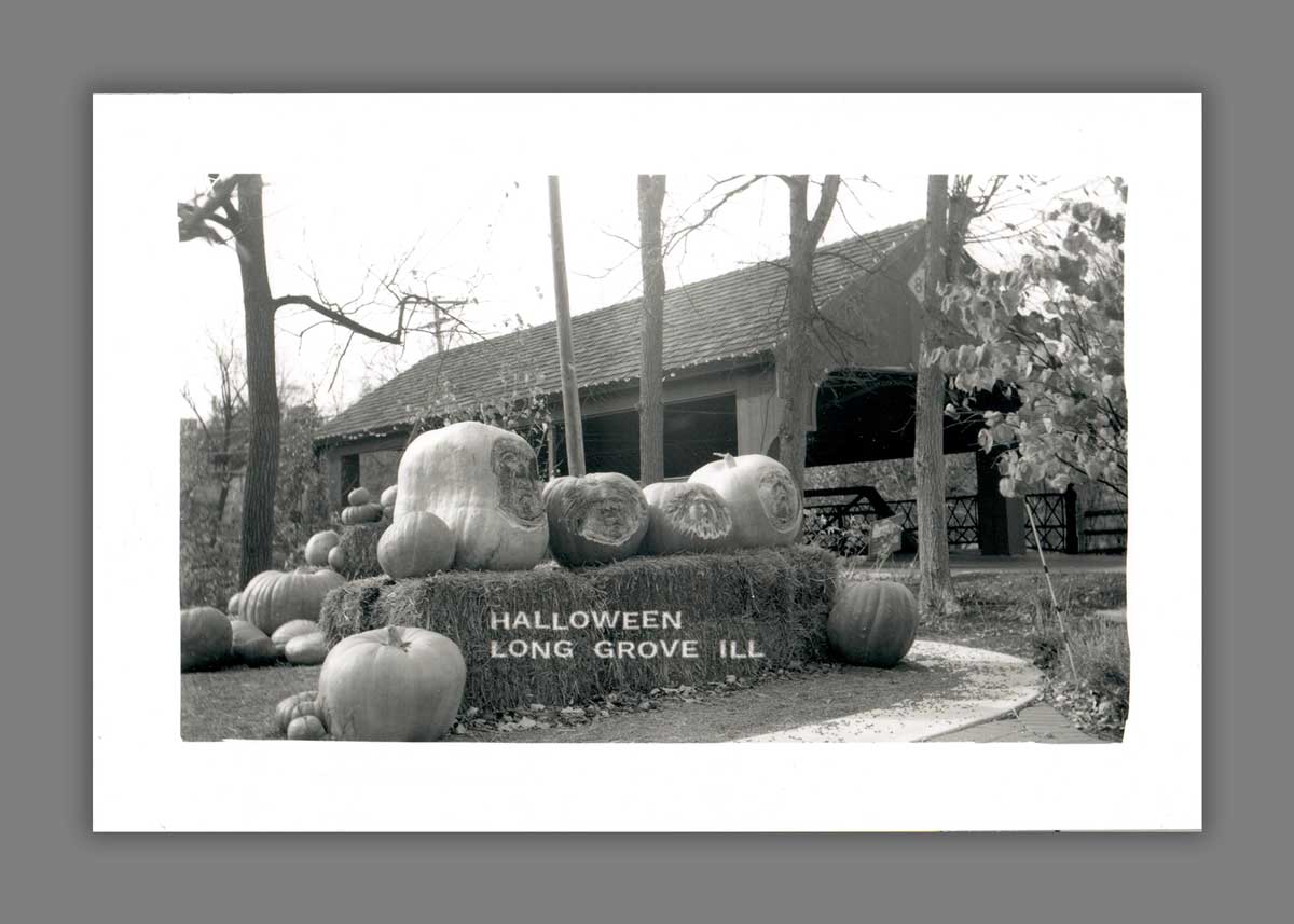

Here's a scan of successful print for one of my goals - negative shot in Kodak 3A and contact printed on modern 4x6 double weight paper:
Since my negative is only 3.25" tall, when I printed I masked it to 3" tall, so 1/2" white boarder all the way around. I put the gray background behind the scan of the 4x6 scan to better represent what it looks like in person.
I'm pretty happy with the vintage feel of the actual image, but there's something about the white boarder that jars me into a more modern feel. So thinking maybe a black background/reverse masking might feel better. As actually printing this would be a bit complicated, I simply mocked one up in photoshop to see if I felt like it was worth messing with. Here's that mockup:
I do like the black border quite a bit better, so I think I'll give it a go for real. It'll look even better if I can figure out a way of incorporating the live edge of the image.
One of the complications I'm having to deal with is that the image isn't very "square" on the negative - e.g. the straight edge of the image isn't parallel of the straight edge of the film. This is due to some combination of me not cutting the film exactly straight and the film not sitting precisely squire in the camera. It's manageable, but just makes putting together the contact printing "sandwich" more of a challenge.
Here's the final 4x6 on Ilford Portfolio Pearl. This shows the live edge on the negative all the way 'round and I think helps with the retro impression. I'm happy with the look and the couple people I showed it to mentioned "it looks old".
Interestingly, the Ilford 4x6 paper is intended to be used as a postcard, and even includes a little card showing you how to mark up the back to add the address lines, etc. However... when I tried running this through my inkjet to put a retro postcard back on it... the ink wouldn't penetrate the paper (it just sat on top, so smeared easily). I let one set out overnight (unsmeared), and the next day it had "settled" and blurred badly. So I'm gonna have to experiment with some other inks, or maybe a rubber stamp to see how I'm gonna be able to print anything on the back of this. Or switch to a fiber 4x6 paper.
Great progress!
A comment on borders… the old RPPC’s that I’ve encountered are either borderless or have thin white borders. Never seen black borders. Another interesting option that’s occasionally seen are oval photos on white background.
Regarding image ā€œsquarenessā€, your being much too hard on yourself. It’s a postcard, not a fine print that an art critic is going to scrutinize. Your image looks great!
The only change I’d be tempted to make is the label - replacing the type font with an old-tymey hand scripted title. Possibly moved to the bottom of the frame.
(I like the white border better, though, from both a postal card look and the impact the border has on the feel of the image.)
I think the font is fine but should maybe be a bit smaller and lower in the image. Otherwise, I agree with Brian - a white border looks more normal than a black one

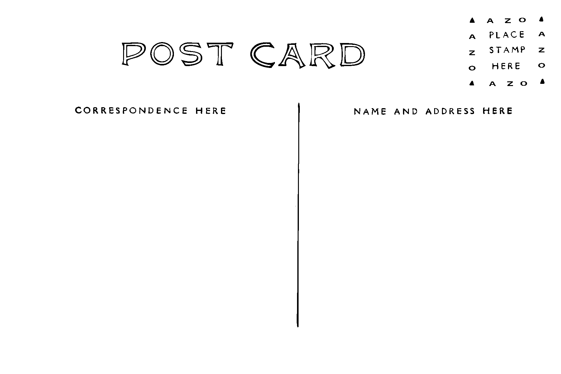

Here's what I used for a 4x6 layout... a clone of the card I'm using as a model:
Kinda rolling the dice on how this will reproduce as a rubber stamp (graphics are kinda small/detailed).

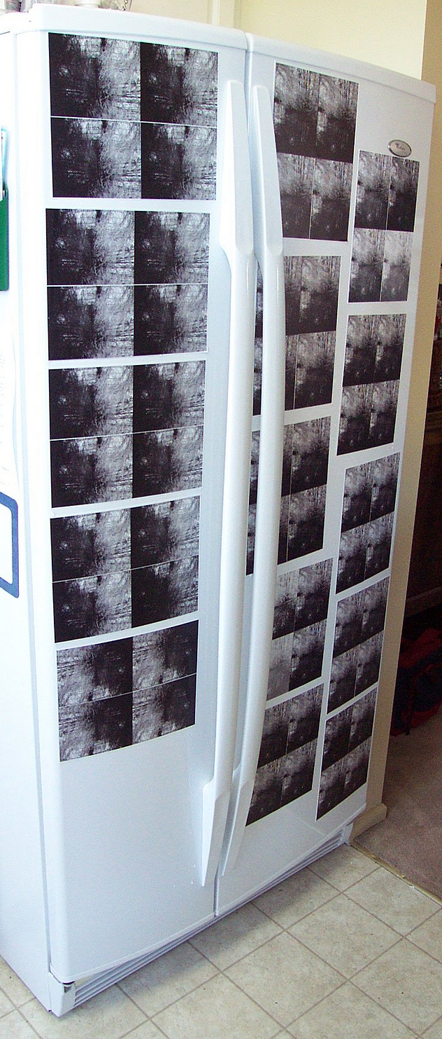

Here is my "drying station" for a Postcard exchange back in ~2013. Each one an enlargement, of course:

I ordered my 4x6 rubber stamp, so we'll see how that works, but I have high hopes. I had to tweak the layout of the graphics, since, of course, the "real photo postcard" wasn't 4x6. I would have liked to have figure out how to just have one stamp that I could use either for 3.5 x 5.5 non-mailed "more authentic" reproductions and also the mailable 4x6, but I just felt it'd be too much of a comprimise, looks wise.

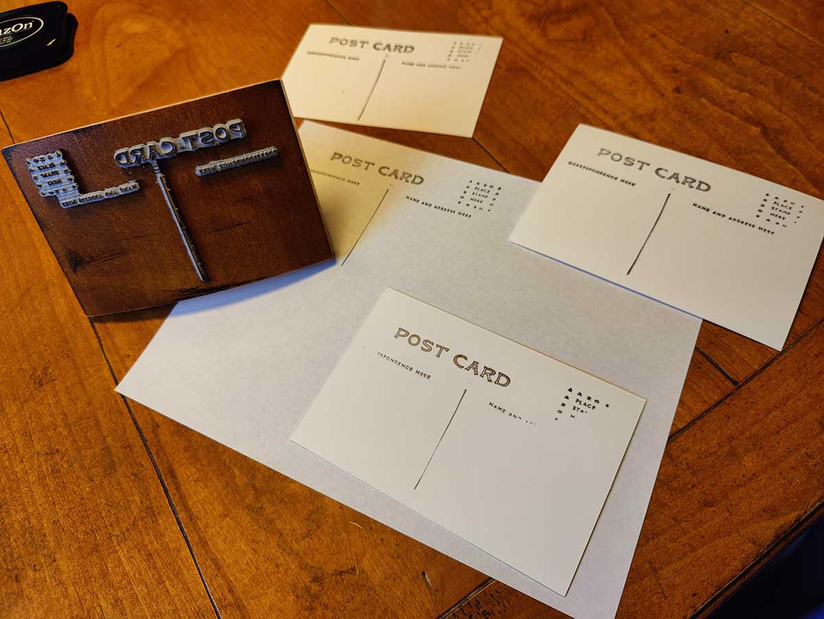

A friend of mine used a small letter press to print the backs of postcards. Something like this, a zinc "die cut" mounted on a wooden block to type height. Worked pretty slick. All the old Kodak cards were 3.5 x5.5 inches (MOL), 8 cards from 11x14.

Well, the rubber stamp idea was a mixed bag. On the positive side, the look and font reproduction all worked well. However, in use the stamp was very unwieldy - really hard to get a consistent imprint due to the size and shape. I'm thinking about breaking up the single stamp into a couple of smaller flat stamps that can be applied separately. Here's the best of my tests:
When using the stamp, try placing the postcard on a somewhat spongy/flexible surface (high density foam etc.). This will make it easier to get good contact between the stamp and the paper.
Your stamp should be mounted on a block - either a flat block or a curved one. In the latter case, you rotate the stamp onto the paper - which has to be on a very hard, flat surface. It's easier to get a consistent result with a curved block.
