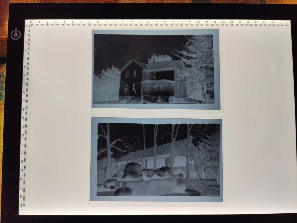

Two steps forward, one step back... went out yesterday and did two shots with the "200 ISO ORTHO", which I thought could be keepers. Did my trick of putting some tape on the bellows top and tugging up when shooting. That tug did get rid of the unexposed arc, so confirmation of what the problem was. Very happy with the exposure, composition was acceptable, though I need to lower my aim just a bit, but... both shots were out of focus? I had a range finder with me, so wasn't a setting issue... the front slide has a little play in it, so I'm guessing that my application of the tape or the tugging pulled the front lens board out of focus. Just a guess. Gonna do a couple more shots this afternoon and pay attention to what that tugging is doing to the front lens board.
Also had a minor scratch and hair on these images... might be a fact of life when having to load the camera in a dark bag. The last test roll of 120 I did with this went so well, I'm rethinking the cut sheet vs roll idea... maybe rolling up some o the Ortho on a 120 reel would be less prone to that. Probably wishful thinking, though a roll would let me do more than a shot at a time. I have to admit it's a little embarrassing to have to retreat to my car between shots and put my hands in that dark bag on my lap and wrangle around in full public view... :smile:
There's also some possibility of suction bowing the film toward the lens as you pull on your piece of tape. But more likely it moved the front or actually caused some camera shake.

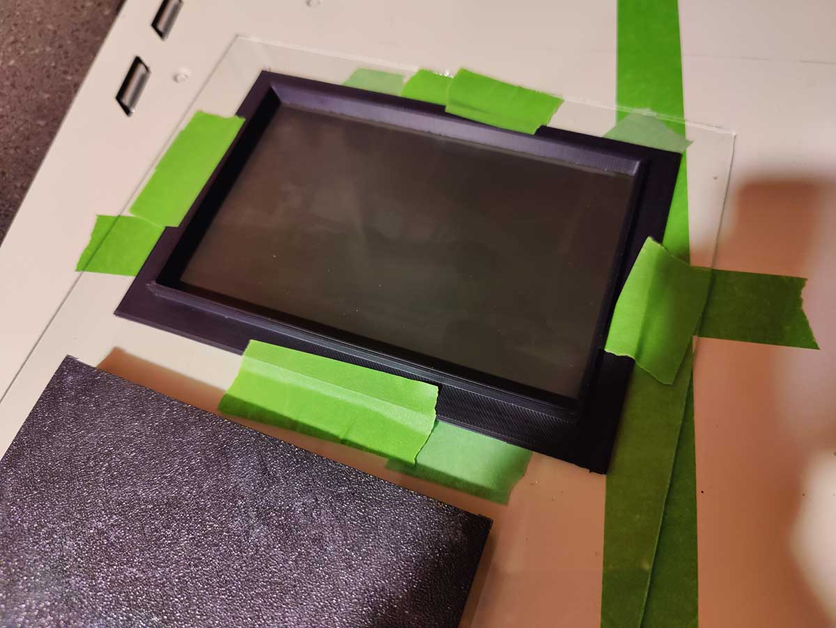

With the above failure/learning under my belt, I tried some more modern paper (only 20 years old :smile: - some warmtone RC Ilford that I had. I built my "sandwich" this way - taped the negative to a clean oversize piece of glass. I 3D printed a plastic "frame" that had a cutout the exact size of the paper and taped that into position against the negative. This way I could simply drop the paper into the frame and it'd be lined up with the negative correctly. To hold it in place, I 3D printed a "backing square" the same size as the paper and that fit inside the frame... then I turned the whole thing over and weight of the glass holds everything together. The overlay with type I taped on top of the glass, so there's the width of the glass between it and the negative, which I thought might soften the text on the print, but I don't think it did.
Here's a couple of pix of all this:

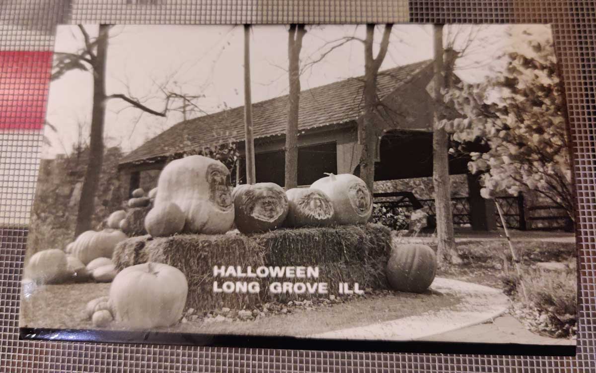

Pretty happy with how this print turned out. It's not a postcard, but I could glue a printed back on it and make it one:
I was a little surprised my negative, which should be as big or bigger than the original roll film... wasn't able to fully cover the print (it was short top and bottom). I sized everything based on those old Kodabromide cards, which were 3.5 x 5 7/16. I was cutting my film sheets 4x6, but that was oversize for what was getting exposed. I'll need to go back and check the size of the old real photo postcards. I don't recall them having a border, but will have to check.
The overlay text is a little too "perfect", compared to the real vintage thing. Mine is a little too thick. I might try moving the overlay under the glass so it's closer to the paper. I'm still pondering creating some sort of ink stamp also. Here's the text from an original vintage card:
