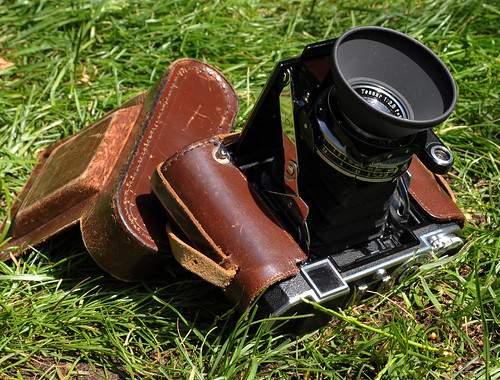

I like my Zeiss Ikon Super Ikonta 532/16 (1938, 6x6 with Tessar 2,8/80)
Superb build Quality, Rangefinder spot-on (without CLA). The leather case is very useful, so try to get one with the original leather case.
My favorite Folder by xipho68, auf Flickr
The postwar IV has a better and coated lens (take that if you want to make Color Fotos), but I like the full metal buld of the old model better
