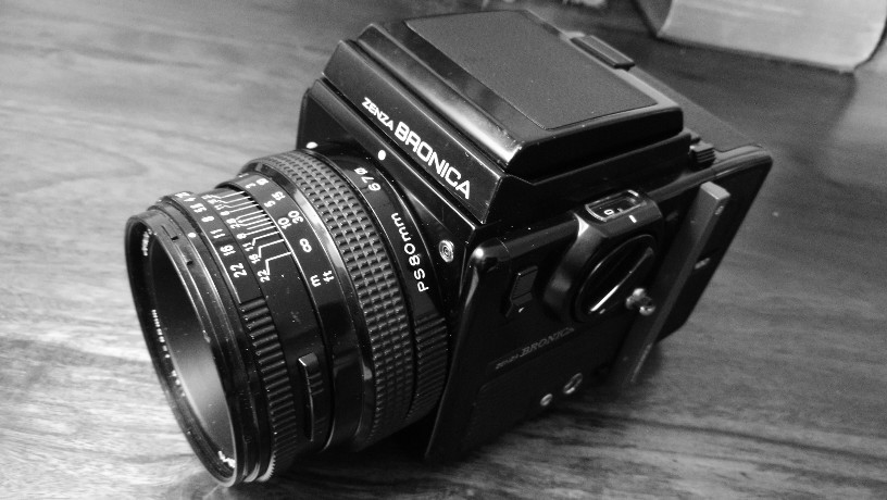

Okay, I need your help already!
I loaded the film correctly, and wound it on to shot number 1 - all appears as it should. I used a Minolta Flash Meter IV, set the film speed, chose my aperture, got a reading of 8. Set that 8 on the camera, set aperture, focussed using the magnifier. Unlocked the shutter button release. Tried to fire button, but it wouldn't fire. Thought about mirror up, so turned that dial to S - and as soon as I did that the camera took a shot! I was surprised. And then I noticed I'd left the dark slide in. So, a total screw up!
Now I've taken the dark slide out, and advanced the film to shot number 2. However, I can't see anything in the viewfinder. I'm thinking this must be because of the mirror up. So, I tried moving that - whichever setting I choose, nothing happens, just a whiteout on the screen.
What to do?

Well, I've managed to fix it - it needed cocking again. In short, I think I've ruined 2 of 12 shots. Let's hope things go a little more smoothly from now on!

It's likely the initial problem would have been the dark slide being in, followed by the mirror being locked-up mid cycle. The mirror lock-up lever has three positions: N - Normal (not locked up), S - Single (locked-up for one shot only - the lever should return to N after one shot) and C - Continuous (mirror stays locked-up until you move the lever back to N [or one more shot if you move it to S]). Once it's locked-up you can't bring it down without firing the shutter (however if you remove the back first, you won't lose a frame).
I never bother with mirror lock-up on my SQ-B, it's too much aggro and I've never noticed any issues without it.

Thanks, John. I'll shoot the rest of the film without it (MLU) unless I really feel I'll need it. Having looked around online, it seems to confuse a lot of people.
I love looking through that viewfinder!

You're not alone in trying to figure out the correct sequence of events, especially if using the MLU. You'll remember the routine quick enough.
I use mine for a lot of night photography with no problem, so these steps will become second nature.
Life is better without the MLU.
Seems needlessly complicated compared with a single switch to trigger MLU.

Yes, but it is what it is.
Eight more shots taken, without any problems. Fingers crossed they turn out. Unable to do spot metering with my Minolta IV, and what it gives me differs from my phone app. It's hard to be precise. We shall see. I'm taking notes for every shot.
