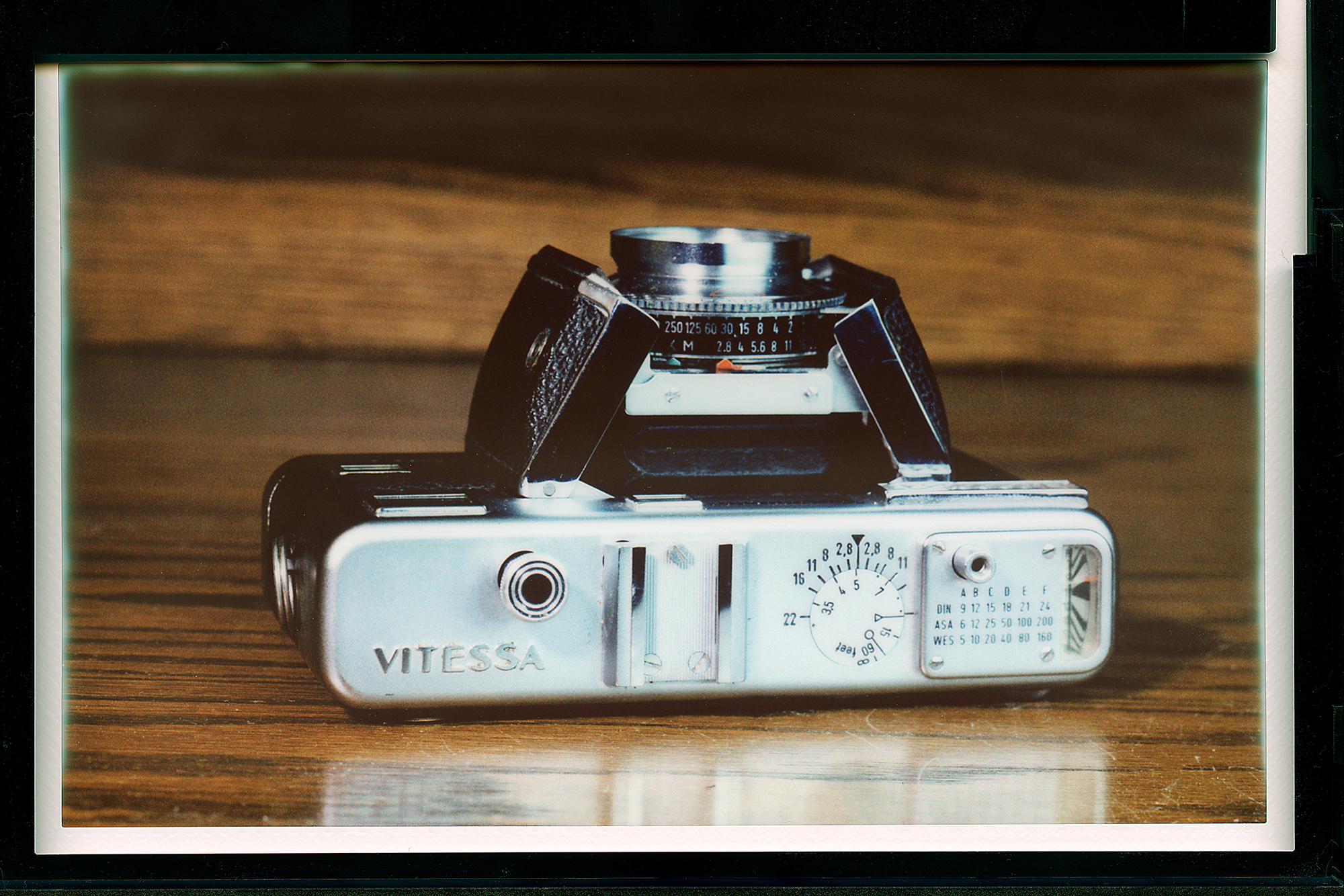

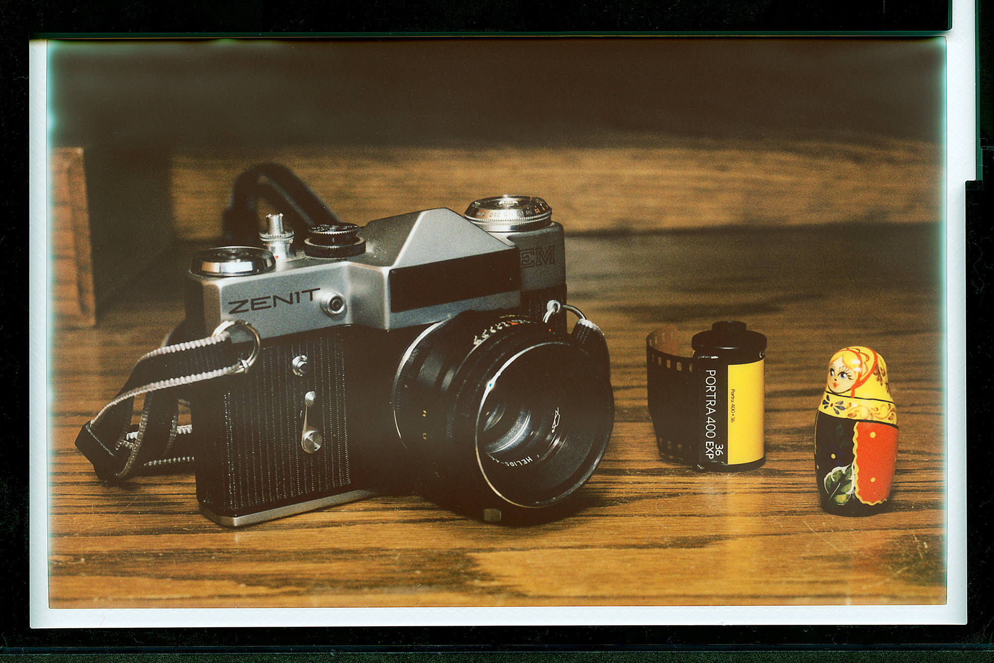

I received a Lomograflok and have been able to do some controlled exposures. I think reciprocity failure begins to kick in very soon with Instax film, even at about 1/8s. For still lifes metered accurately at 1/4s I have to bump up exposure about 1.5 stops! Even then, I detect the image going a bit bluish, as in the first attachment photo of the Vitessa. Since this film is already very contrasty, reciprocity just makes things worse. Using flash, the correct exposure is as metered for ISO 800 and less colour cast, as in the second shot of the Zenit.
