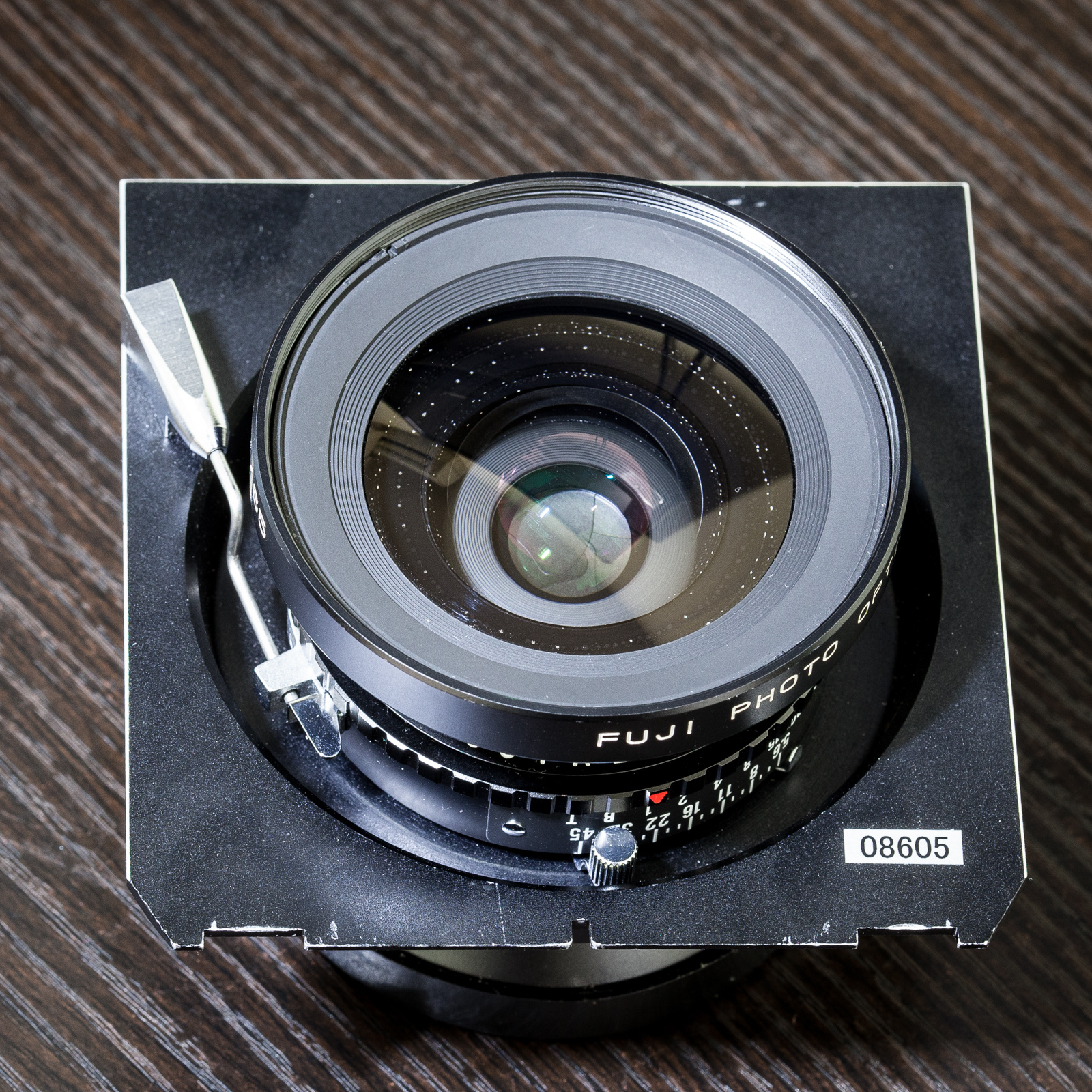

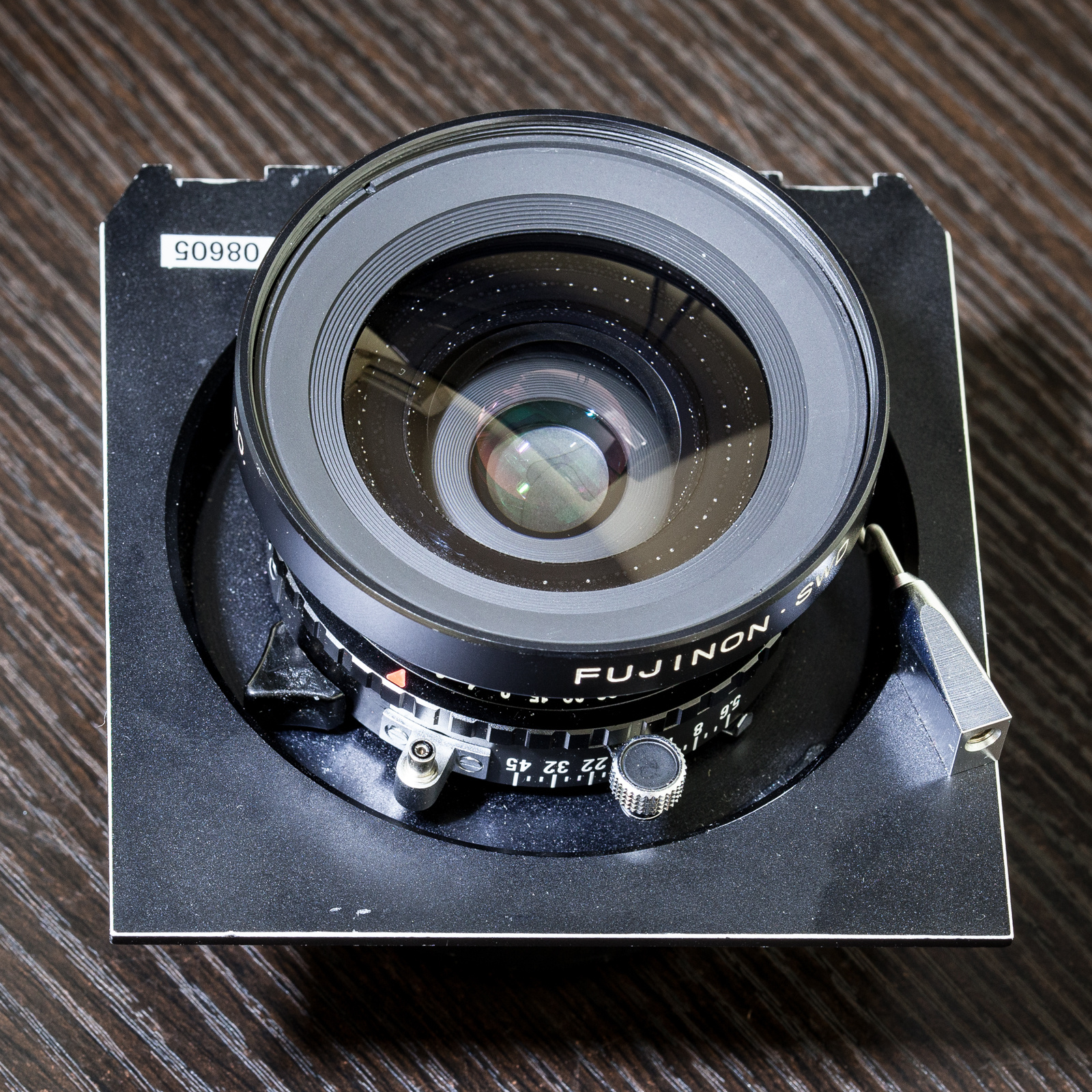

As far as I know, this is a third party lens board, I seem to remember someone quite some time ago mentioned that the number on my board, was a part number for the generic board maker.
This is my Fujinon SWD f/5.6 65mm lens in a recessed board, which is around 10mm deep, possibly 11mm deep, but it is in that depth vicinity. Things are tight, as you can see, this is a 0 shutter hole for reference.
I use my pen or pencil to move the aperture, otherwise I would be stuffed.

The board in the photos (above) is very similar to mine. If you look carefully, you can see that the hole for the lens is off-set (dropped) slightly -- to allow for access to the lens controls.
You'll also notice that it has a cable release connection -- AND a piece of wire to actually push the shutter release. Mine was missing that extra wire, so I took a thick paper clip and bent it/cut it to the required size and shape.

Check the pictures of the Fujinon lens (above), and you'll see it is offset -- so that there is room to access the preview lever, PC contact, etc. If the recess is too deep, you can't reach these -- and maintain your sanity.
