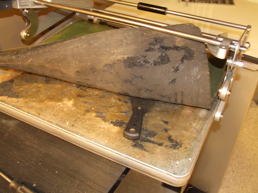

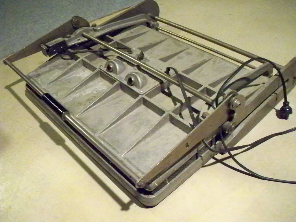

Photobucket won't show the pictures in this thread anymore.
I have copies, here is the "Before" picture.
