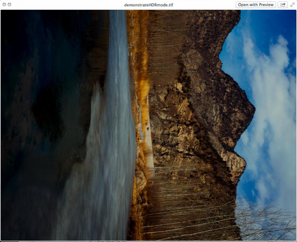

OK, I just tried all this again and... I was wrong! I did a 48 bit HDR scan, of a positive. Preview had no problem with it. art2best, pschwart, you were right. Just been a while since I've done slide... :-(
Here is the slide, freshly scanned, being previewed:
It is a little darker than the actual slide, but not DARK dark...

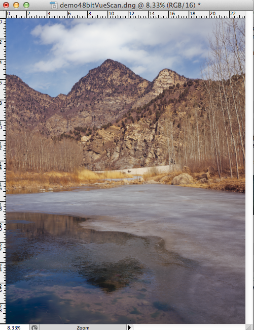

I got the same result with VueScan, although the result is not as dark as the above - looks more like the slide on the scanner. VueScan is always more predictable for me.
chuck94022
Jan 11, 2005
869
Los Altos, C
Screen Shot 2012-12-10 at 12.01.05 AM.png This is the one from VueScan, after the DNG passed through ACR into PhotoShop. As you can see, brighter, more like the slide itself.
