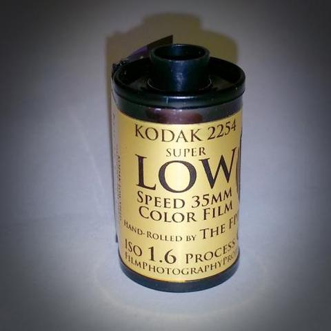

For when ISO 3 is just too fast:
1.6? Sheer luxury. When I was young, we used to dream of shooting ISO 1.6! (Apologies to Monty Python)
How about .8:
Dead Link Removed
Dead Link Removed
(Add to that they develop direct to positive, though I’ve never tried either...)
How about .8:
Dead Link Removed
Dead Link Removed
I saw the direct positive version and was sorely tempted. But I haven't bought it (yet) because I don't have a use case for transparencies.

yeah, I'd love to try just to try--it may look awful, but its interesting. Sunny 16 says it should be exposed for 1.25 seconds (1/.8) at ƒ16, or just a tiny bit faster than 1/50 at ƒ2, so it could be handheld with a fast lens on a bright day.
How about .8:
We would've loved to have .8 when I was a lad. When I mentioned 1.6, that was our ultra high speed film. What we normally used was a dry leaf coated with blackberry juice.
