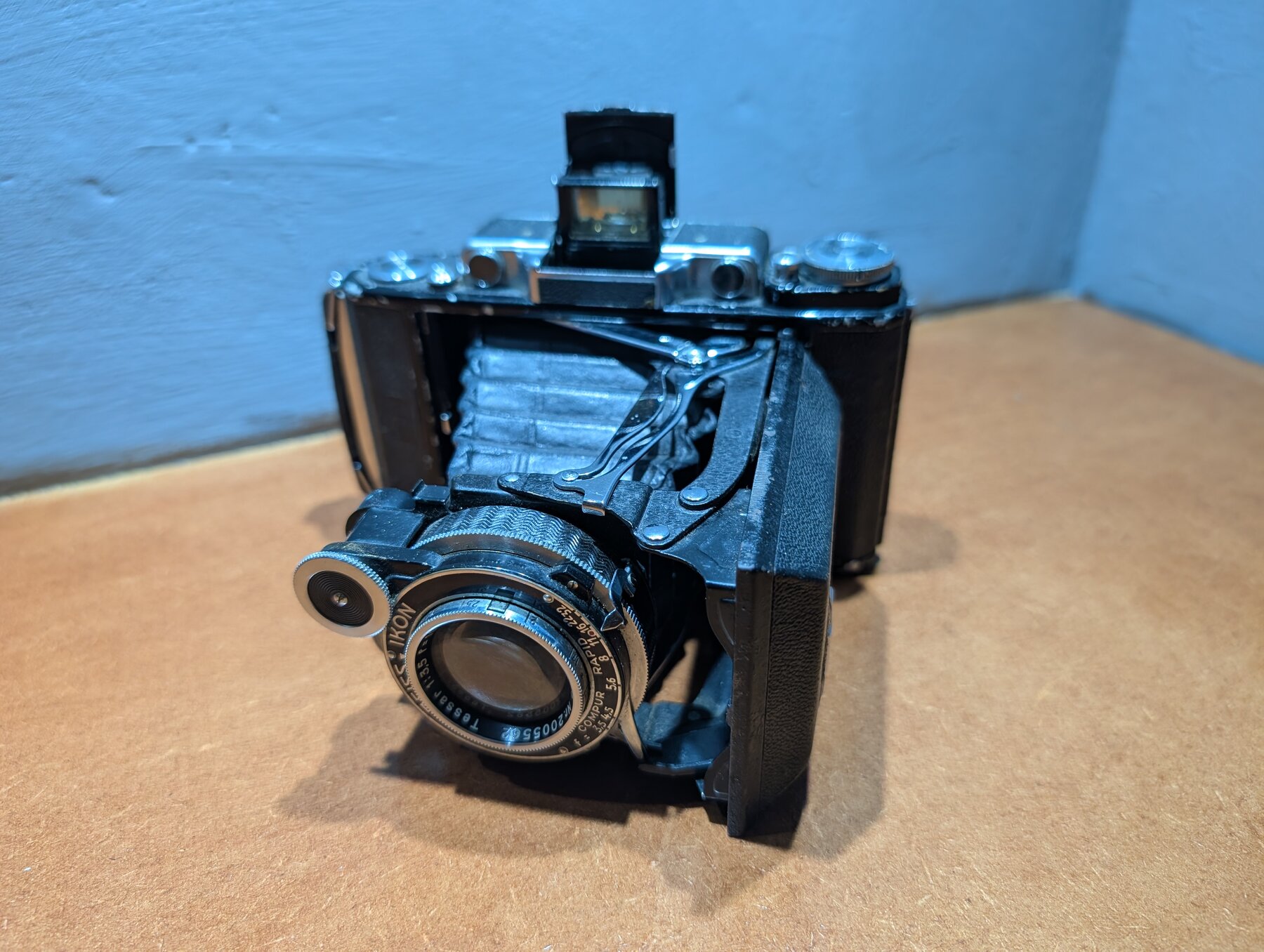

I bought a Zeiss Super Ikonta 531/2 from a bric-a-brac stall at the weekend. I was looking at it for 20 minutes till it came on to rain and the family wanted to get a coffee and pushed me over the line to spend £50 on it. (That's 67.02 of your US dollars).
It's not in "bad" condition but not "good" either.

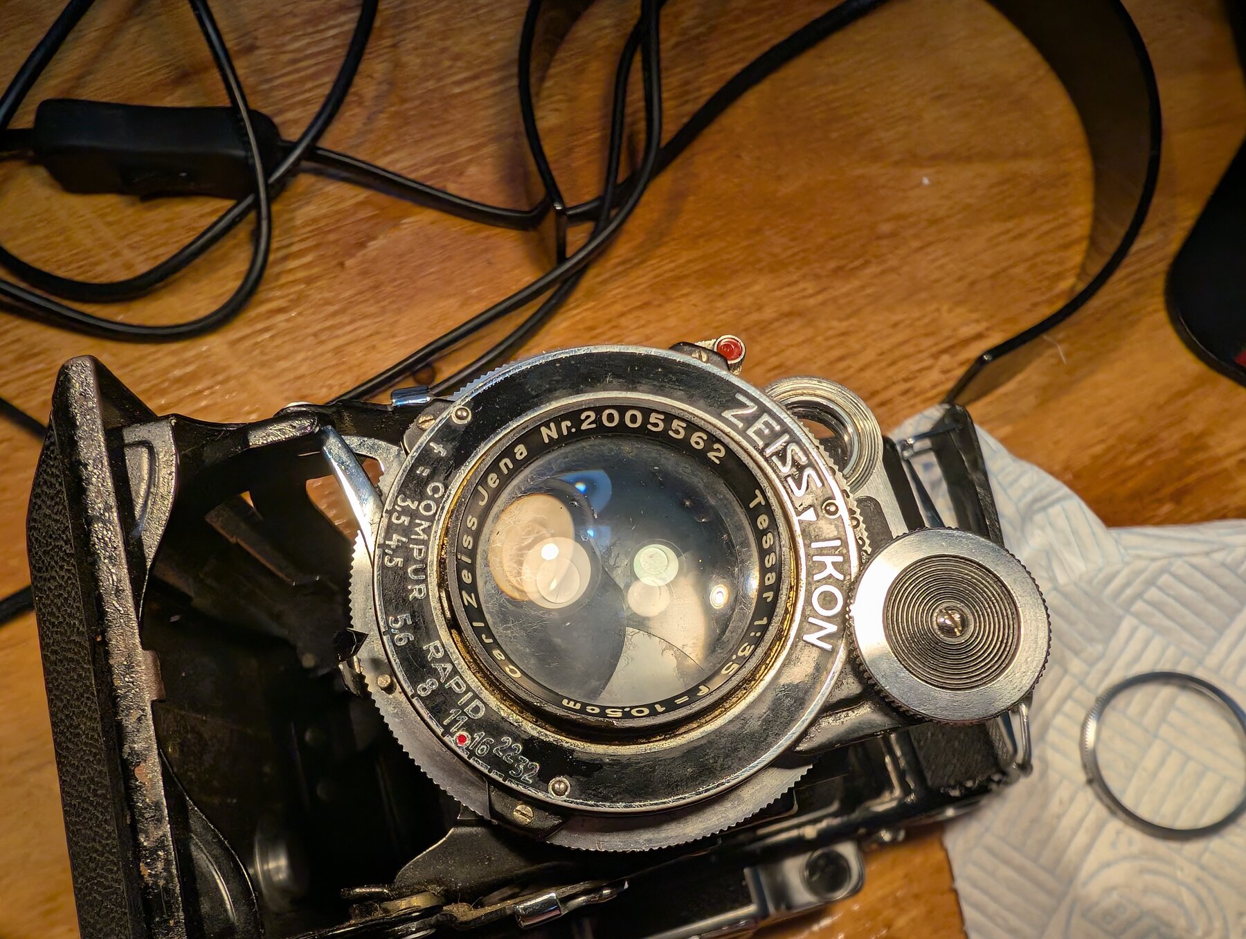

The lens had a little fungus and haze but I've cleaned that up with some hydrogen peroxide gel. (I feel safe doing this on non-coated lenses). Shutter is fine but sticks on B even after flushing with lighter fluid. I can live with that.

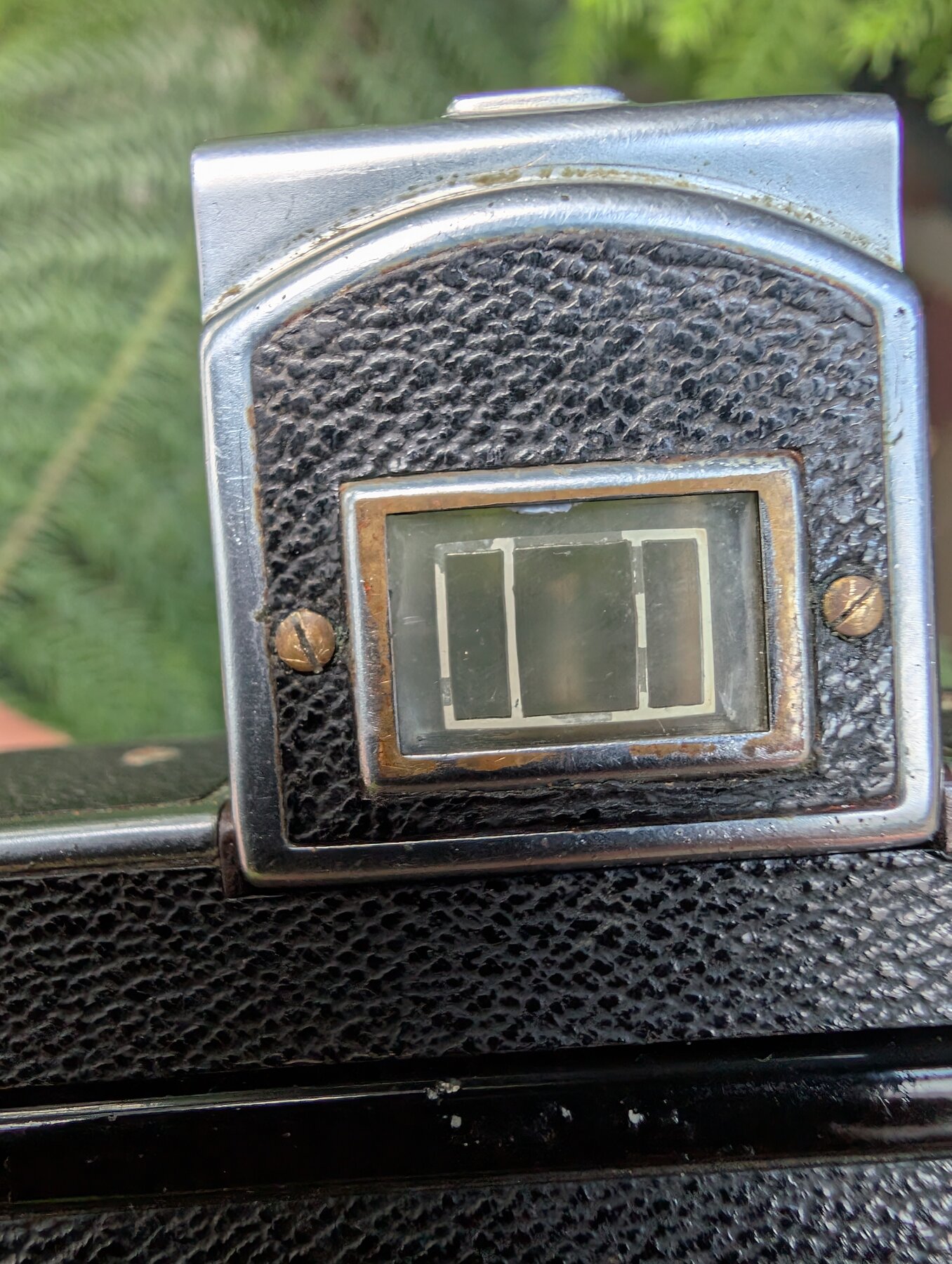

The main issue is with the viewfinder. The original is a bright line finder with half silvered mirror at the front and white lines at the back that are reflected in it - apparently appearing at infinity. Alas the half silvering was very distressed and cement in the front element had discoloured. The 90 year old plastic the white lines were printed on has aged to the point it is no longer transparent - more translucent! Basically it was a viewfinder in name only.

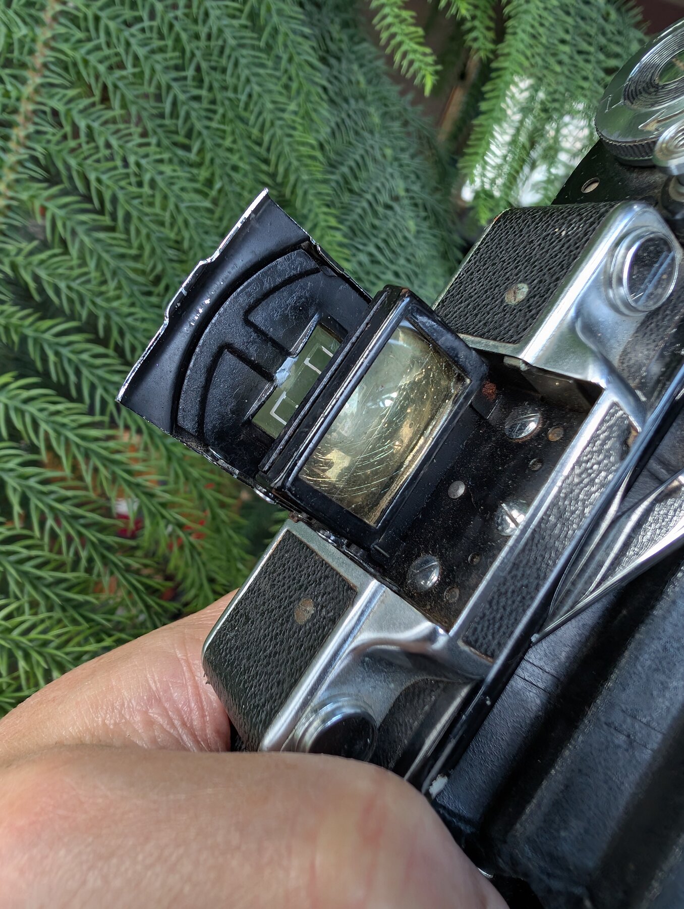

I've de-silvered the mirror with permanganate and removed the balsam between the elements along with the plastic frame. The viewfinder is now totally clear but I've added some black tape to approximate the frame.

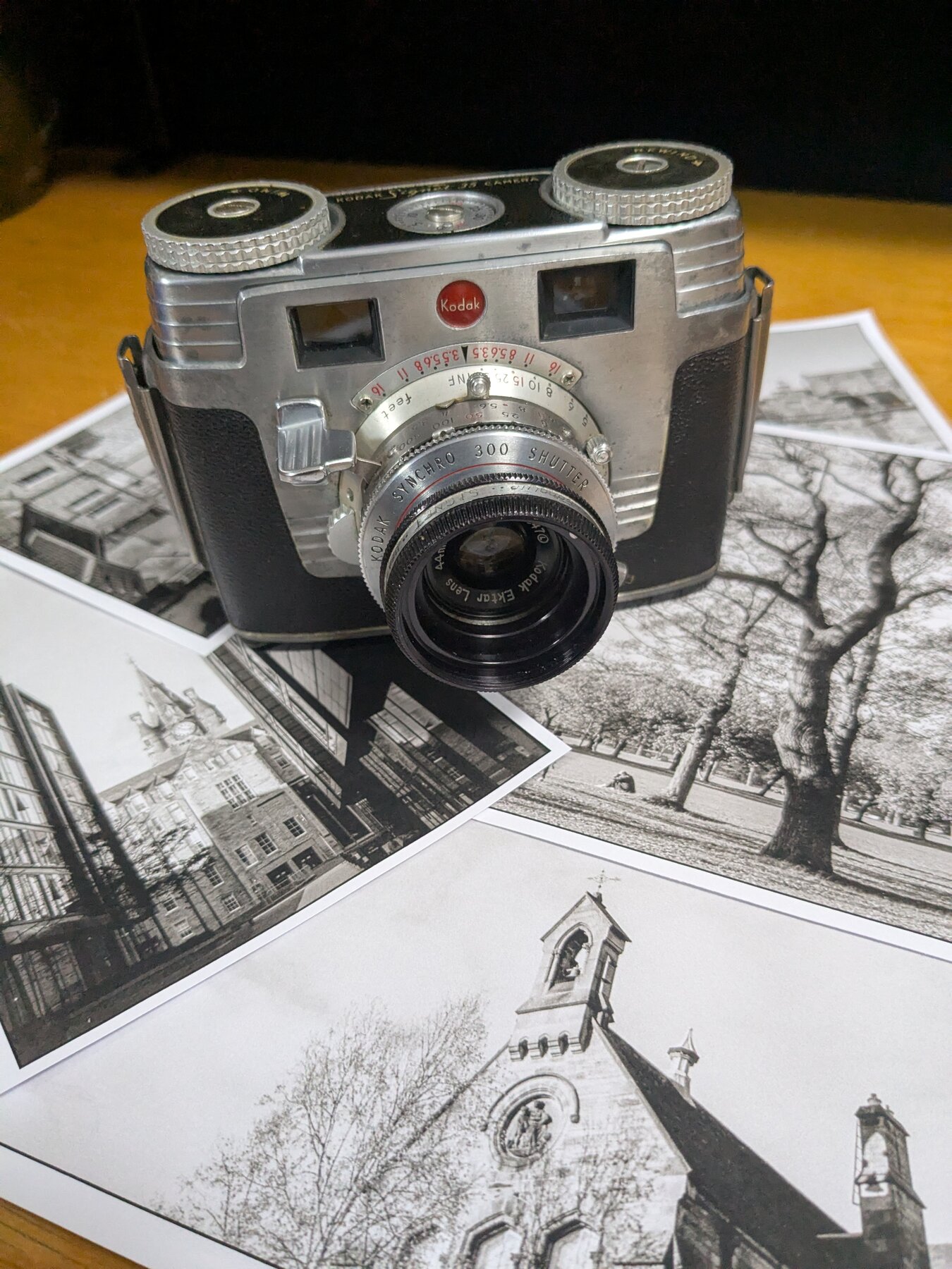

I also have a Kodak Signet 35 that is working perfectly except the half silvered mirror in the range finder had degraded.

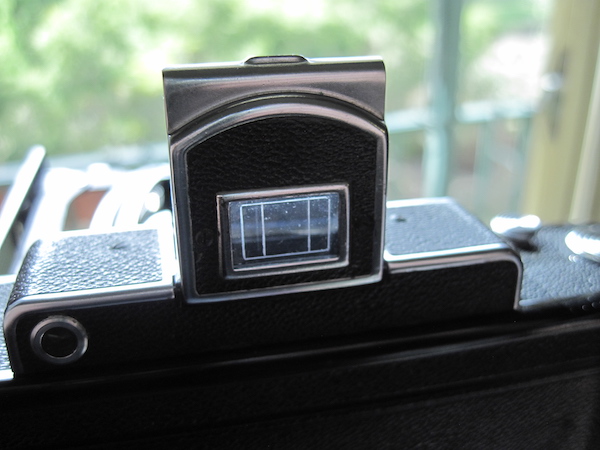

I simply bought a parts camera which happened to have a good viewfinder and just swapped it over. The plastic with frame lines wasn't so good though, so I looked around the house and found a piece of thin clear plastic and then drew lines on it, using a ruler as a straight edge, with a white oil based Sharpie pen with 0.5mm tip.
To explain the method I used to draw the lines so they were even and without runs or any blobs of paint, I drew the lines 4" long, intersecting to achieve the required spacing and shape of the original bright lines. When the paint was nearly dry, I carefully cut out the piece with the intersecting lines to the right size, and cleaned up the ends of the lines that were not needed, with a tooth pick soaked in turpentine. Done carefully, this method works well but may take a few practice attempts. I made one for my 531/2, and one for my 530/15 ... nice and clear now. The plastic sheet if I remember was food grade packing, without scuff marks or scratches, it's very transparent.
