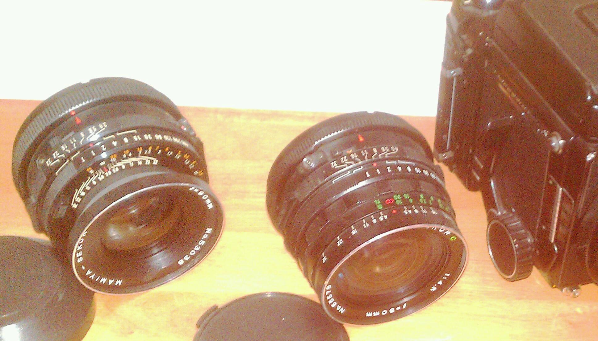

Right - soft focus. Great for portraiture, but not general purpose photography. Fortunately lenses for the RB67 are not expensive. I would choose C lenses rather than non-C because (1) C lenses are newer and (2) they have better coating.
Here is a photo of a non-C and a C lens side-by-side:
(notice that the "focus ring" on the C lens is not a focus ring, but for depth of field)

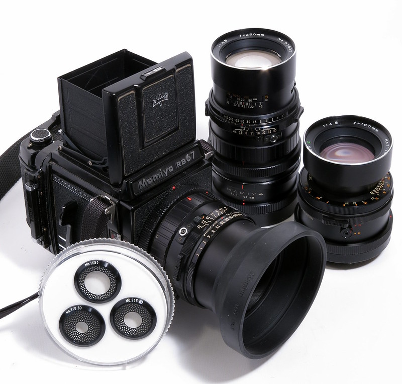

How do those disks attach. They sure are small. Do they go on the rear?
The front half of the 150 lens unscrews from the back half. A disk attaches to the rear of the front half.
The soft focus effect is visible at f/4 and f/5.6.
From f/8 through f/32, there is no visible effect.
Disk #1 had the least soft focus effect.
Disk #3 has the most soft focus effect.

So with no disks inserted, it's a basic 150mm lens even at f/4 and f/5.6 then, right?
