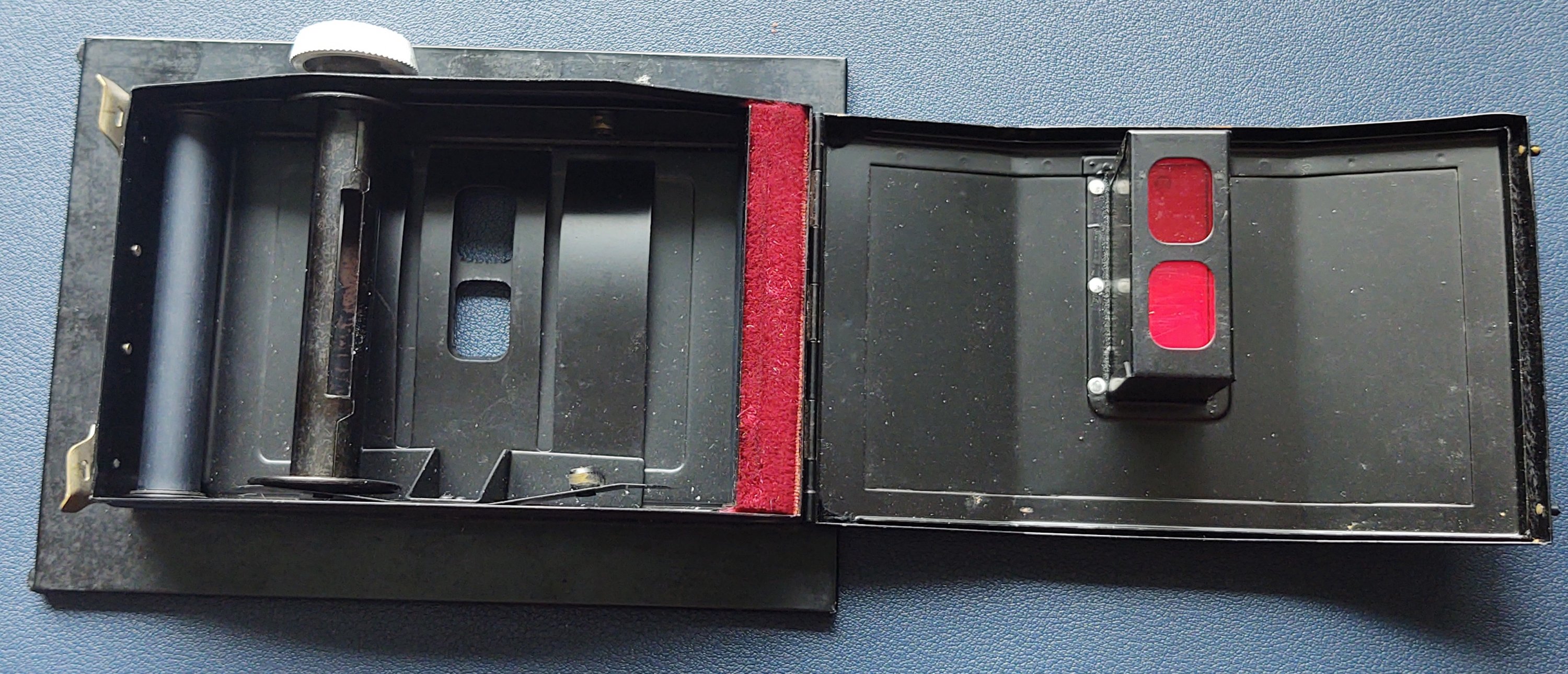

Hello! I bought this Rada roll film holder hoping it would fit my Voigtlander. Unfortunately it does not. Any ideas what it does fit??

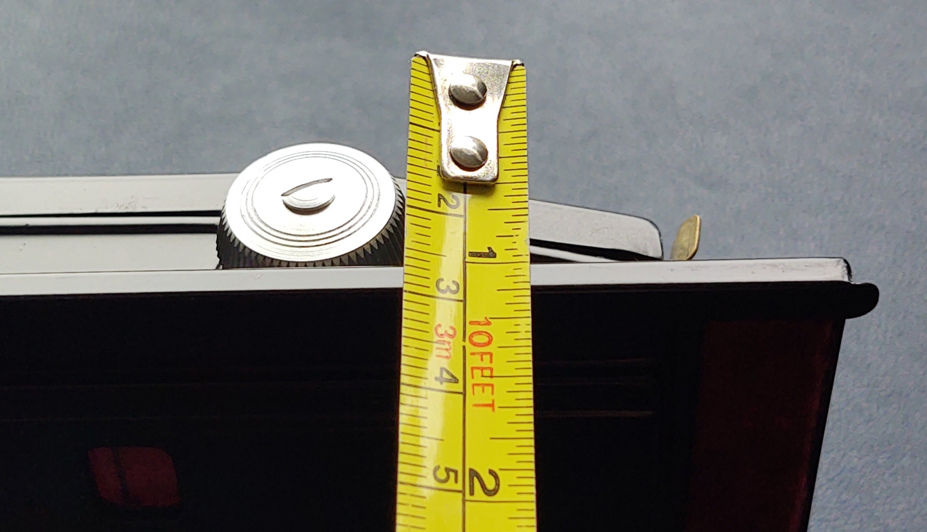

What are the dimensions? There's a rumor that Rada made a holder for my red-headed-step-child ICA "Tudor" Reflex, which is a German made, quarter plate, reflex camera. If it's 3.65" on the short axis, I'd love to see a picture of the back. The Reflex back even has cutouts where the tabs might fit.
ICA lists the plate size as "8.3 x 10.8 cm", which is very close to 3.25 x 4.25.

Off hand it seems to be a specimen of the socalled 'millionfalz'-type (german) - basically just a flat-boxlike fit. In this case it will in fact fit certain old-stype Voigtlander Bergheil cameras. Thas is if it's a 9x12cm fit.
edit: The tabs dont really mean anything, they are just short guides for the cover.
edit 2.: after having seen the pix below I can confirm the above.
I think this is right. The way it is designed it actually looks like it would fit an old wooden plate camera. Similar to the wood double holders. Maybe an early Bergheil used the same design. Certainly looks like the single film holder mentioned in the Rada catalogue and labeled millionfalz'-type.

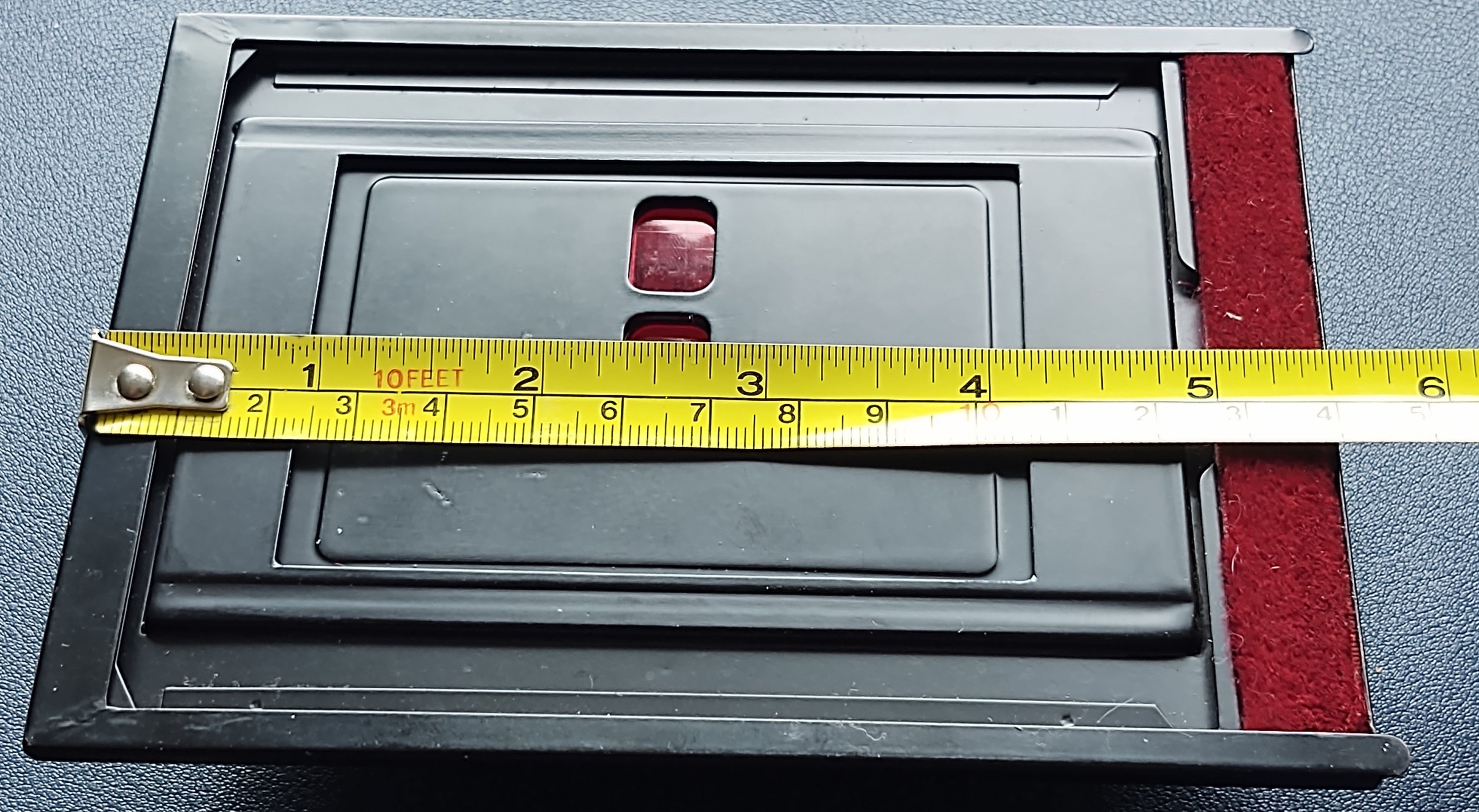

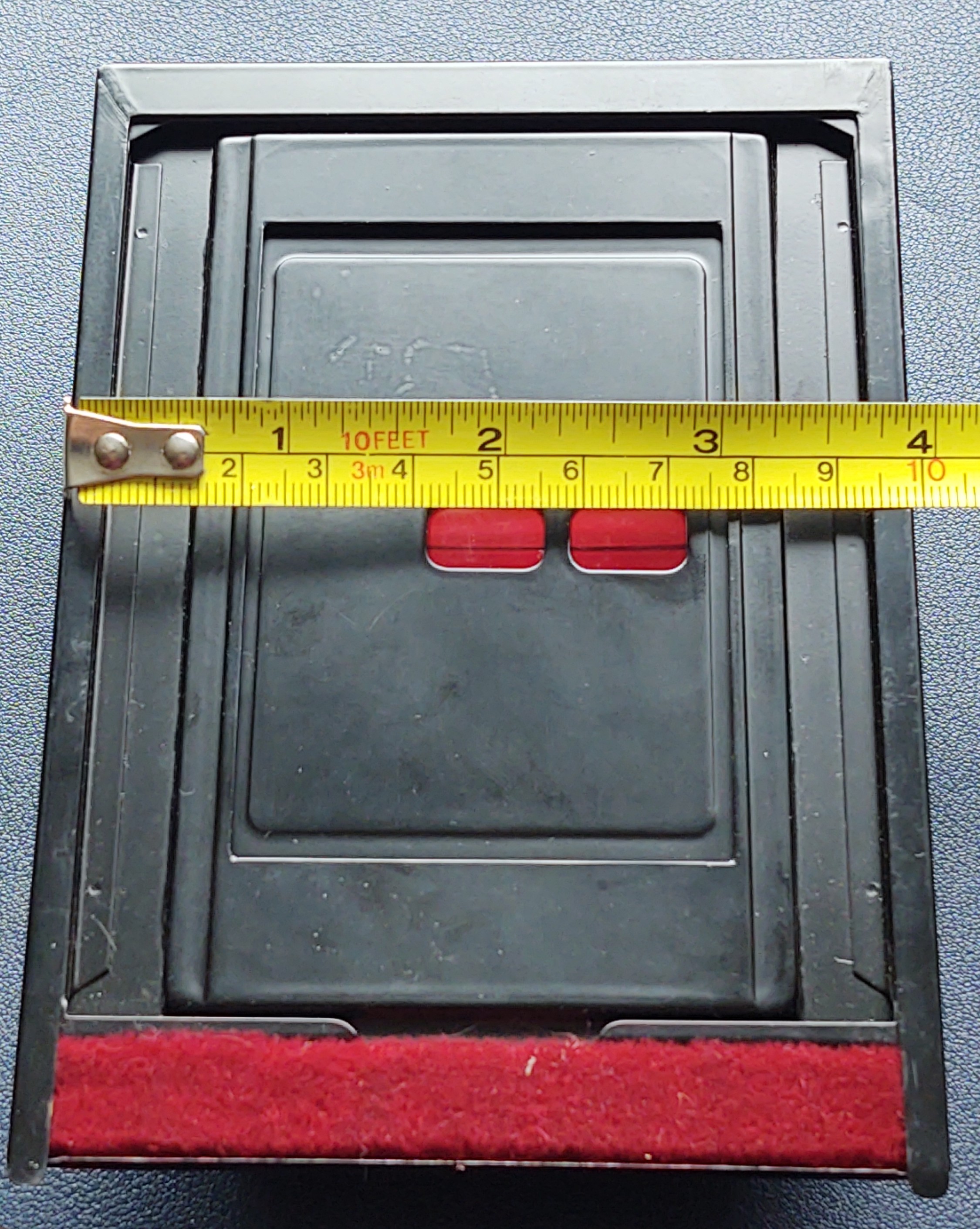

I believe it's for a 9X12cm plate camera. What size is your Voigtlander? If it's 9X12cm it sure should fit. If not, where is the problem as to "not fitting"? Whoops! I see by you measuring that it's for something large, like a 10X15cm camera or something.

9x12 for sure.
I think it is for Ika icar 180., Probably for some more

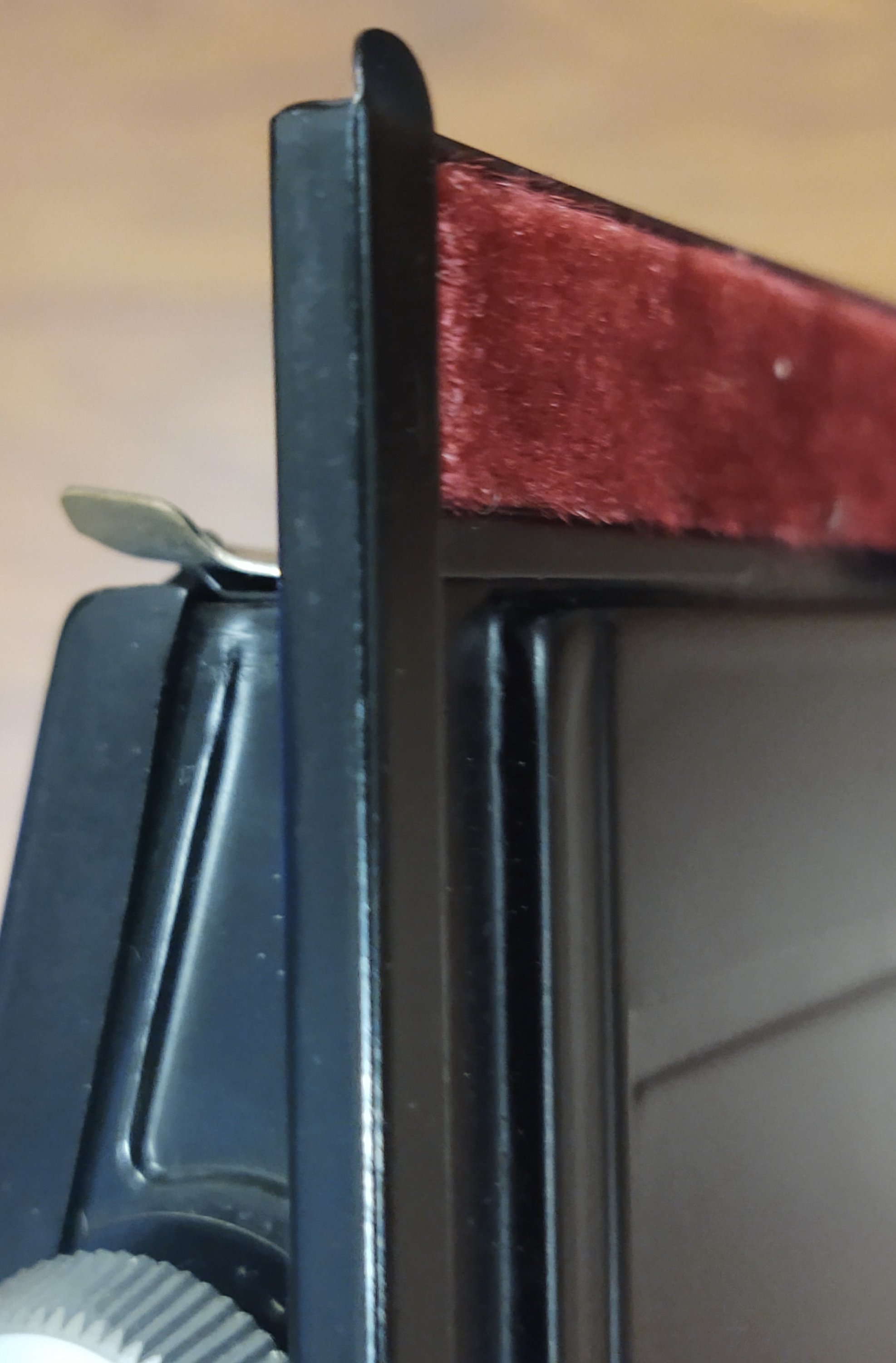

Actually i can not see lips .
Finaly It could be perfect if it was like that below:smile:

The type shown here is the so-called NormalFalz (in german), that fits most 9x12 plate cameras. It might even fit your Ideal, if you make a small dent on each side near the top for the lock-down (but I think you wrote about that in another thread?). (And I believe the redoutable Jason Schneider of Modern Photography mentioned this abt. fifty years ago?)
By the way, the Ideal is a wonderful camera of high quality, being the 'upper middle class' of prewar plate cameras. But believe me - the roll fill holders for this particular model are a potential nightmare. Firstly, they are hard to find. Then there's problems with the light-trap: the metal construction is too thin and may easily lose its proper shape, and thus leak light; and perhaps worse - its absolutely impossible to take apart to change the light trapping. So be ware.

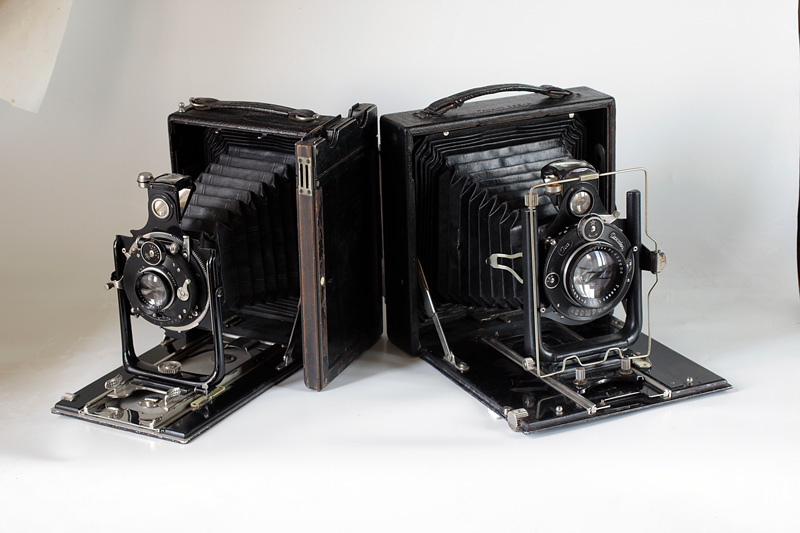

Nice 10x15 Favorit camera, must be quite rare, never saw it in that size. Reminds me I have an old Juwel (i.e. pre Universal-Juwel) 9x12 that needs repair; i'ill have to do something about it.
Andy38
Aug 16, 2008
242
Lyon , Franc
Hello;
Here are 2 cameras using the Ica 10x15 double side plate holder, a Favorit and a much rarer (Ica) Reicka on the left.
I don't know if it's possible to use a normal single side holder with them.
