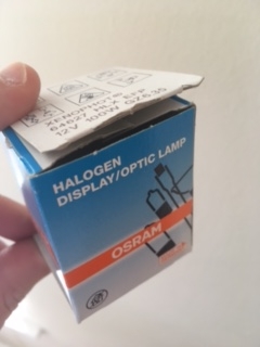

I've got a durst m605, colour head, which has worked fine for a few years, producing good colour and black and white prints.
I recently started colour printing again, on cut sheet Fuji in fresh Kodak chemicals at 35 degrees. However, the prints had a red cast even on max red filtration. I've just cut down some new Kodak endura, and these prints too are red even on max magenta and yellow filtration.
I've changed the bulb but it's just the same.
I've also noticed that contrast is now lacking in black and white prints, suggesting a weaker than usual red filter.
To my mind, either the brand of bulb is wrong, or the magenta filter in the enlarger has burnt out / dulled over the years.
I've attached a picture of the bulb I'm using.
If anyone has any thoughts on what might be the cause, I'd be very grateful for your views, before I chuck my enlarger on the skip.

I don't do colour printing but you do mention lack of contrast with black and white. My enlarger uses the bulb in your picture. If your enlarger uses dichroic filters then these don't burn out or fade. Worth having a look inside the head to see what is going on. Perhaps the mechanism is not properly moving for the magenta filter or maybe it is very dirty in there. If your exposures are longer than usual as well as lacking contrast then maybe there is an electrical problem. If you decide that your enlarger is beyond repair I'd recommend enlargers made by Kaiser (German). These are available second hand or new, very well made, easy to use and parts are readily available (and still made).

Ok - there are many variations of Bulbs, it looks like the right one but I would check this aspect as it may indeed be the wrong one... I doubt the dichroic is the problem but it may be slipping and you can open the head a bit and make
sure the filter is reacting like the Yellow and the Cyan.
If it is sticking you will not get full magenta, but you should be able to see on a white sheet the colour getting more Magenta as you dial it in.
I use OSRAM ELH 300W - 120 V for my Devere Dichroic enlarger...

I've just changed the bulb but they were both the same brand, so I supppse that could be it.
