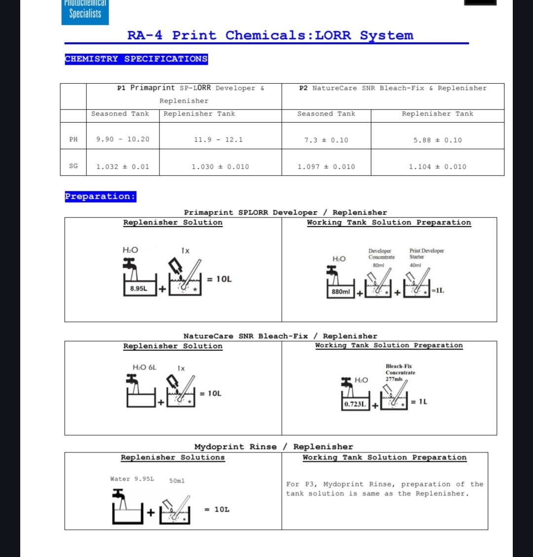

Switching chemicals and decided on the champion bulk chemicals for my RA4 printing. I want to make a 1L working solution for 8x10 prints using 60ml each. The data on these chemicals is super confusing and dont really explain it?
What's the ratio of starter + replinsher + water = 1L
Ive been using kodak stuff and I did 75ml replenisher + 25ml starter + 900ml = 1L can I just use that or are they all different ratios depending on brand ?

This is different.
880mL water, 80mL of the concentrate (the 1 liter bottle of what they sell, not the diluted replenisher), and finally 40mL of starter.
Looks straightforward, please report how this works out.

It's a little ambiguous because the image showing one how to make the Replenisher doesn't label the concentrate bottle but the other one does
But I think you're correct, I just misinterpreted the images
As a home user, this is all you need. You won't need to do a replenisher.
