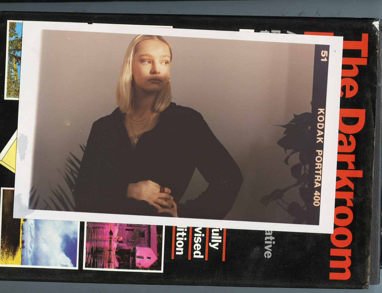

I started this discussion here but things have progressed so I thought it would it clearer to start a new post about the actual issue.
I'm not getting close to the results I am seeking and I've done a good amount of testing and it's driving me a bit crazy.
I've started (at least) to get consistent results and have my system pretty well set, but the issue are my blacks not being dark enough no matter what I do.

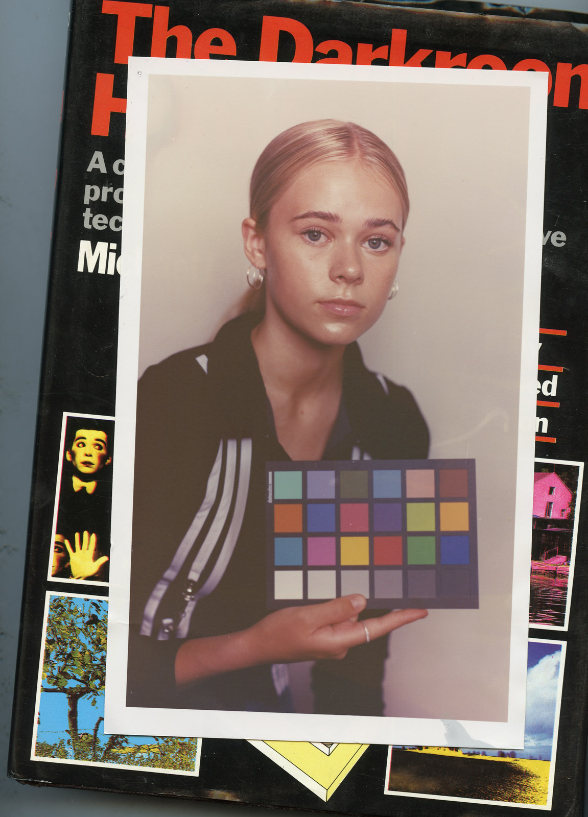

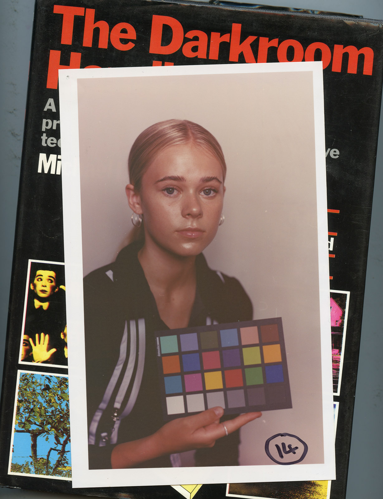

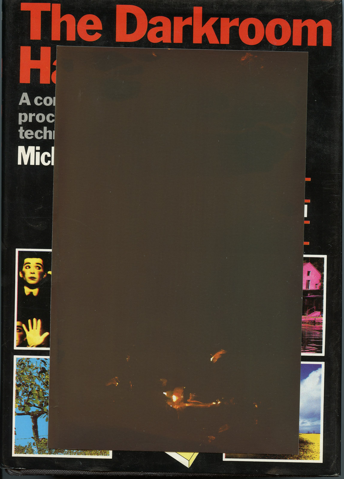

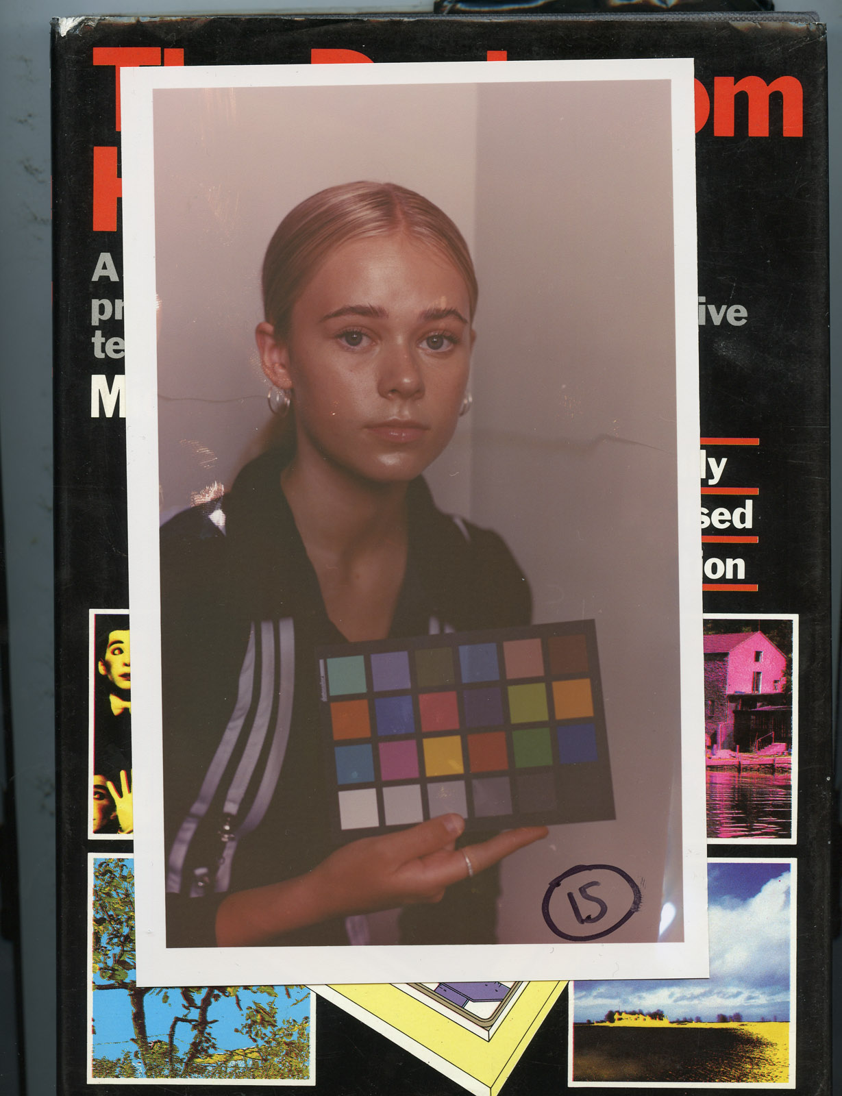

I've attached 2 images, one with a test portrait I did with a colour card and one that is just testing enlarger exposure without any negative in the holder (at 10, 20, 30 and 40 seconds at f5.6). As there's no clear difference in the steps, I assume 10seconds is already max exposure.
I thought the issue with the portrait was underdevelopment, but I doubled the dev time and the blacks were no darker. The only difference was a bit of colour shifting and the paper going a bit browny orange, which may have been to the blix which I also doubled the time on.
*The images I've attached I put on top of my darkroom book which has a jet black cover, for reference.
*I've tried using another image but same results. Is there any way this could be due to slightly underdeveloped negatives due to developer not being hot enough?
*My Kodak Ektacolor BLIX part A has condensed in the bottle at the bottom. I have to filter out bits with coffee filter. Could this impact the blacks?
*These are the only chemicals I've used and will be trying new ones soon (but not soon enough).
I did a 2-day course a couple of years back to learn the basics but flying blind since I started my own home printing recently and I'm hitting a wall so any advice would be appreciated.
1. Blacks test. As explained above
2. 8 sec exposure
3. 10 sec exposure
4. 12sec and 14sec exposure

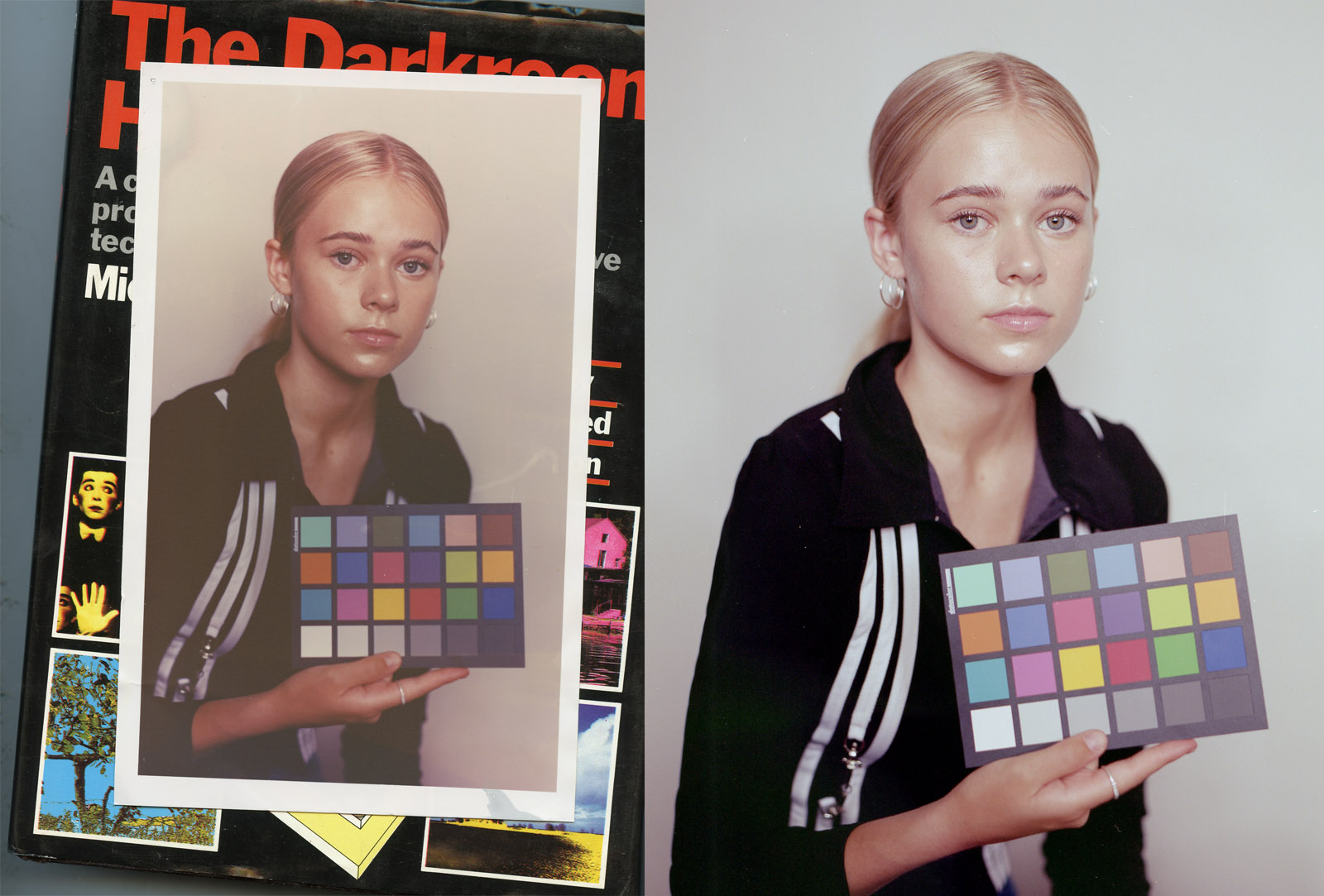

5. On the right is a scan of the negative with auto settings to test - blacks darker but a brighter image. I don't want to be scanning or using hybrid workflow, I just wanted to give an example.

Also, the final image is side-by-side with a negative scan if that wasn't clear (I've gone back and edited for clarity).

The negative scans seem to indicate low contrast.
