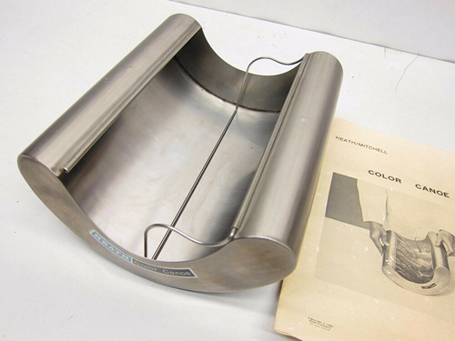

A couple of Heath/Mitchell Color Canoes would probably be the best solution for those who want to tray develop:
I prefer having at least 4 tubes that I can cycle through and allow to air dry between uses.

Was the original idea of the different versions of the "color canoe" concept was to float the thing in a tub of tempered water? ? I have a Honeywell Nikor version I bought in the 70's. Darn thing is beautiful, but I could never figure out what made it "color" especially with the old processes. I had a Premier stainless steel drum, with rubber end caps. It had a light trap in one end, floated in a big yellow plastic tub of water. I just kept it log rolling worked great.
Photo Engineer
Apr 19, 2005
29,018
Rochester, NY
The inventor brought it to Kodak in hopes of selling the idea to EK. That was before my time there, so it was intended to be for the P122 or Ektaprint C process. The KRL workers found it clumsy and difficult to use and did not go for it. During a cleanup in the late '60s, one with a Kodak label was about to go in the dumpster, and I asked for it and was given it and I have had it ever since. I assume it is a one of a kind and some sort of collectors item.
It is under the sink in my DR IIRC.
PE
Jackpot! Should go to a museum. P-122 had been replaced by CP-5 when I got involved. I did get to use Ektacolor Professional paper, fiber base. I still have a few prints that, last I looked, were in nice shape. I was a babe in the woods. No one to help me, 13-14 years old. I remember that Kodacolor negatives were easier for me to print than Ektacolor-S. I don't think my Acetate filters were big enough to fit my filter drawer, so I was all over the map. The Kodacolor-X negatives printed so easy.
