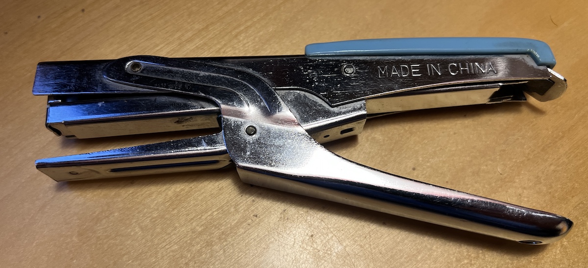

In Movie film processing labs more than 40 years ago, I learned this trick.
Just staple it.
This kind of stapler has very handy shape to connect 2 rolls of 120 film and uses a bit smaller staples than regular, 10mm wide.
Usually I leave paper tape on the film, with clipped corners, to go first then I staple back part to back part.
You will feel a bit more resistance while moving film with usual Paterson twist until stapled film pass the balls in channels, at beginning.
Don't force anything, just gentle moves.
Twist reel normally until whole film is in. Never had any issues.

Stapling is genius!

Hi Yola, interesting! I never noticed that. So far I used Kodak, Fuji, Ilford, Foma and ORWO 120 films. I did not close examine recently kind of tape they used to secure film to the paper tape, but when I looked at it long time ago, it was not kind of same tape as "post stamp" - activated by the moisture. If you leave tape on the top of the first film and staple 2nd, you then can cut out remains of 2nd tape on the film.
