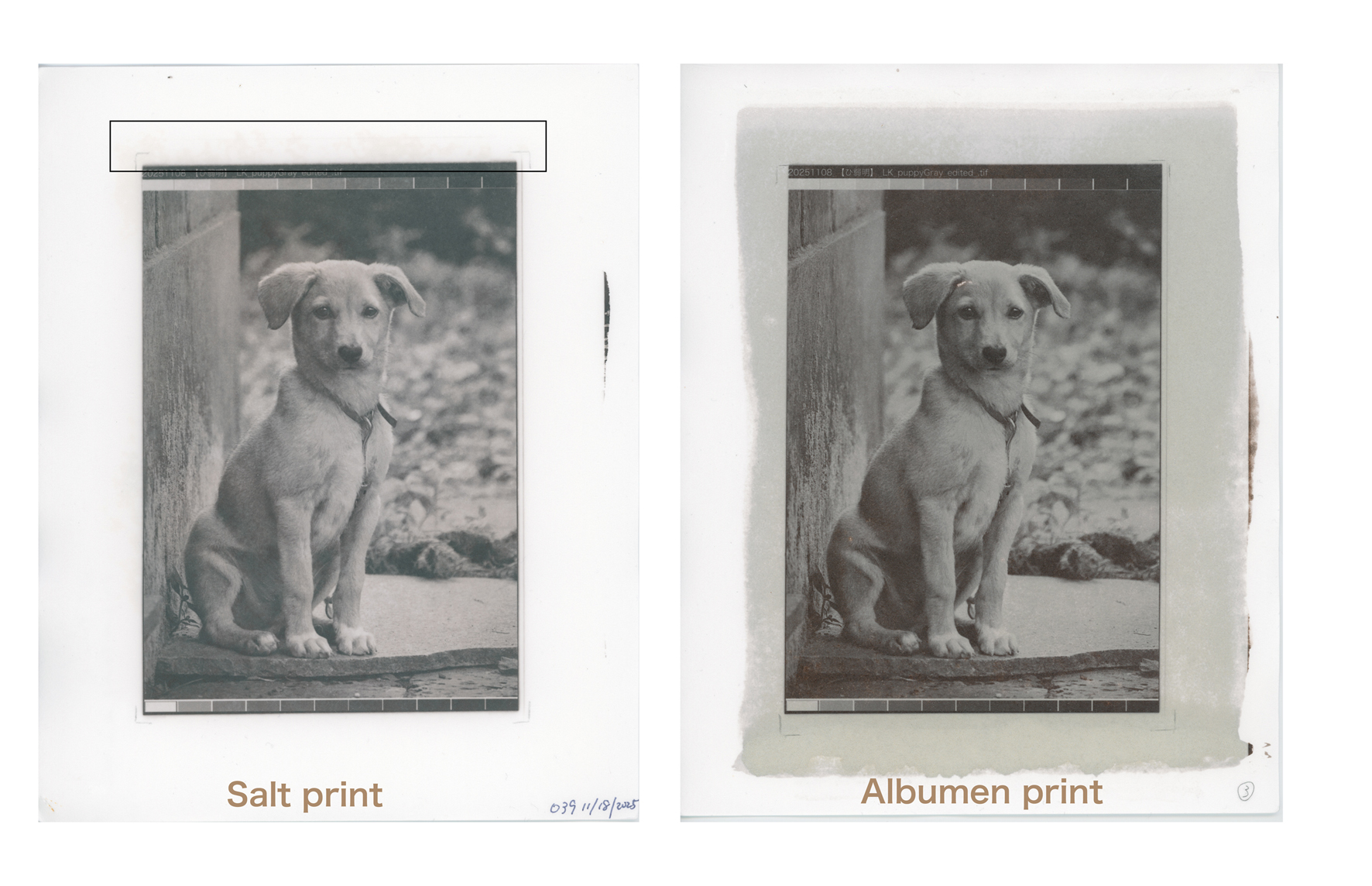

I’d like advice on two issues with my recent salt and albumen prints.
1 — Fogging(pls. see the image)
Salt print (left) and albumen print (right) were made under identical conditions, with 5 minutes in gold-borax toner.
Only the margin outside the image was masked with Rubylith.
Paper: Hahnemühle Platinum Rag.
I’m seeing:
– Fog just above the image in the salt print
– Fog around the image in the albumen print
For the albumen print: silver nitrate solution was applied to a fully dried sheet, with two drops of citric acid. It dried in the darkroom for about 80 minutes, and some fog was already visible before exposure.
I toned those prints before fixing.
What are effective ways to prevent this fog?
2 — Fixing Time (for both processes)
Ellie Young recommends 8 minutes (two 4-min baths), but Christopher James suggests only 30–60 seconds.
In my tests, the 8-minute fix noticeably bleached the print.
I’d appreciate opinions on this large difference in fixing times.
Thank you!
View attachment 412147I’m seeing:
Thank you!

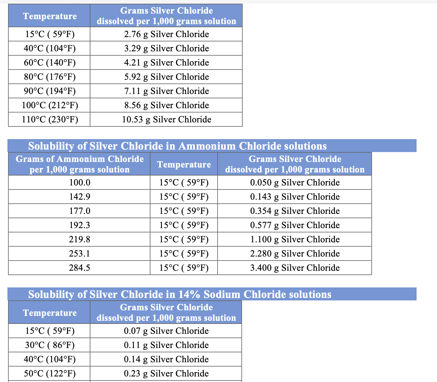

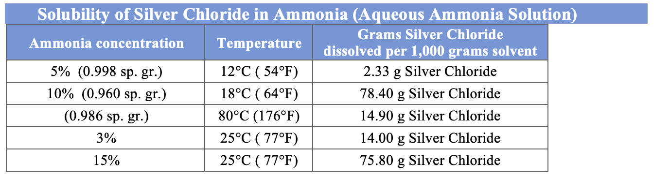

Prolonged washing before fixing salted paper is crucial, in my opinion. Especially multiple salted washes.
However, the solubility of silver chloride is dramatically different in ammonium chloride compared to sodium chloride. That is why I switched to ammonium chloride, and I am happy with the results.
I assume it is likely that a concentrated ammonium chloride solution can also remove other silver salts from the paper. Due to ammonia ions in the solution. Ammonia solution is the best solvent for silver salts.
Did you try washing the unfixed, but exposed print in a plain ammonia solution (i.e. no chloride)? Yes, it stinks...but I was wondering if that should work as well. As you said, silver chloride dissolves (to an extent) in ammonia.
No, I didn't, that would stink horribly. Historically, ammonia solutions were the first attempt at fixing images used by Hercule Florence. Ammonia and silver salts form soluble compounds together.

Ammonium chloride reacts with calcium carbonate and produces calcium chloride, carbon dioxide, and ammonia. If the paper is dipped into the salting sizing solution, that would be enough to convert all calcium carbonate to calcium chloride.
This is a trick I too have employed in FerroBlend process for working with buffered papers. And it seems to work well for not so heavily buffered papers.
We would have observed a dramatic difference in behavior between these salting/sizing solutions.
Fair point if buffered papers were used in those tests.
Anyway, Christina has given a long list of potential causes for fogging in Salt Prints apart from buffer.
