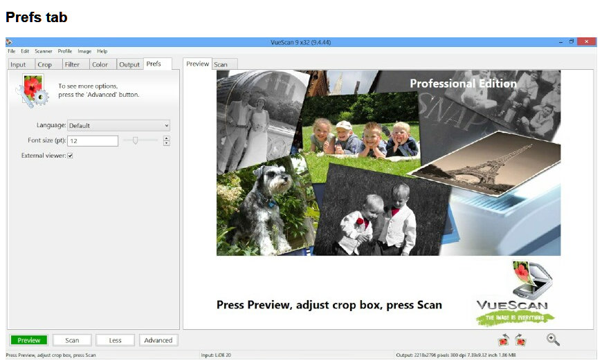

...I just read through the manual at little more carefully and, obviously, I wasn't paying attention the first time around. Is this what you're seeing?
Click on the Advanced Tab near the bottom left. All of your drop-down menus will get much, much longer.

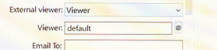

This is what my screen shows after I do:
If I want to change the Viewer, I need to either change the "default" in Windows, or click on the @ in the Viewer field and find the executable program file on my computer.

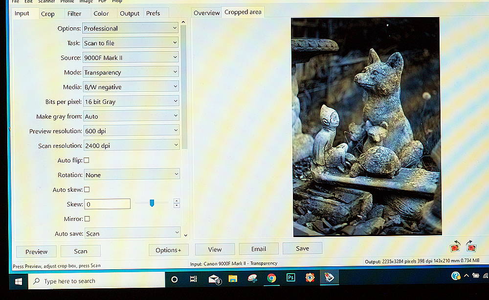

I cannot get 'screen shots' as good YOURS -- I have photographed the screen --
'INPUT' showing how I set up for B&W neg scans

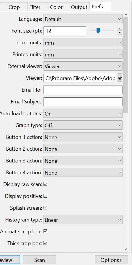

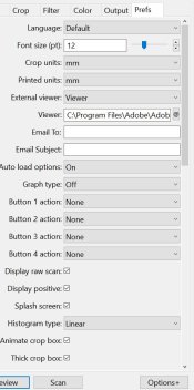

PREFS showing the External Viewer box

The middle screen is the "Options+" version.
In the middle of that, you will see:
You need to either:
1) in Windows, change the default image viewing program - which will affect all sorts of things on your computer; or
2) in Vuescan, click on the "@" symbol beside the "default" in the Viewer field. Then you need to search on your computer for the executable file for the program you wish to use.
For the purpose of this illustration, I've switched mine over to FastStone on my copy of Vuescan.
So now, that page looks like this:
In my case, that executable file is named and located as follows: C:\Program Files (X86)\FastStone Image Viewer\FSViewer.exe

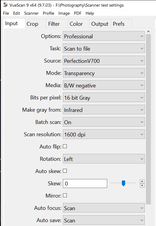

On your settings I also see that on your input settings you have on the Make grey from: auto. I have the setting to infrared instead as it helps to get rid of a lot of the "noise" on the scanned negatives. My settings are the same that Matt has set except for the external viewer where mine is set for Adobe.
