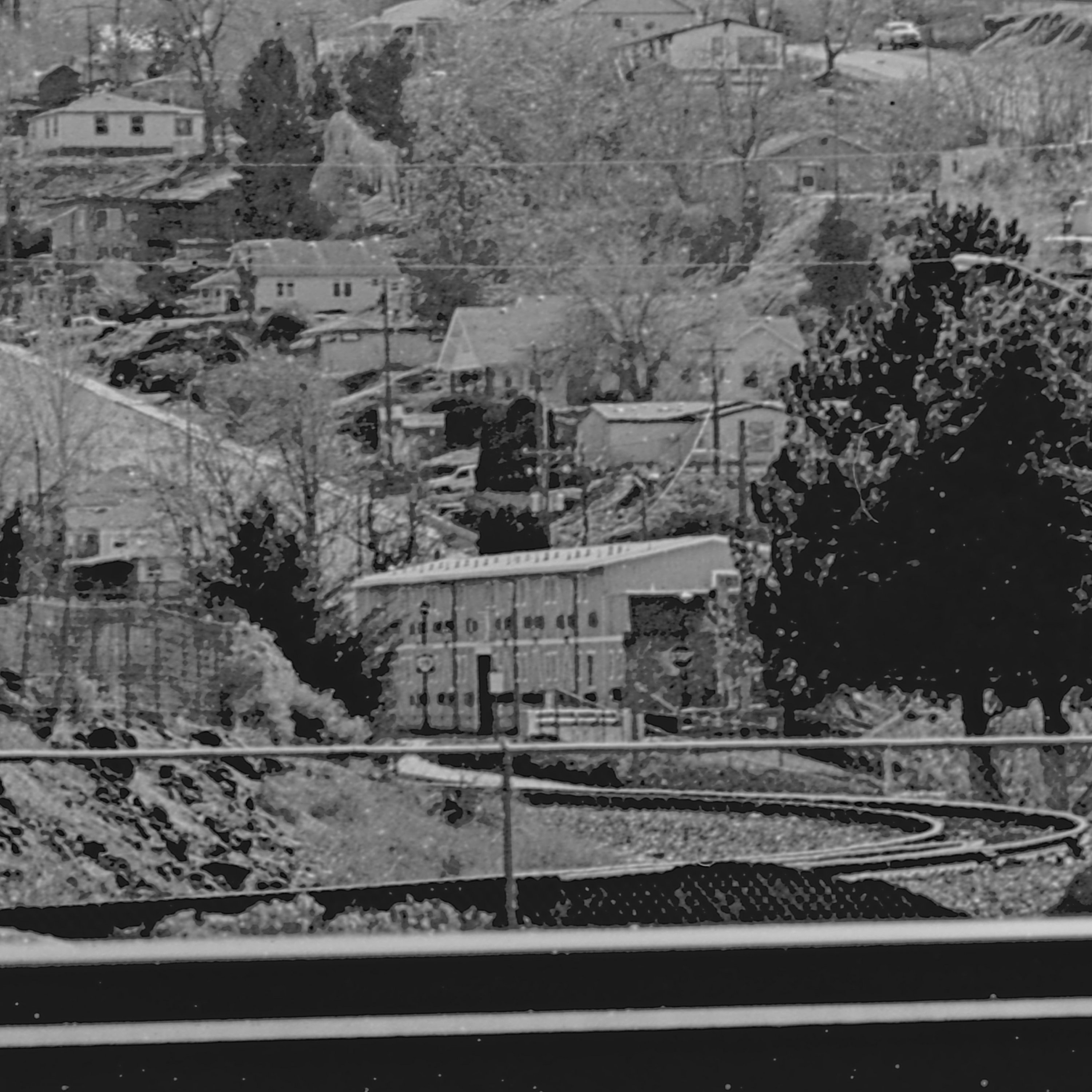

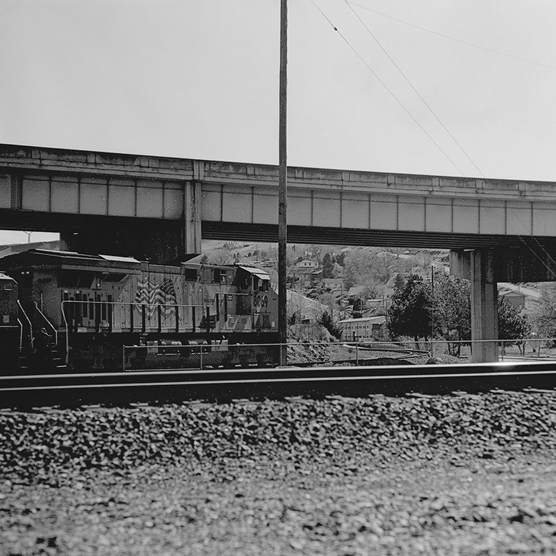

I have developed a roll of hp5plus at 200 for around 12 minutes and 73*fahrenheit and agitation every minute or so. A little overdeveloped perhaps, but getting weird results (attached). First off there are unexplained spots all over the place which should not appear on fresh film. Second it looks almost like posterization or a lack of detail as seen in the crop of the town. There is high accutance but it looks almost painted in the details, with not a lot of sharpness and the blacks are crushed even on the negative. Ansel Adams preferred these compensating developers. Are they just more suited to larger formats than 6x6?

If this is a scan of your negative try a contact print/enlargement before you make any adjustments. I was surprised at how much shadow detail I had. I'm also finding the staining is pushing down the amount of magenta contrast filtration I used previously with HC110. My estimated 13 minutes was for 70 degrees 1:1:100 and with less agitation. Frequent agitation would be good if your scene has only 5 EV Range/stops if you want to expand the negative contrast a bit but don't want to change times. Otherwise if 73 is your normal temp reduce the time. If you are shooting at 1/2 box speed (200) maybe even a little less time or agitation.
IF scanning is your work flow you may want to aim for a thinner negative. I have to scan prints on my cheapo scanner since it will not get all the dark detail from the pyro negatives. A light table and digital camera may work better.
I too had the spots on one run. Solution B can precipitate out of solution so it may need to be heated slightly and remixed. Mine was due to fixer particulates. I have started using TF5 but I find all kinds of crud in it that I do not get with Ilford rapid fix. You can try to rewash and then wipe gently with isopropyl alcohol and a negative cleaning cloth or fine microfiber cloth .

I've had cases of spots when using Pyrocat HD too and it certainly wasn't any kind of fixer particulates. When dumping the used developer to a beaker, I noticed that it had quite a lot of particles. Solution B may have some undissolved carbonate, but mine didn't because it was much more dilute (on purpose). In any case, this can be avoided if heated and shaken, but the best IMHO approach is to prepare it half strength and adjust its amount accordingly (2x). If I had to make a guess, it would be that hard tap water reacts with sodium/potassium carbonate of part B, precipitating calcium carbonate.

Scanned as a transparency and managed to pull quite a bit of detail out of the shadows. They look pretty dark though on the negatives maybe a result of too much staining.
My agitation was a little inconsistent too, I'm thinking doubling the interval and halving the agitation to maybe every 30s. Looks like there was a little bromide drag on some of the other negatives yet to be scanned
