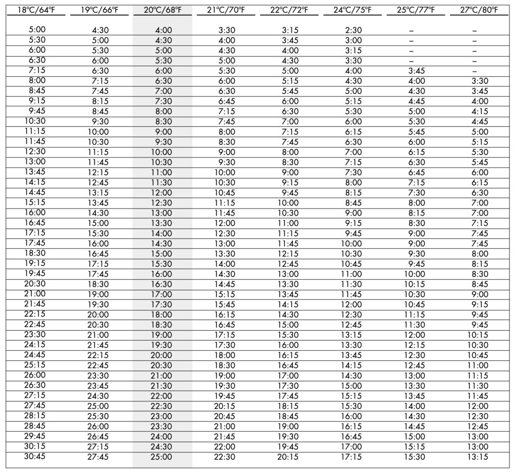

Shoot a sacrificial roll of film, cut it into several lengths and develop each length separately at different times. Start with 10 mins @20c(or whatever temp you normally use) and add one minute for each successive strip. Pick the one closest to your expectations. Evaluate and fine tune . My guess you may be around 13-14 minutes @20c, you can obviously shorten the time by raising the temp.
