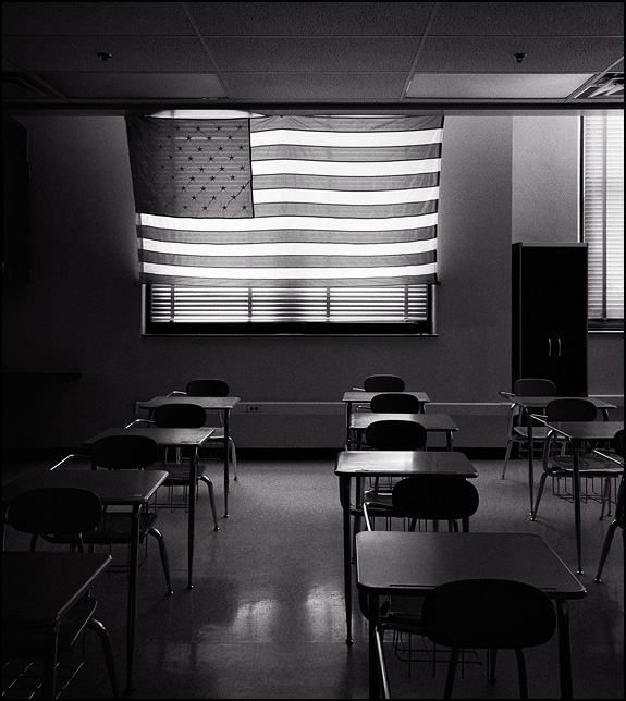

I exposed a roll of Tri-X a few hours ago, in low light, outdoors. I set my lens to f1.4 and my shutter speed to 1/8s. I didn't bother metering, but I know that the film requires a good 2-3 stops push.
Anyways, I need a developer!
I typically use Xtol 1+3, and I'm debating whether I should try DDX. I haven't had any issues with Xtol 1+3, but I just want to try something different.
How do these two compare for pushing Tri-X 2-3 stops? In terms of grain, contrast, and shadow detail.
Likewise, how do these developers compare for shooting Delta 3200?
From what I've read, Xtol offers less shadow detail, and less grain.

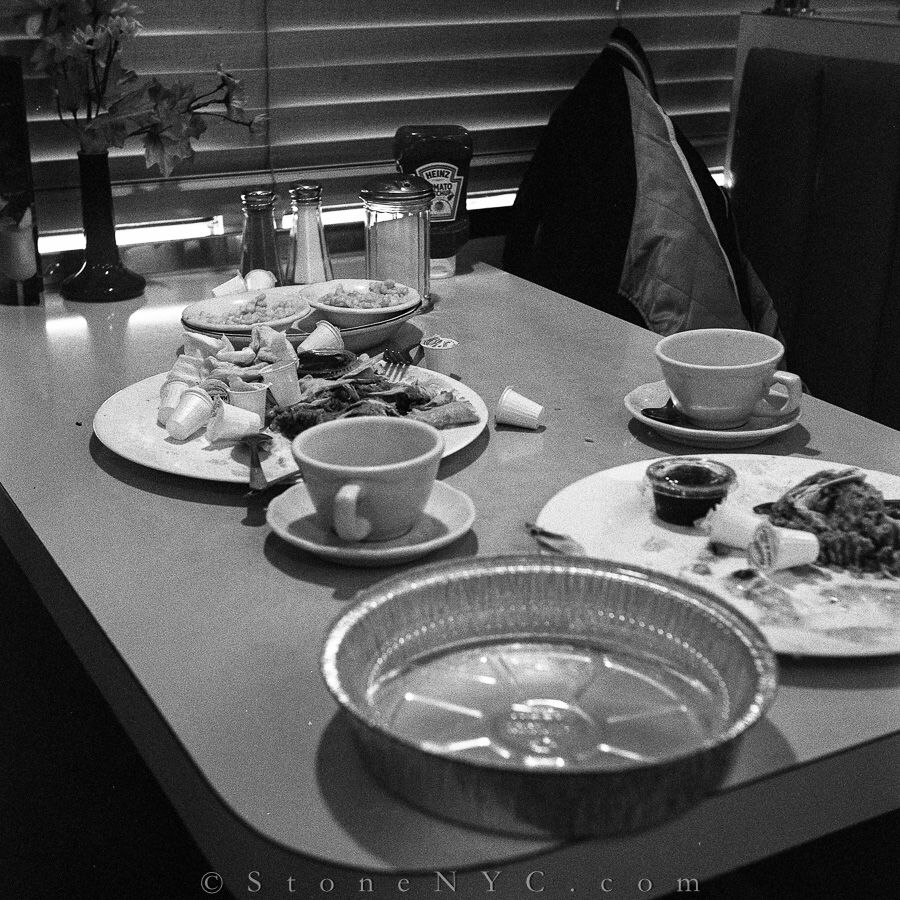

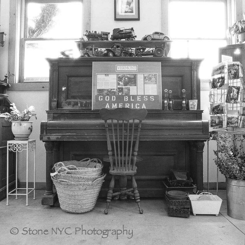

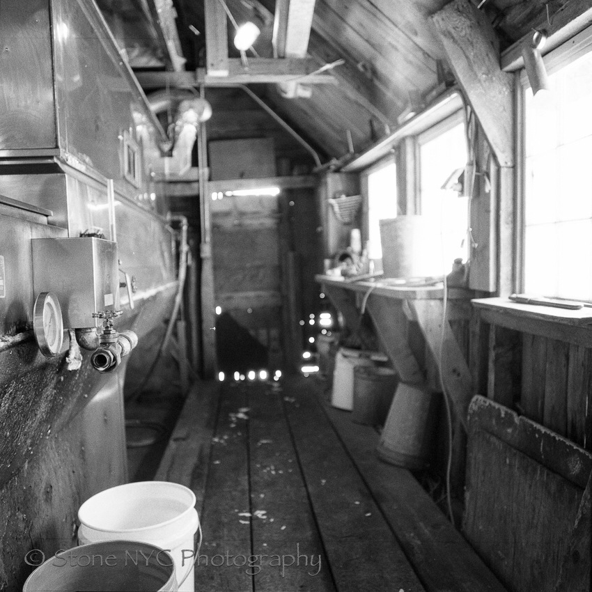

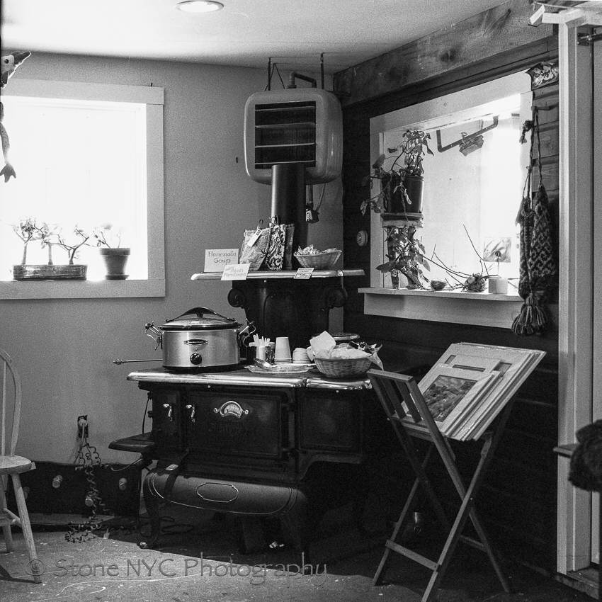

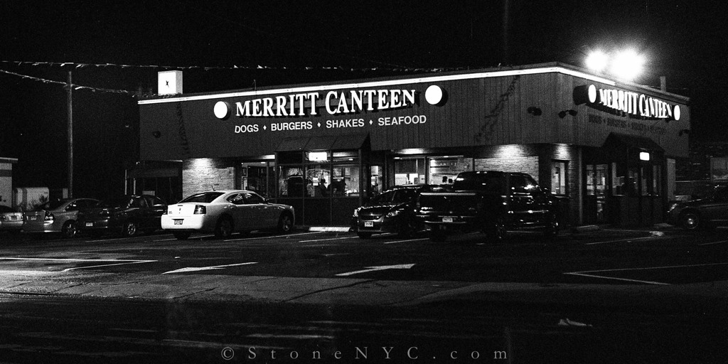

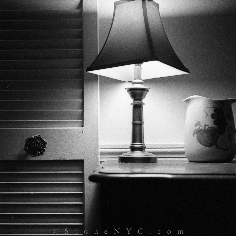

I've only had the lab push Tri-X to 3200 once, horrid results, I've pushed HP5+ in DD-X to 3200 with good results.
And I've pushed delta3200 to 3200 with good results (mind the minor light leak in the second image).
DD-X is fantastic for pushing, but is of course designed to work best with ilford films, but I'm sure it could help your situation as well.
Good luck, whenever I need a good image from a grainy film I use DD-X, holds back the grain and gives a nice push.

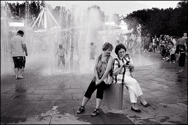

I think you need a good compensating developer.
This is 400TX at 1600 with HDC-2.
The only developer I use for film.
SpotmaticF, SuperTak 55/1.8 at 1.8 or 2.0, scanned w/ dslr, black+white points adjusted
IMGP9114.jpg von splash_fr auf Flickr

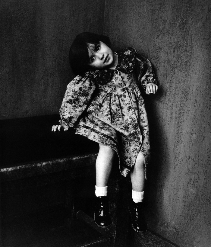

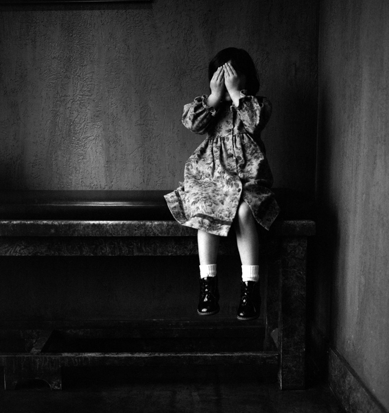

I haven't pushed Tri-X before, but Tmax Developer is the best pushing developer I have used for other films. Tmax 400 and Ilford Delta 3200 both push beautifully in Tmax Developer. I think DDX is a very similar formulation with similar characteristics, so I'd go with either Tmax Developer or DDX. As others have said, shadow detail is gonna suck anyway, but Tmax Dev. seems to keep grain low and sharpness good with as nice of tonality as you can get pushing a 400 film to 3200.
Delta 3200 is a gorgeous film developed in Tmax. I have shot it at 1600 and 3200 (developed for the appropriate time for the speed I chose) with great results.
Here are some done with the 120 size Delta 3200 at EI-3200:
and here are some 35mm Delta 3200 at EI-3200
