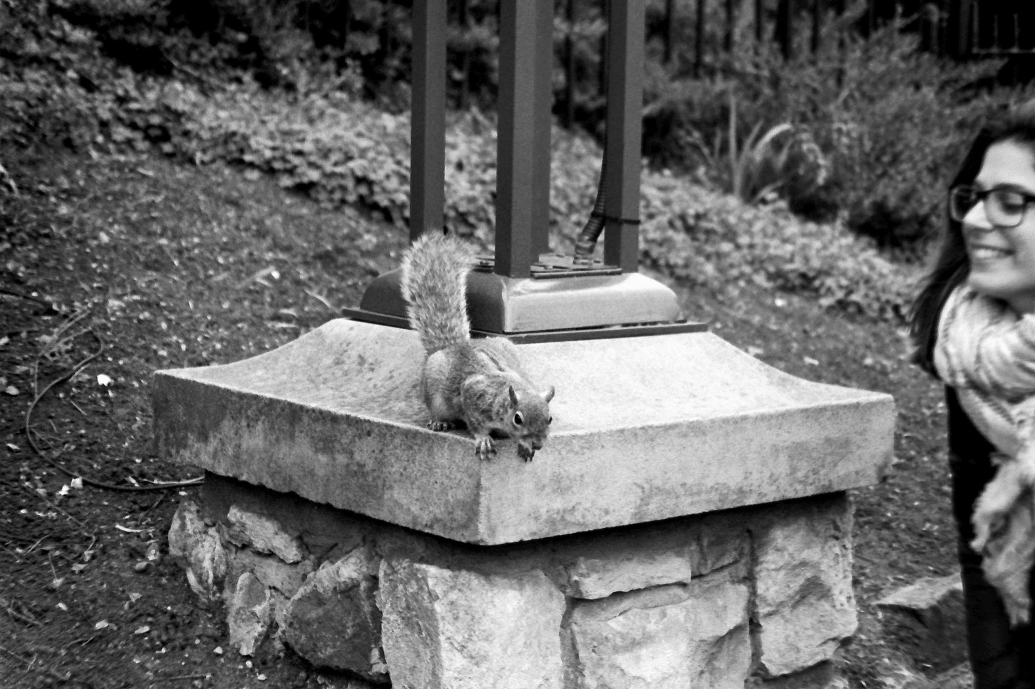

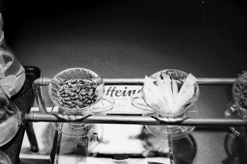

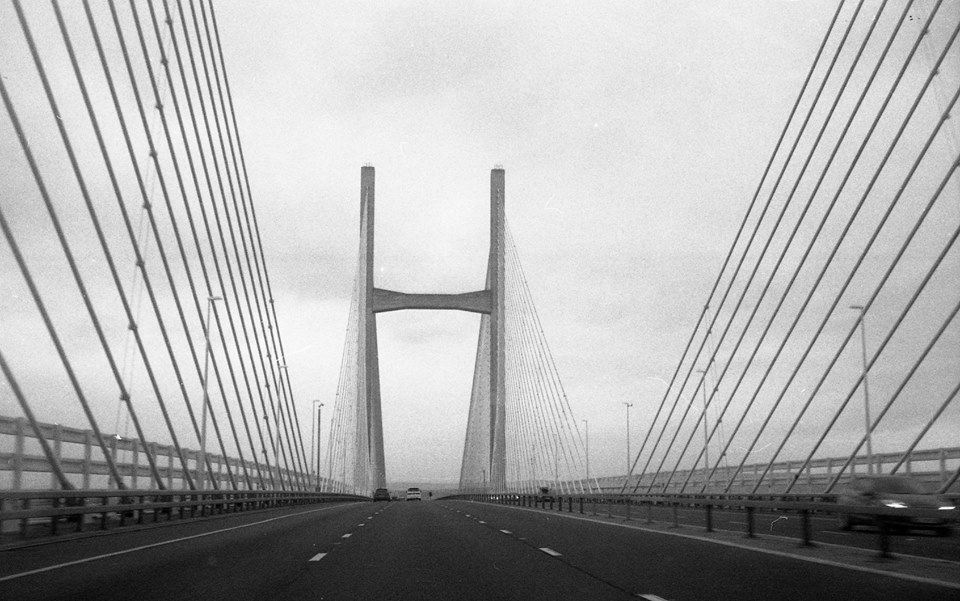

Here are some of the images I took pushing HP5+ to 1600 in bright sunlight and indoors but during daylight hours.
17353650_10154189148171577_4084171218329062731_n.jpg 17359214_10154189148281577_7121009665535086366_o.jpg 17424737_10154189148256577_8849191858590659835_n.jpg
View attachment 225881 View attachment 225882 View attachment 225883
Thanks for the pics. Did you mean to say "oudoors" rather than "indoors" in your statement above? If it was outdoors however the light looks quite even and more like overcast conditions?
I suppose the argument is that while pushing HP5+ in bright sunlight to say 1600 might give shadows without detail the saving grace of bright sunlight is that high film speed is not really required. At sunny f16 even racing cars or motorbikes can be shot at 1/800th at f11 at 400 :D
If there was a requirement to shoot on the same roll at both 400 and 800 some films TMax being one suggest the same time so you have total versatility but with HP5+ there is a jump but with Microphen it is only 1.5 mins. I wonder what the best strategy is: Shoot all at 800, develop for 800 and simply lower the contrast when printing or find some compromise time between 6.5 and 8 mins such as 7.25 mins
Anyone any ideas on this, especially those who have used to good effect a compromise figure between 6.6 and 8 mins?

Two photos were taken outdoors, one indoors in a coffee shop. My recollection is that it was a sunny day. I had one roll of film on which I was later going to shoot at night, hence shooting at 1600. Earlier in the day, on the way to my destination, I saw a couple of things i felt like photographing.
Thanks. It was just that in the two outside photos the light looks "flatish" as you get on overcast days. it may have been that both were in open-shade and on bright days open shade can appear to show overcast conditions.
pentaxuser

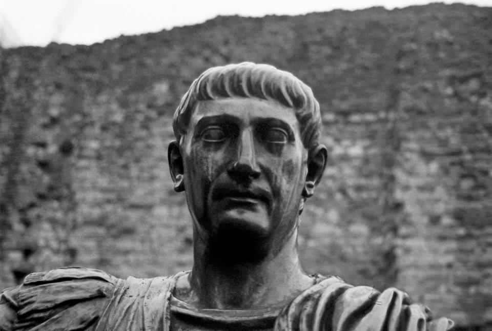

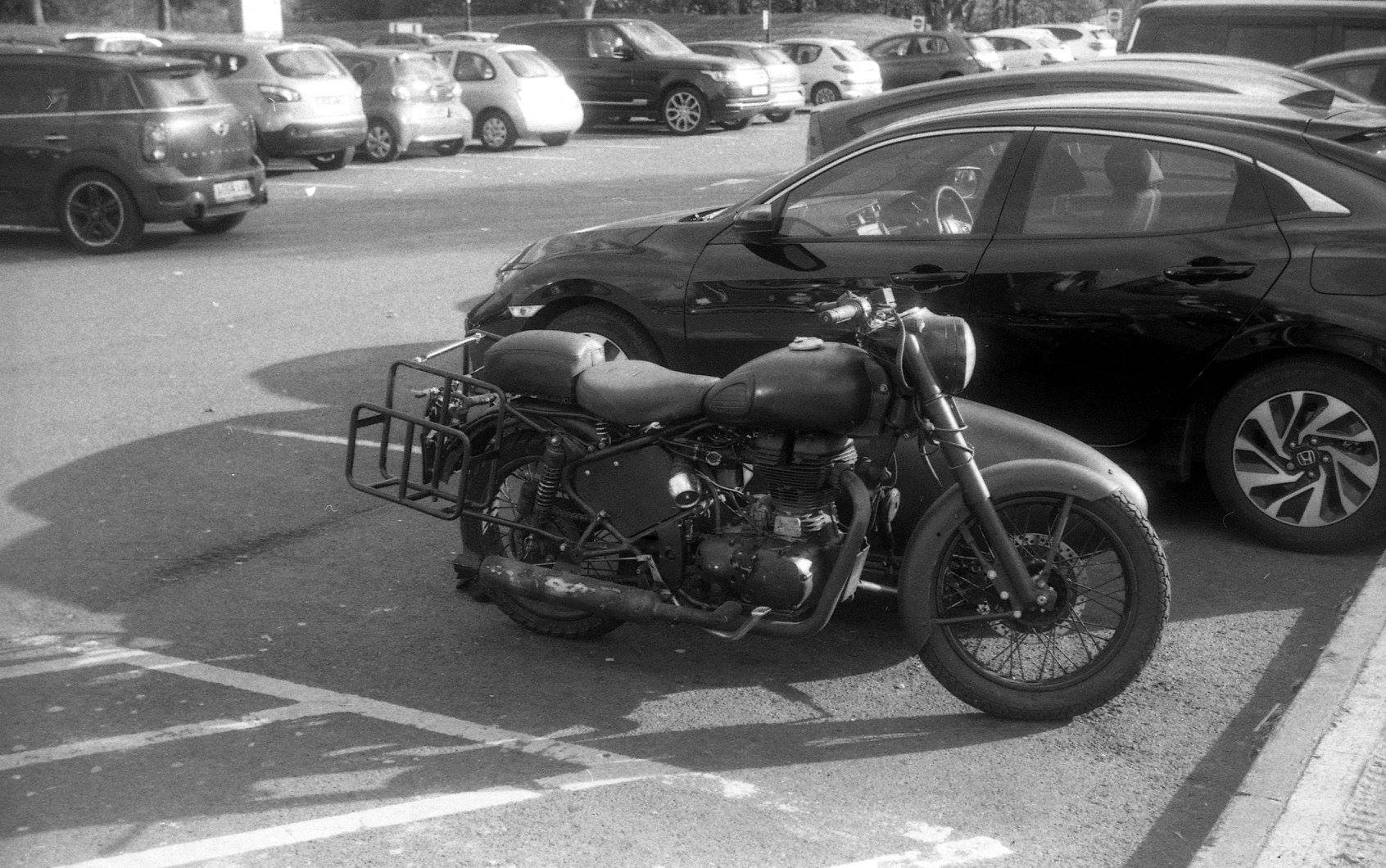

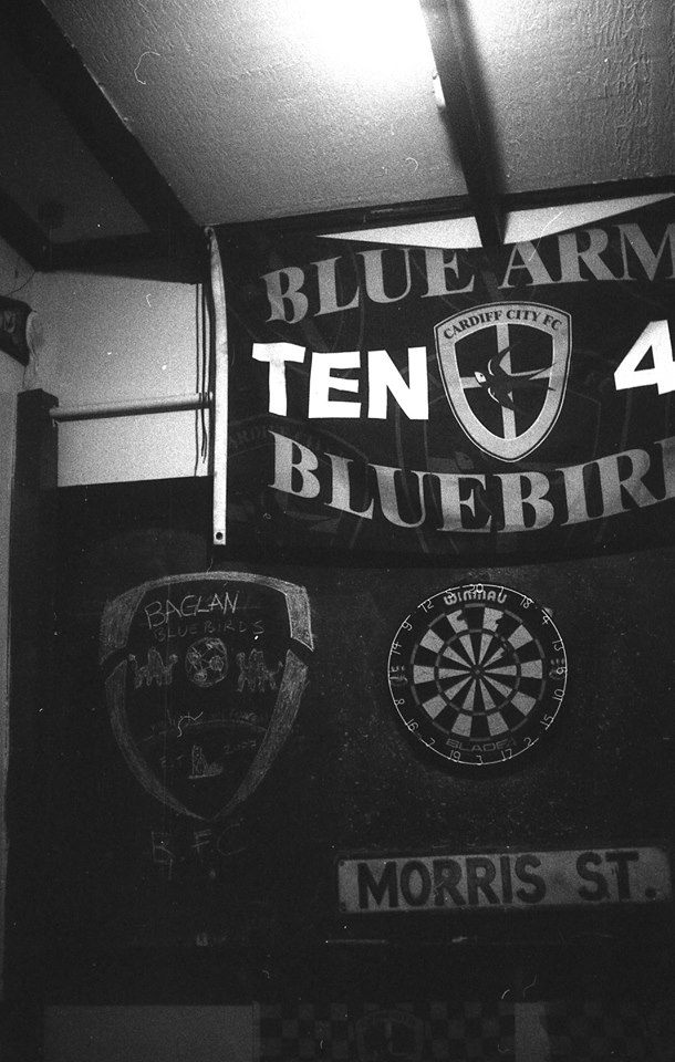

Here are three more, shot on an Agfa Super SIlette rather than an SLR (the previous were a Praktica BX20S). HP5+ exposed at 1600 rather than 3200...definitely a sunny day. I was on my way to Wales and knew that I'd be photographing people in a dim pub later in the evening...

Agulliver, good shots at 1600. Always difficult to judge what a print will be like from a scan but I imagine they'd be fine. Plenty of open shadows in the bike shot so no featureless shadows which can be the problem when pushing. Judging by the bike I take it this was a sunny day in Wales but not in 2019 more like 1959:D That's what bikes should look like. Not the modern day plumber's nightmare with exhausts practically under your backside.
My developer of choice is Xtol but I see no reason why this shouldn't give equally good results
