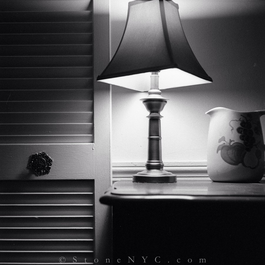

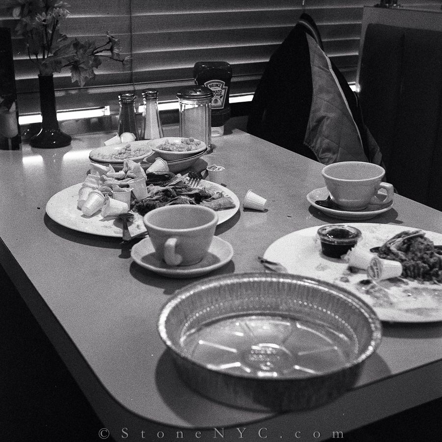

I never posted results, but they were spectacular! HP5+ in DD-X 20 minutes... (This was hand inversion before I went rotary so times will change hopefully results won't).
Shot in 127 format on my Yashila44LM but some cropped as planned.
ImageUploadedByTapatalk1392086126.579981.jpgImageUploadedByTapatalk1392086153.447316.jpgImageUploadedByTapatalk1392086171.615536.jpg

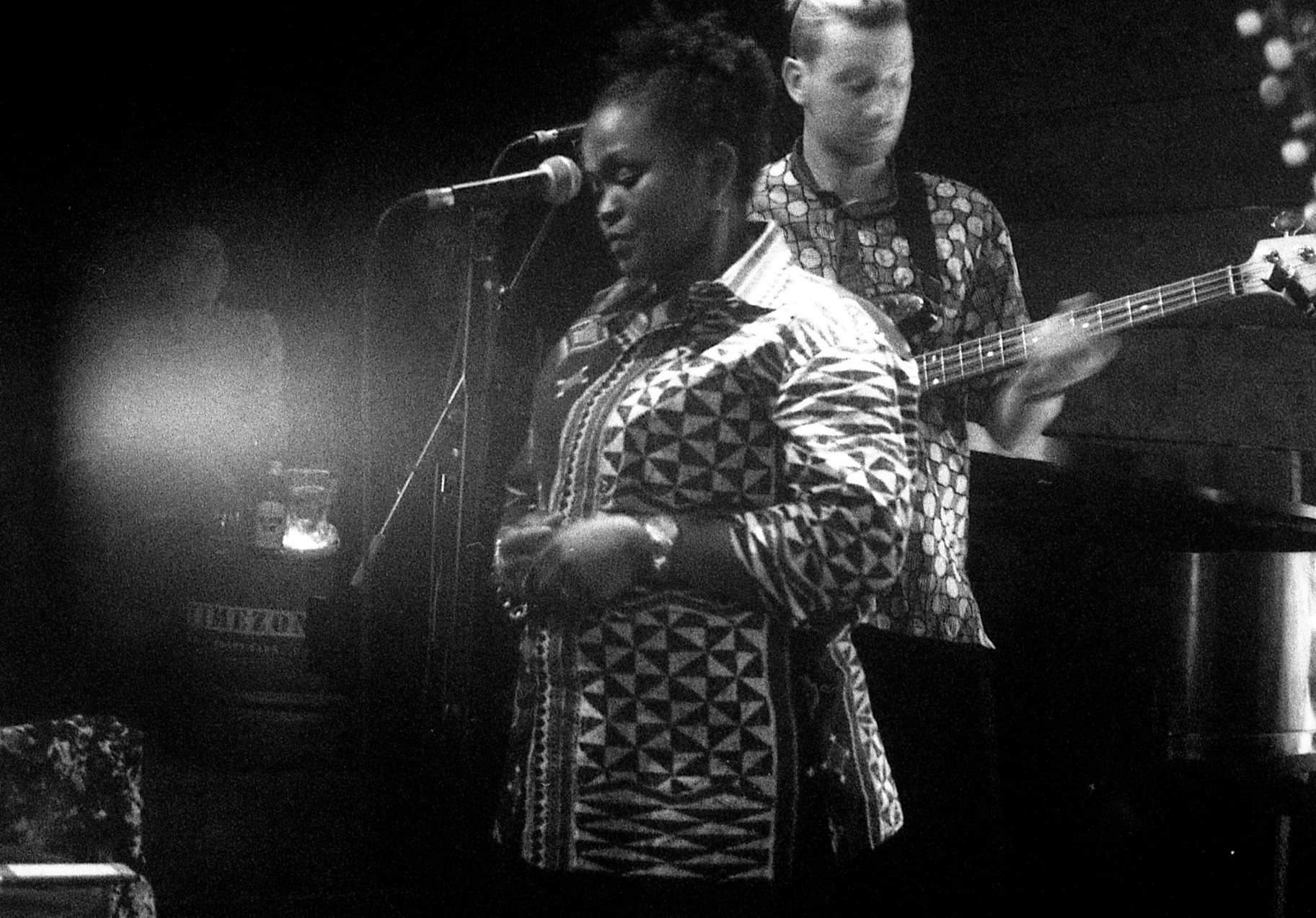

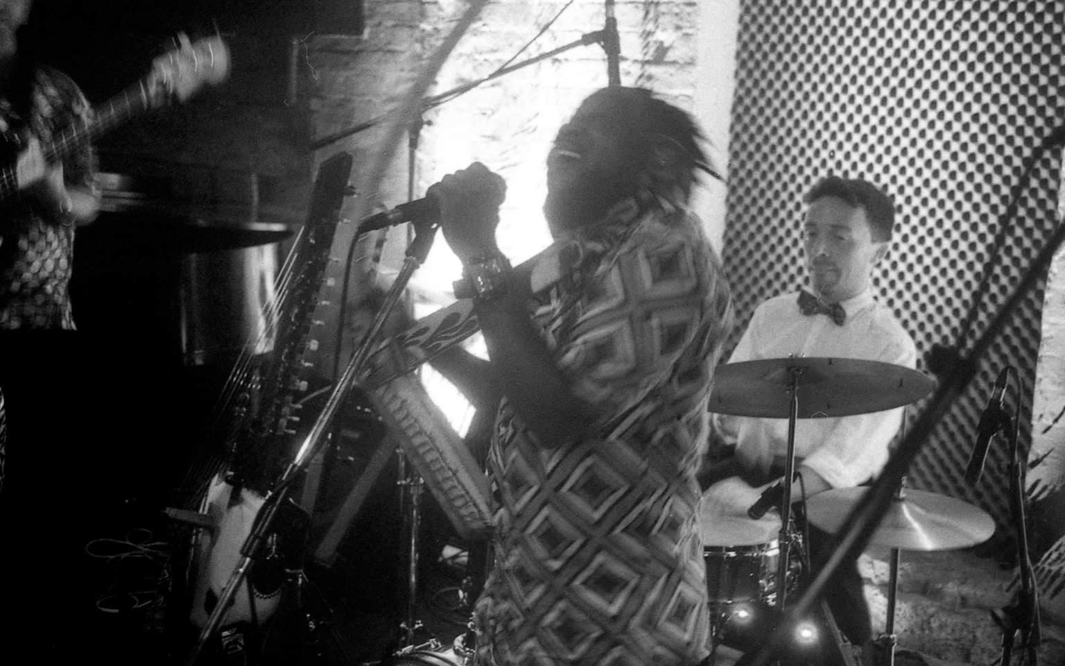

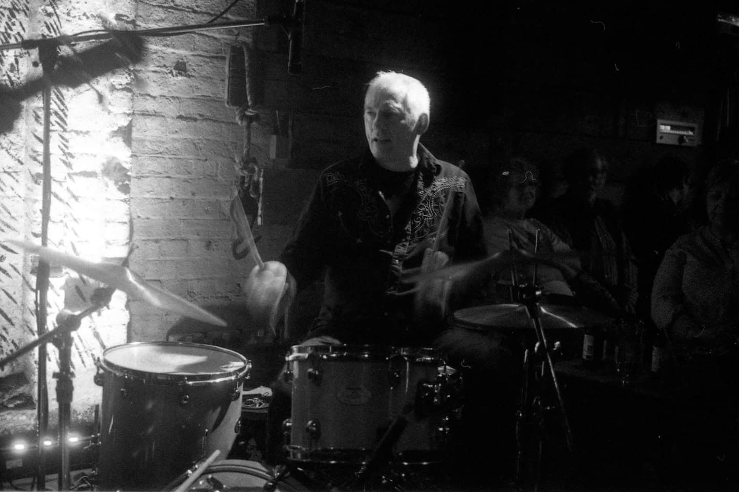

A couple of months ago I discovered a local music club, where the owner and bands are more than happy for photography to take place. I've been shooting some HP5+ and pushing to 3200, often shooting 1/8 or 1/15 second at f2.8 because the lighting is very low. Indeed the wall behind the small stage is lit much more than the artists performing.
I tend to process for 19 minutes @20C, or shave off a minute or two if it's warmer....two inversions every minute in Ilford ID-11.
Here are a few from the last two weeks....Henri Herbert & band, and the Seby Ntege band. Yashica Minster III camera used in both cases.

FB_IMG_1561453137674.jpg FB_IMG_1561453146143.jpg FB_IMG_1561453170124.jpg FB_IMG_1561453186058.jpg FB_IMG_1561453189117.jpg FB_IMG_1561453193544.jpg FB_IMG_1561453198435.jpg
I apologise if I've added to your sadness by sharing some pictures.
No, your pix are fantastic! I saw the OP's pix too, good to see he was able to get things to work for him -

I have experimented at the music venue with D3200 as well, and I feel I prefer HP5+ pushed....but then I am looking for a certain amount of grain and high contrast. I did make traditional prints from some shots I made at a gig in 2016 on HP5+ pushed to 1600 and was able to get more detail in the shadows than I was scanning at the time (though I now have a better scanner so who knows). You certainly can print the negatives you get from pushing HP5+ three stops. I do get my HP5+ in 100 foot rolls, which results in much reduced costs compared to buying HP5+ in 24 or 36 exposure cassettes and is seriously cheaper than D3200. Where I have enjoyed D3200 in this specific scenario is in a 6x6 folder with an f3.5 lens.
I use ID11 and 19 minutes with two inversions every 60 seconds, or if the weather is hot (as it has been this week) i might use 17 minutes. What I've noticed with HP5+ is that the additional time to go from 1600 to 3200 is quite a lot, as much as six minutes, so it's not necessarily critical that one gets it exactly right. I'd also suggest trying Microphen - though this is only something I've done once. I'd need to do more experiments with Microphen to be sure but I *think* it resulted in less grain and a little less contrast.
On another occasion I shot some photos on a very sunny day near the Tower of London using HP5+ which I was pushing to 1600. High shutter speeds, small apertures of course....and high contrast but pleasing images which could be tamed with the right printing filters. I used the same roll later in the evening for night shots hence the pushing....and during the day I was looking for interesting lighting situations which already had a lot of contrast.
