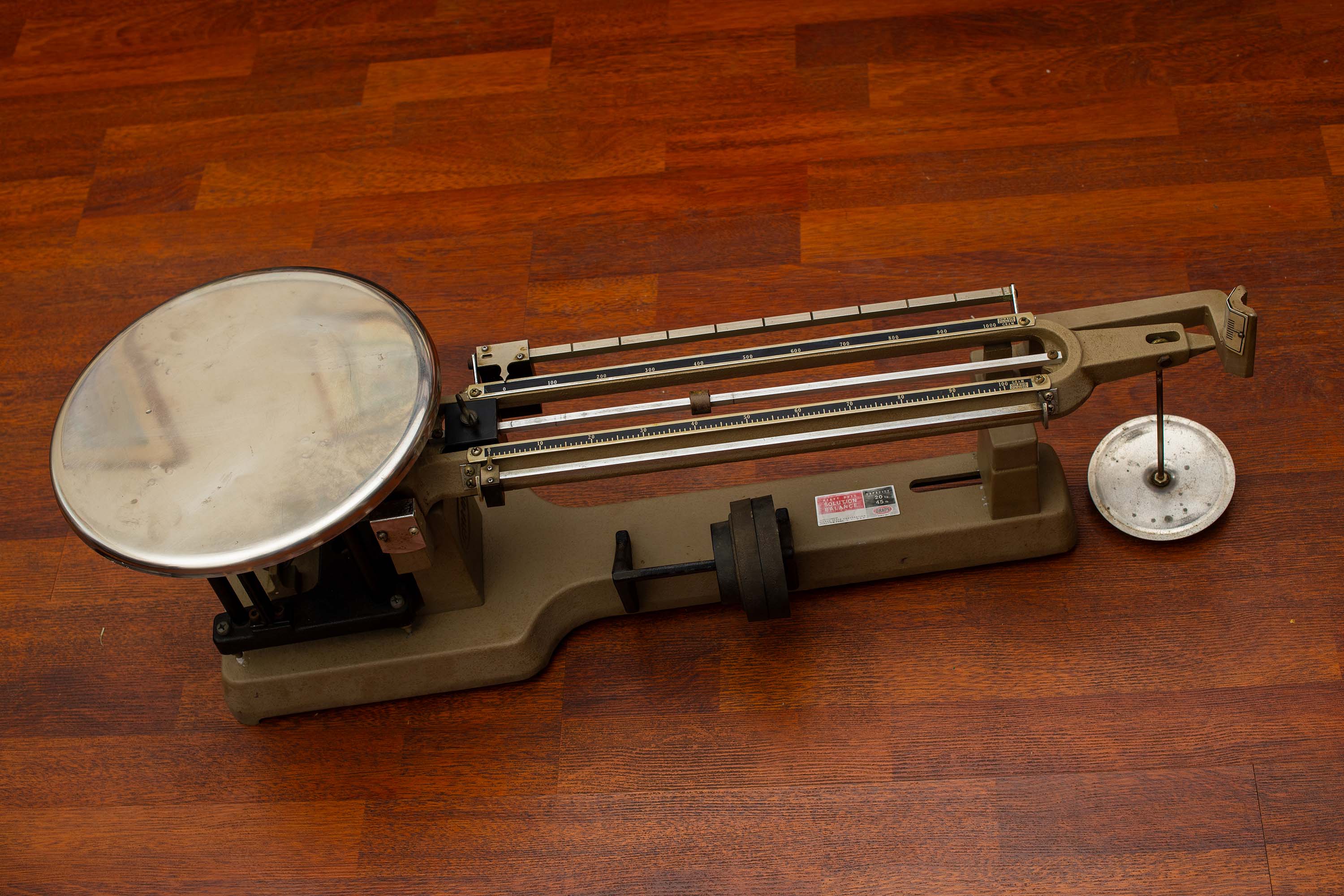

I have this one. By itself it's capable of 1100g with 1g resolution. With enough weighs it can do up to 20kg. With the weighs I have there it can do 6100g. I think it's accurate to +/-1g but it's a pain to use. View attachment 414362
I have the same balance. It's a solution balance, 20 kg capacity. You tare your container. Then knowing the specific gravity of your final product. You can either weight the dry component on this or separately, add water until you have weight equal to your target volume x target specific gravity.
Works best for uncomplicated mixtures. I rarely use it for solutions but it comes in handy and is unambiguous!
