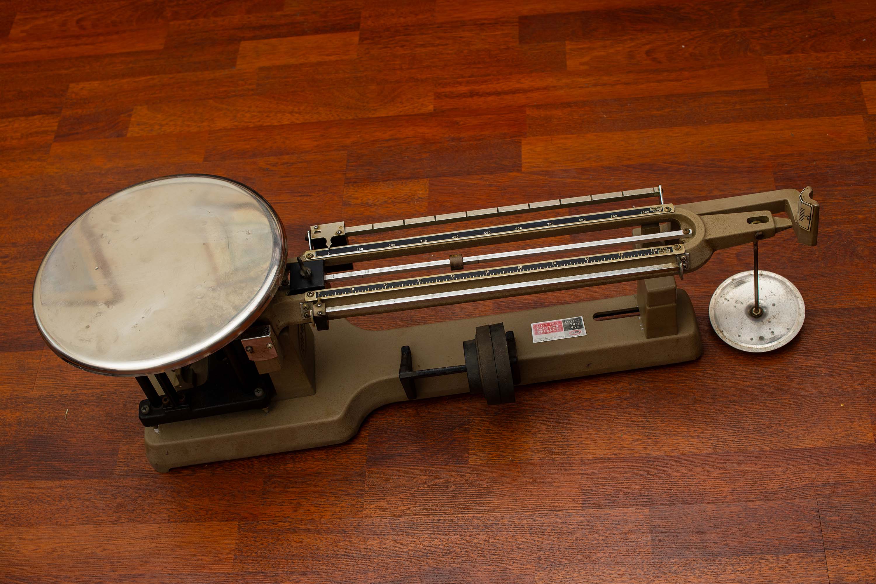

I have this one. By itself it's capable of 1100g with 1g resolution. With enough weighs it can do up to 20kg. With the weighs I have there it can do 6100g. I think it's accurate to +/-1g but it's a pain to use.
The is zero chance that a $20 scale is accurate to 10 milligrams (0.01g) no matter what it is showing on its display..
It does come with some calibration weights (10g, 5v, 1g) all of which show the correct weight, so it’s probably good enough.
