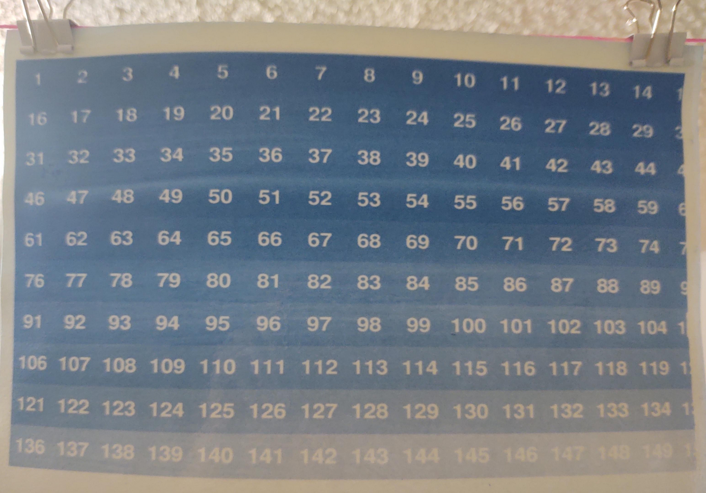

Here is my first exposed calibration sheet. each square is 5 seconds I think:

Welcome aboard @imgprojcts and thanks for sharing your innovative way of making cyanotypes! Interestingly, this relates to some other things that have been happening lately on here (and elsewhere) as well. I'm alerting in particular @AndrewBurns who has been working (successfully!) on getting 3D printer LCD's to work for alt. process printing, using a UV LED array light source: https://www.photrio.com/forum/threa...egative-in-alt-process-contact-prints.207526/
Andrew was also the one who reminded me of the potential for using a DLP/projector for alt. process printmaking and I've included it in my recent blog on this topic: https://tinker.koraks.nl/photograph...e-of-digital-output-for-alternative-printing/
However, you're the first I hear of who is actually doing this - awesome!

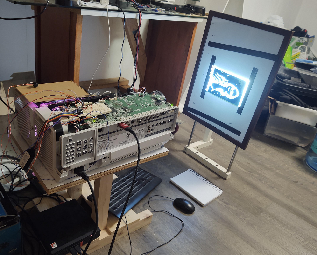

Here's the link to the video that inspired me:
You'll hear the the guy exposed the stuff for hours. But it depends on how big the print is and also what formula you're using. The New Cyanotype formula is much faster than the old one. For a big-ish 11x15, I expose usually for 20 minutes.
In parallel I'm working on several things about my projector. The first thing is or was the light bulb. I got ADHD about it and I can feel the bulb dying in hours lol. So I figured out a way to bypass the ballast and use an LED. I haven't switched to that yet, but thanks to another YouTube video I guess that I can do it and still get an ok image? I already tried a UV LED 50w and it's pretty much as strong an output as the 3000L projector on its own without any optics between it and the paper. So I'll try a stronger LED, maybe 200W. The LED has to be around 20mm square or round for optical stuff to work out. Don't know about Colimation but I got another trick up my sleeve. Anyway I tried just a powerful LED flashlight and it got me Prussian white as quick as the UV lamp. So the chemistry is definitely sensitive to more than just UV light. In fact my sheets do change color slowly with just the room LED light in the ceiling. So the light will be a 200W near 6000k bright LED.
Finally to focus the light, I'm going to use mirrors instead of lenses. That's where the very...ohh very complicated python+ rpi2040 bypass scheme comes into play. And I mean this was complicated. I spent several weekends on just trying to get the thing to run without the lightbulb. But the final piece of the puzzle is the mirror system. I will have two cylindrical mirrors bouncing the light right into the DMD chip. I possibly need to have a short integrator tube, which is just a fancy tube with all the walls being mirrors. What it does is to homogenize the light to prevent vignetting. You can also use a diffuser but that absorbs light. Specially UV. All of these hopes and dreams are to remove optical elements that absorb UV. And that's it. Like if I achieve any of this I'll be pretty impressed with myself. Mind you I can already run the projector without the bulb but it's pretty sketchy and I gotta time it right. I'm on a sort of break from that right now to clear my mind and bring it back to the other real problems like focusing.
I got no clue really what sort of light the chemistry is sensitive to. My guess is that most of it is in the blue or higher frequency. I suppose I could actually figure it out actually just by creating exposure sheets for various colors and letting the color wheel in the projector actually change the color. Single color means I don't have to have special lenses due to color fringing which might ruin the focus. But hey if nothing here actually gets to be, the least I can do is to remove the color wheel. According to a web report, removing the color wheel and letting the projector be basically black and white will double the light power output. That could be all I really need.
Finally the single mod I've done so far is to add very thin rubber spacers to the lens so I can achieve close focus for small very quick prints. 3x5"s can be exposed in just 20 to 40 seconds. You basically focus the image to the board, block the light, place the paper and shutter the light for 20 to 40 seconds. It's amazing 😍. The cool thing is that there are hundreds of thousands of very cheap projectors online and you don't need high rez to get something decent.

Can you post a simple picture of this contraption? I have a hard time picturing it.
Any projector will work. The setup is simple, there is a projector on a table and a screen. And Holyshishkabob! my first print looked like a negative when I took it off the screen. I was disillusioned. I thought it was really going to suck when I developed it. But boy was I wrong! I was sooooo wrong. This is truly the very best cyanotype I have ever made. it looks like a darn picture developed at walmart.

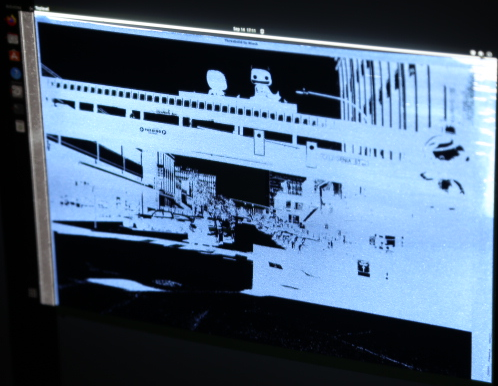

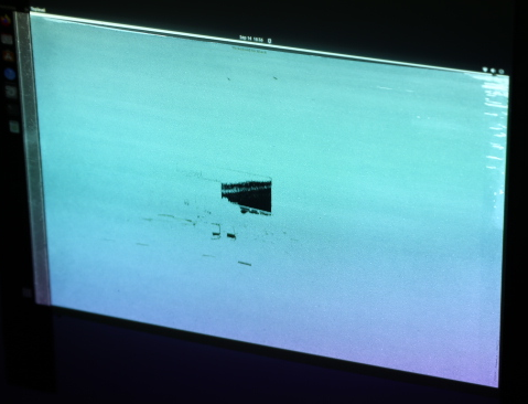

The image as it is being developed is just shadows like this. Pardon the colorwheel rainbow, it looks nothing like this in real reality except for the shadow

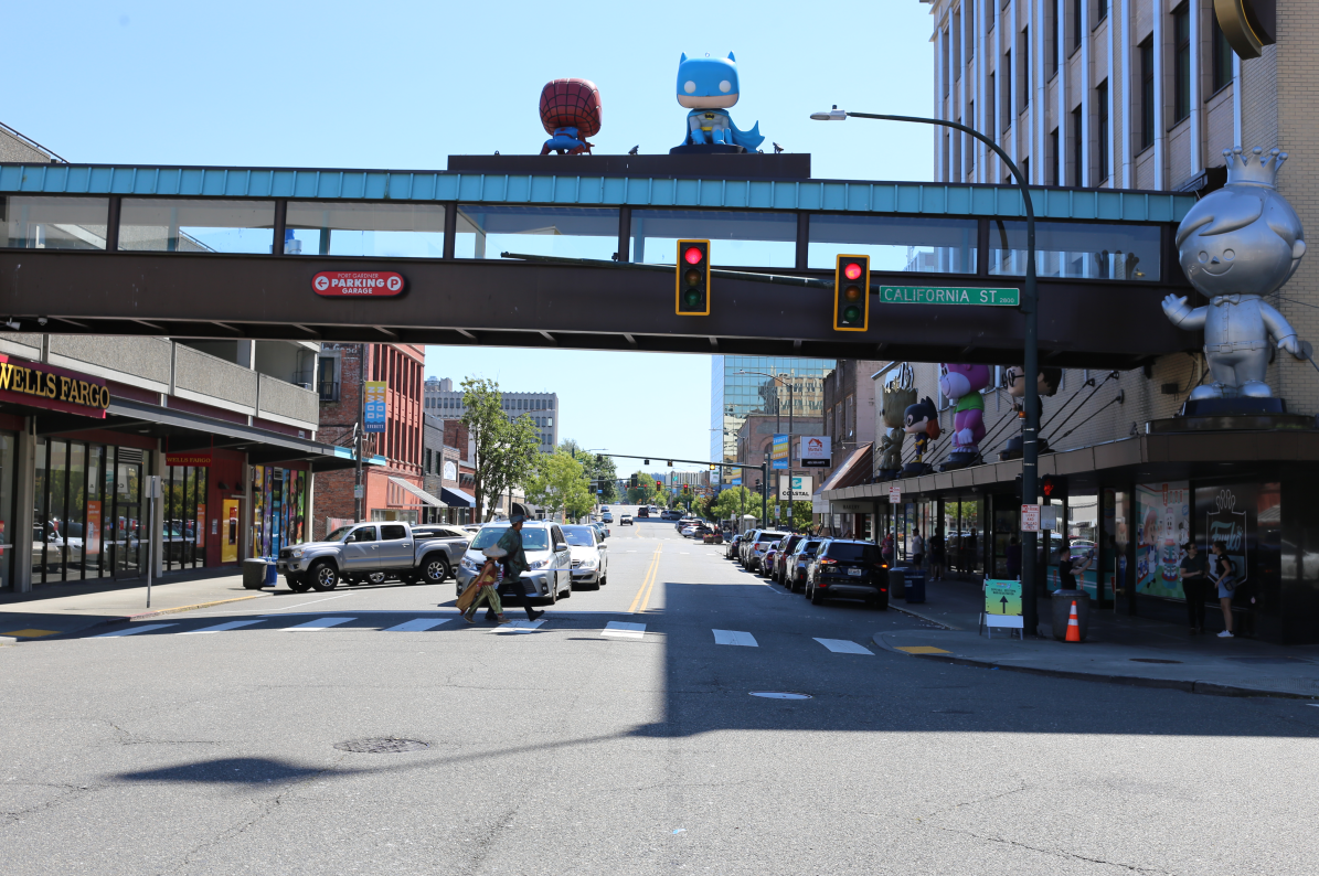

OK here is the next picture I am going to try. This is going on canson XL mixed media paper with no acid pre-treatment.

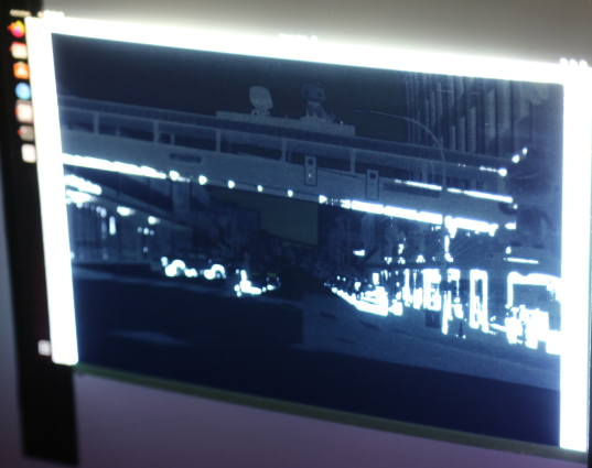

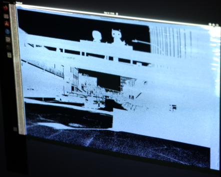

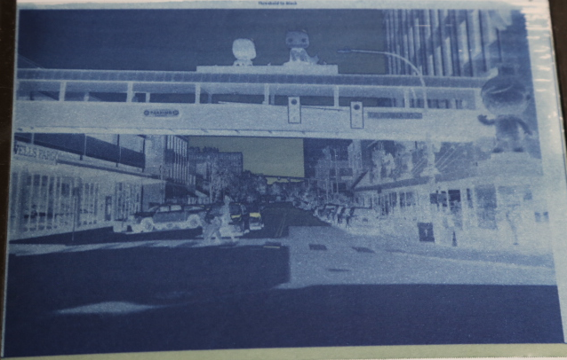

Ok here is some detail on the process. first the exposure, then the result, then the developed image:

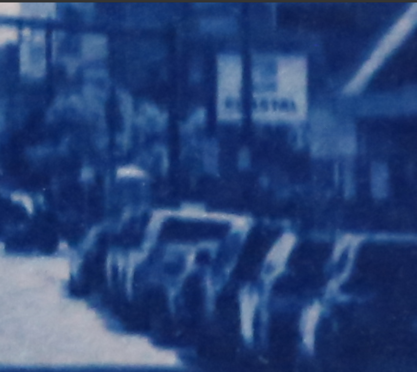

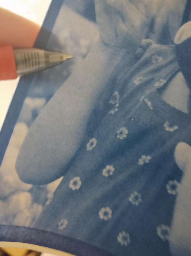

Here is a zoom into the little sign towards the center. That's 5mm wide by 3.8mm tall

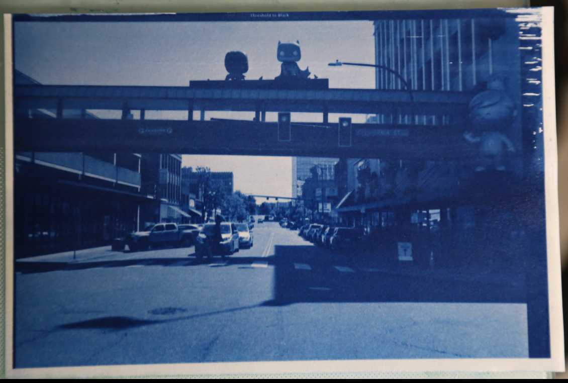

I overcooked this photo. but if you look at the fully exposed one, check out the details in the shadow areas. I think this is a game changer. Its "sharp enough".

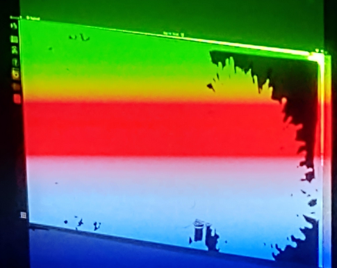

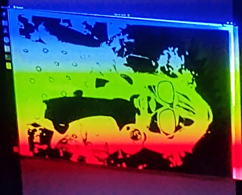

Interesting, I assume the colour bands in the photos you've taken of the exposure being performed are because the projector hasn't been modified and so it's still trying to project an image with RGB channels, you wouldn't normally see them by eye due to persistence of vision but the camera does as it's running at a fairly high shutter speed.
As the spectral sensitivity curve for cyanotype shows, it's basically only sensitive to 'royal blue' and shorter wavelengths, meaning that if you're projecting a 'white light' image with distinct RGB channels the majority of your light power is being wasted. The reason that a conventional white LED light source slowly fogs the paper is because white LEDs are actually blue LEDs with some phosphor to re-radiate the light energy at longer wavelengths, but there is always some blue component of the base LED that makes its way through as well (just a small fraction of the overall power).

Thanks for the pointers. The LED I got for this is a 380nm. 365 is somehow more expensive. I've looked into decaping or removing the phosphor but that's a thing to try only if things don't work out as planned. For now I figure a 200w white LED has enough blue light in it as you mentioned. Another part of this project is to make an exposure unit. I haven't decided yet what size I want. The 11x15" is not bad, but I could go 24" tall with a 1hr exposure probably.

Its "sharp enough".
Yeah, it looks OK; not super sharp evidently, but should be good for casual viewing. You get a little fuzziness due to everything not being entirely in focus, but that's good because you don't get to see the individual pixels in the final print.

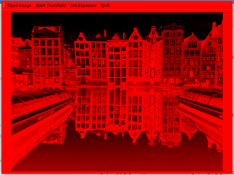

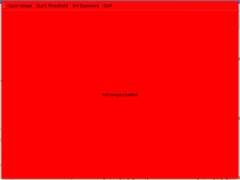

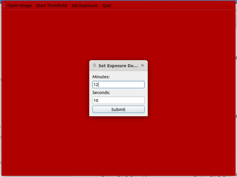

I've worked really hard on this today, putting up with incredible chat GPT ineptitude to write the program that it wrote for me in excruciatingly painful repetitious prompts. I changed from TKinter to PQt because pqt offered more flexibility in its GUI creation. I also changed from CV2 to just PQt because cv2 was not playing along and then I realized that I am not doing anything more than what PQt can offer. If you want to run this on your linux box you will need to install the prereqs:
# Update package list sudo apt update
# Install Python 3 sudo apt install python3
# Install pip for Python 3 sudo apt install python3-pip
# Install PyQt5 and Pillow using pip pip3 install PyQt5 Pillow
# (Optional) Install additional development libraries sudo apt install python3-dev
The program opens a window which is red by default such that you can place a sensitized paper under its projection and not have it develop yet. Then you go to file open an image, you can resize it as needed and place it as needed. Finally you can check the exposure and input the number of minutes and seconds you would like to run this for. finally hit the exposure button and go get a coffee. I don't drink coffee but its what is normally suggested.
When you are done it returns to red. then you can go find another image or you can re-run the image. Press the s key to start the exposure. Press the q key to close the program or you can go to the quit menu.

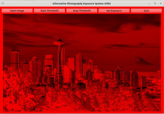

Well, I rewrote the app from python CV2 to QT5 and now C++ QT5 and the best thing that I found to make the app work best is to reduce the image size to 1920x1280 which is the projector's native format. that seems to make the ThinkCentre 2 core processor work OK just divide the total exposure by 2.2 in my case and it works. I'm getting exposures of 12 minutes. at 19" from the screen I am doing 5.5x8.5 Canson XL, but the screen is a little larger at that distance. The GUI got a rando ChatGPT update. what ever it wants, you gets:
