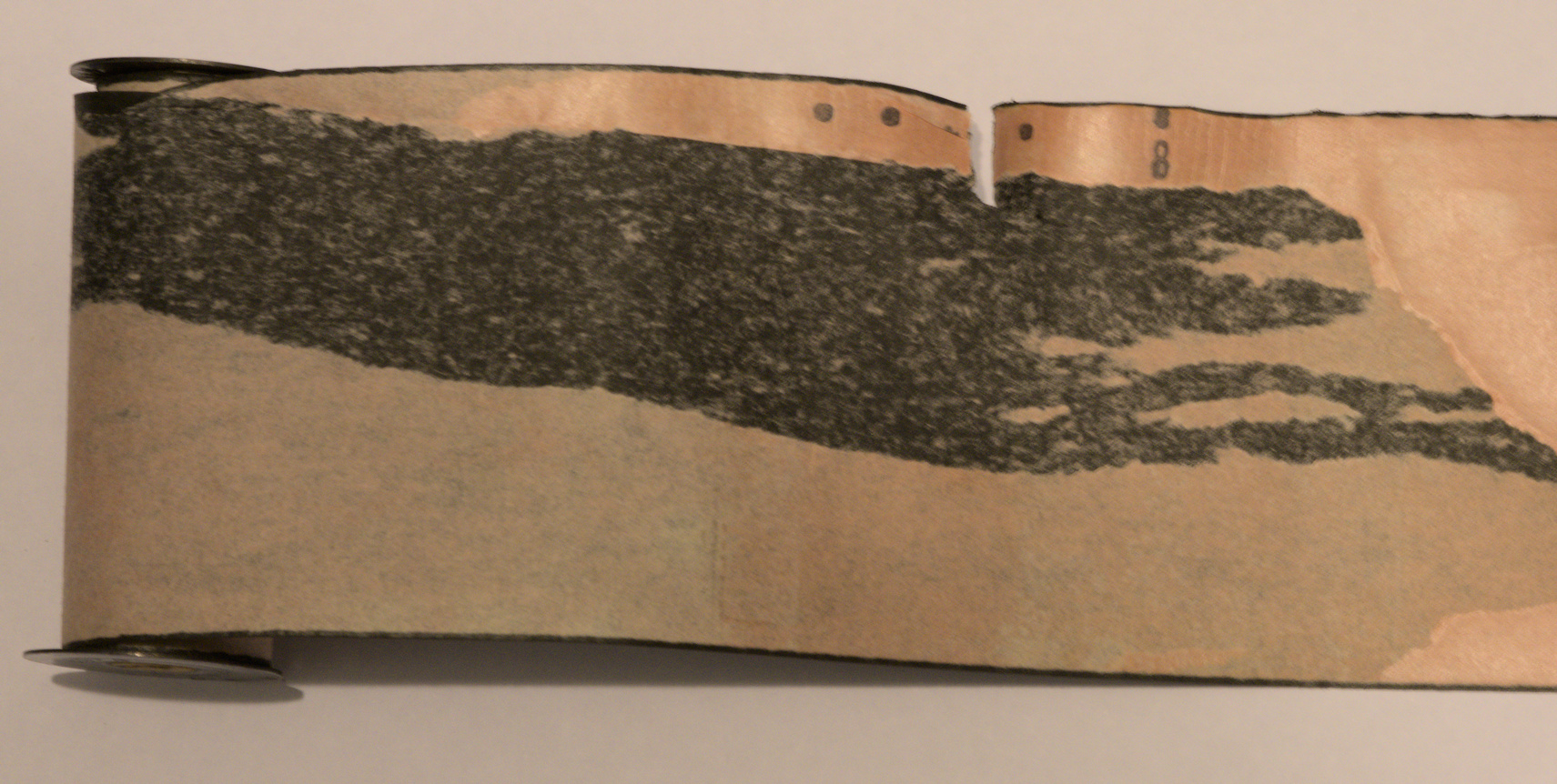

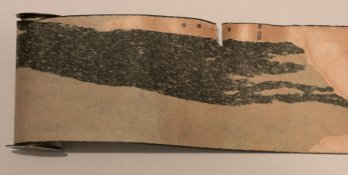

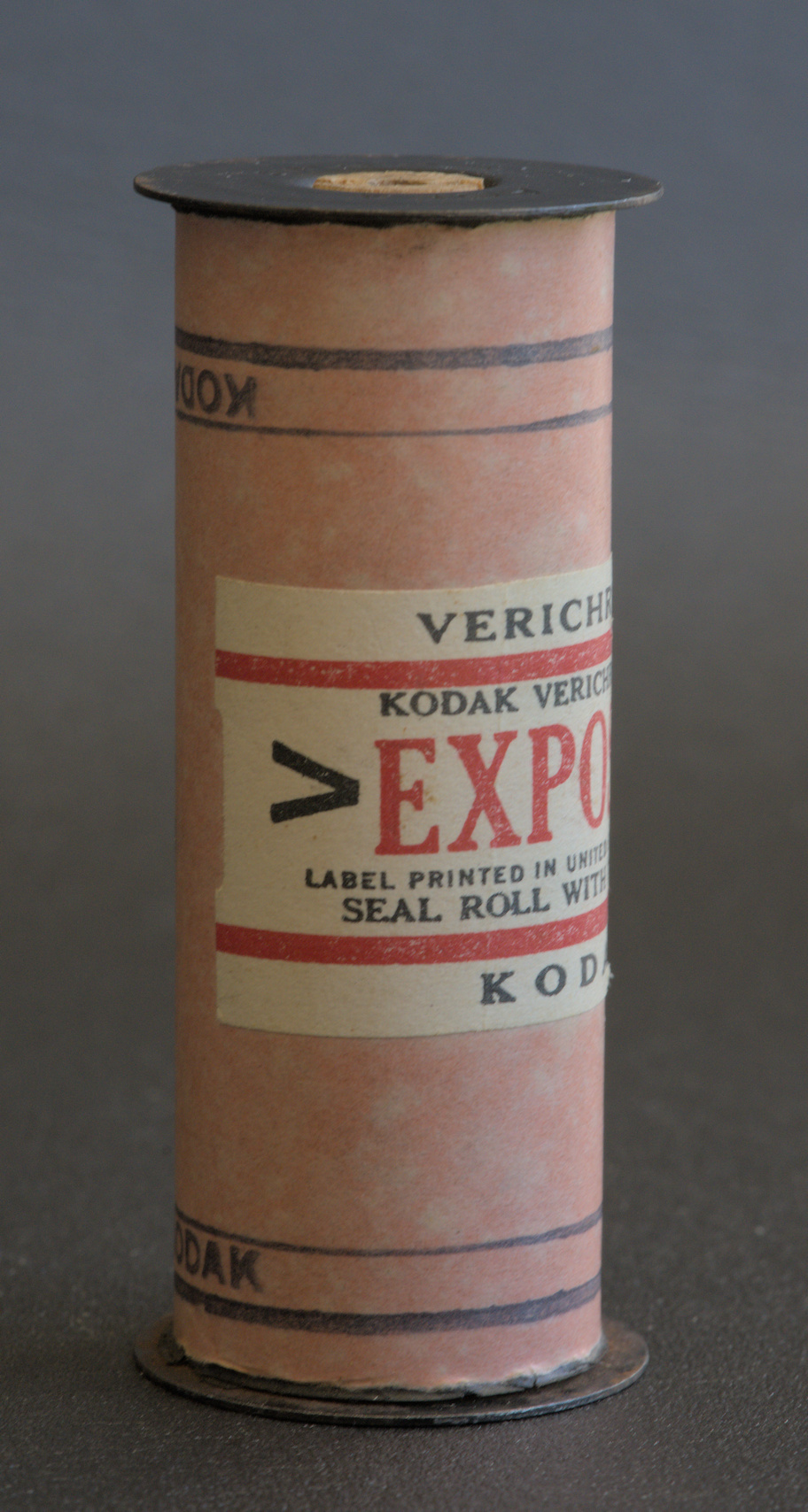

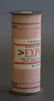

I started developing a roll of "found" Kodak Verichrome type 116, see pictures, and discovered two issues:
1) the film is damaged at the edges in several places (torn and folded) which prevents me from loading it into a reel. I tried a Paterson Major tank that accepts type 116 and a "Universal" developing tank modified for type 116, both with no success;
2) the backing paper is stuck to the emulsion for about a third of the roll.
My plan is to improvise a Correx style apron from a 0.5 mm thick vinyl and use it in my AP tank. Removing the stuck backing paper is a more challenging problem. I am considering soaking the film for several days agitating and changing the water once or twice a day. After that I won't be able to use Barry Thornton's Two Bath developer as the film will be wet. My next option is HC-110 at fridge temperatures agitating 4 or 5 times at regular intervals. The intent is to extend the development time without increasing fog levels too much.
I would like to hear your thoughts on how to proceed. I don't have access to a darkroom which further limits my options.
sorry to tell you this, but from experience of emulsion layers being stuck to things, I hate to tell you I have a feeling the stuck emulsion won't really want to release from the paper. emulsion sometimes does that, especially if it is old and was wound up on a spool and warm ( and who knows maybe it got wet or the environment was humid ) and the emulsion grabbed the paper: stuck is sometimes stuck. you might consider only soaking it for a few hours in warmish water with a mild surfactant like a few drops of photo Flo ( or similar ) maybe put the film that is soaking in a water jacket so it stays the right temperature, I would be hesitant of soaking any film (old or new ) for several days in any liquid. I have rolls of film that were new, exposed, developed and printed in 1985 that were stored in print file plastic sheets that got wet. the emulsion just turned to goop on and off of the plastic substrate.
good luck with your project!
Sad but true.
Gelatin is excellent glue. By the time you get it hot/wet enough (under red safelight or in total darkness) to release from the paper, it will almost certainly have released from the film base first.

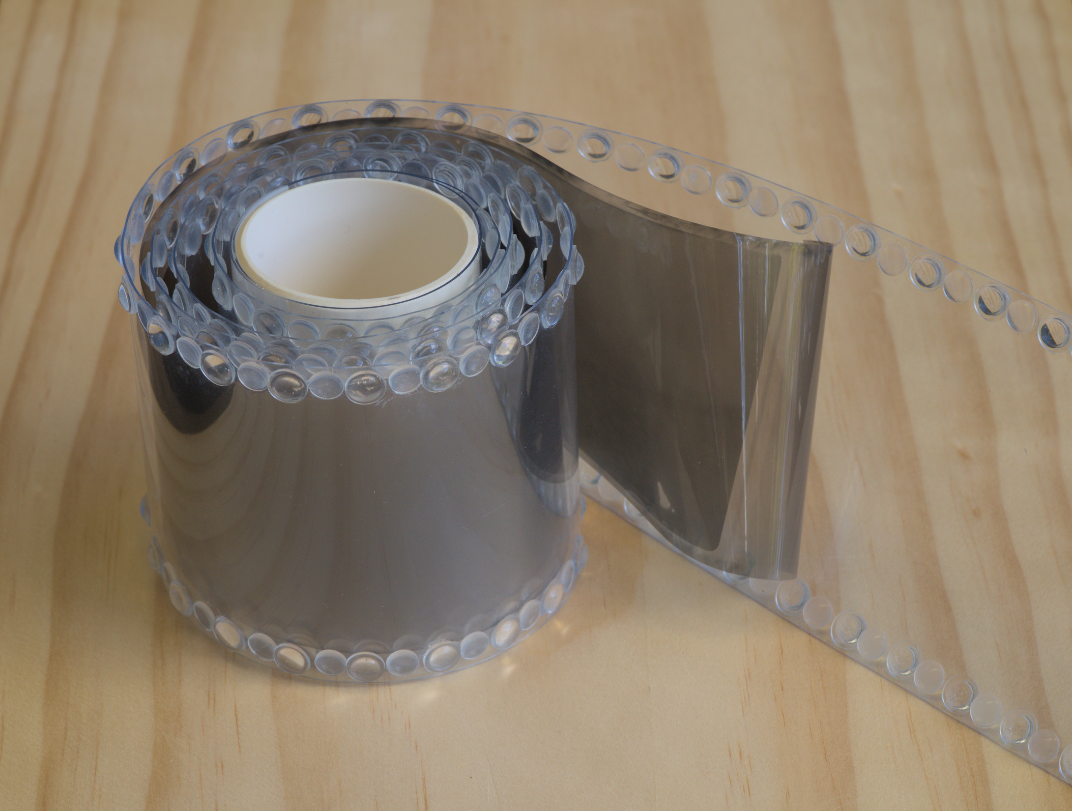

Here's an update on my progress.
I made an apron out of a strip of vinyl table cloth, polyurethane bumpers used for kitchen cabinets, a piece of PVC pipe and super-glue. Here it is with some scrap 116 film loaded:
The whole setup looks like this:

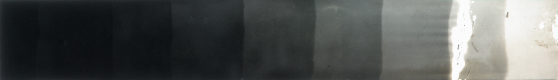

I abandoned the idea of low-temperature development and decided on HC-110 dilution B at 18 C. The test strip is below. The shortest time is 3 minutes and the increment is 1 minute. I want to err on the side of having a thinner negative so 7 minutes looks like the right time. Maybe, 7:30.
The artifact in the 4 minute band (second on the right) is where the backing paper stuck to the emulsion. I was not particularly careful while handling the strip so it came off, emulsion and all.
