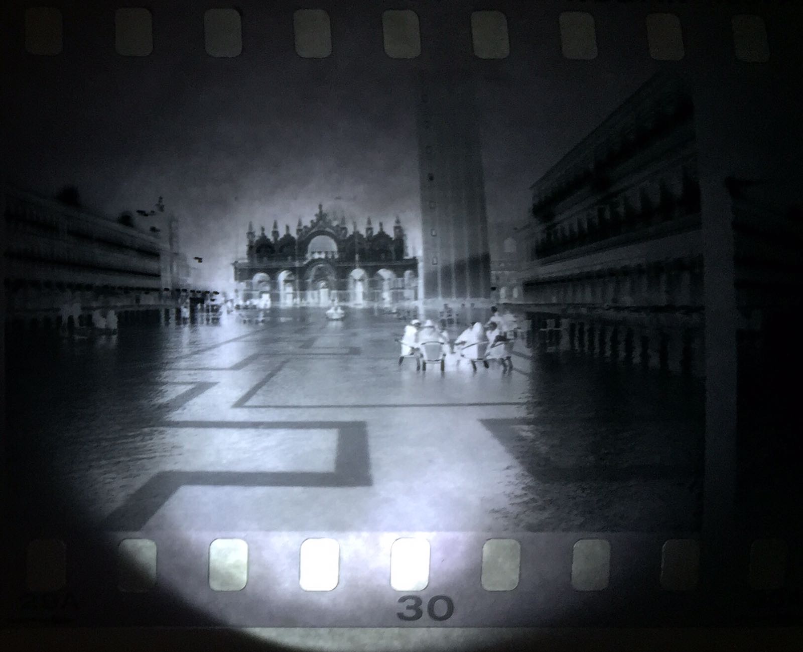

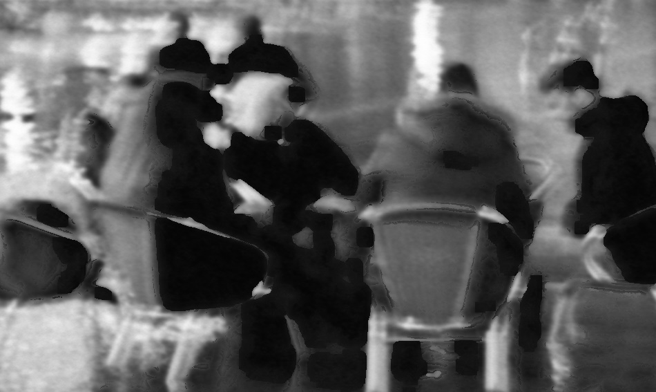

I'm trying to figure out how i got these negatives after developing with Kodak hc110 diluition "B" (1+31) @ 20°C for 6m 30s with agitations each 30s
As you can see the grey and dark areas, once blown out, seem without details, like someone used a black marker
I then scanned the negative on my Epson v550 using only the ICE dust removal technlogy. But seems that the problem is on the negative to me... although it might be also on the scanner? I really don't know :sad:
It has never happened to me with hp5 developed with Ilfosol 3 and then scanned
What has caused the problem and how can i put an end to it?
You can't use the ICE dust removal feature of scanners with standard B/W film. The silver grains look like dust to the scanner. Maybe that's your issue. Your developer time/temp/dilution combo sounds about right for Tri-X at box speed.
What was the lighting in the first photo? And how did you determine the exposure?
ICE doesn't work with bw films, you have to disable it. It only works with C41 and E6 films.
Turned off the ICE and now the scans are right! Thanks everyone :D
