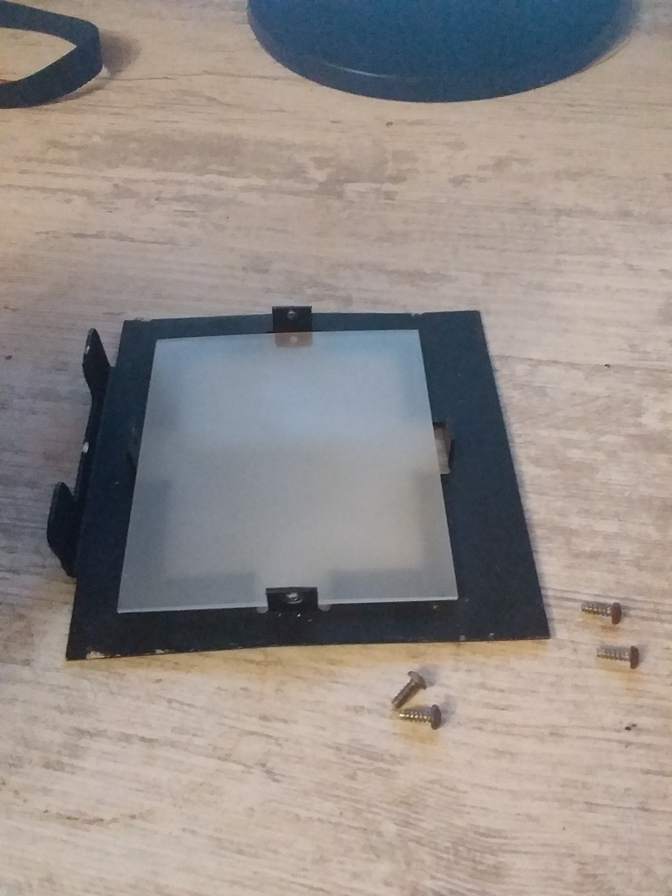

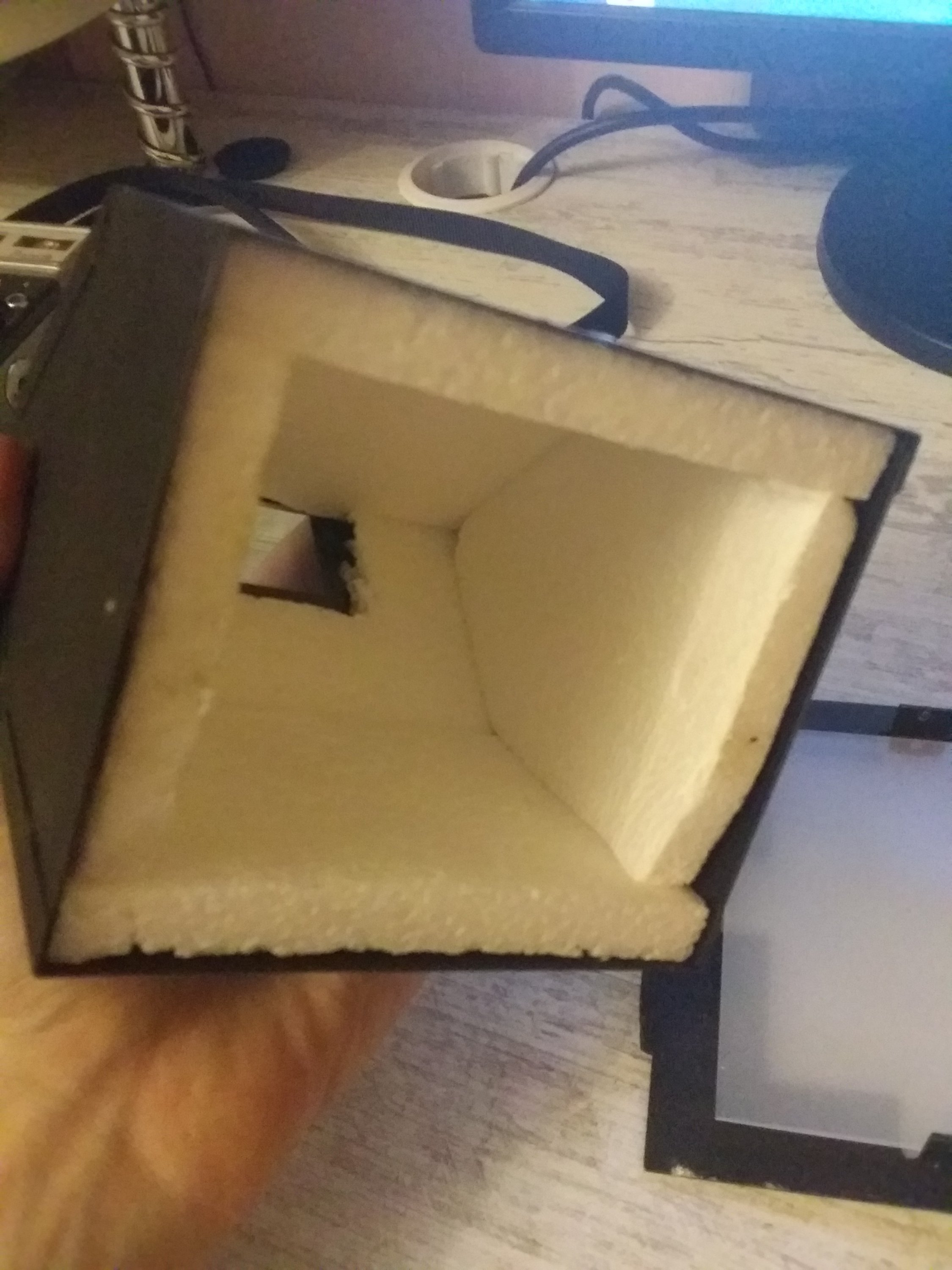

so is there any way to remake this 6x7 to 35mm. this how it looks like
The styrofoam liner in the mixing box has yellowed terribly with age and humidity and needs to be replaced. It's absorbing rather than reflecting most of the blue part of the spectrum your prints need. As already noted, there may be additional lamp issues, since your printing times are so ridiculously slow. Replacing it all with a modern colorhead would make sense.
