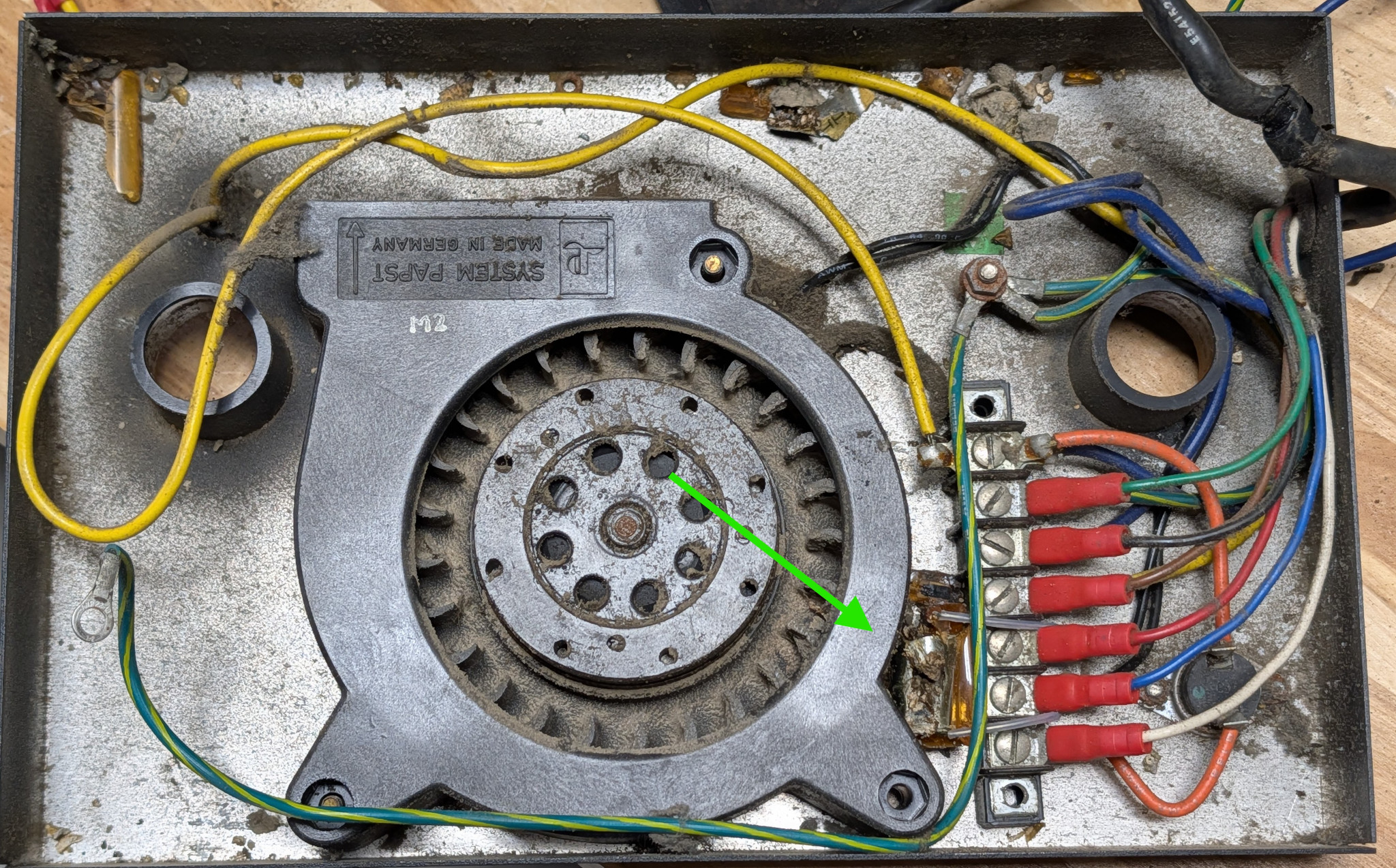

Do you have a photo of the location of the capacitor you can post?
Mike
Its in the fan tray at the top of the enlarger head assembly:
I apologize for how disgusting this area looks in the picture. My head is nothing but a pile of dust and rust, but I got it more for tinkering than actual use. I'm obviously going to do a little cleanup before fixing it.
I think you're on the right track.....it just looks like a filter across the motor.
