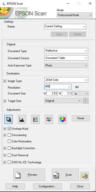

I have a Epson V600 which I have been using successfully for several years, mostly scanning old phots and some negatives and slides. I usually place between 2 and 6 photos of various sizes, preview, in thumbnail mode, reorient photos that require it and scan. A few days ago I suddenly was unable to scan multiple photos. The scanner itself appears to go through the scanning process of all photos (1 of n, 2 of n, etc.), but only 1 scanned photo appears in the the target directory. I reinstalled my scanner software, made sure that all options were reset, but nothing seems to work. Any suggestions?

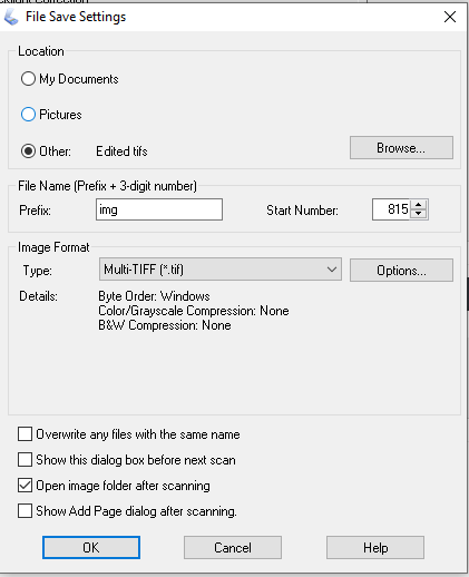

If you do not want all images saved into one file, then you shouldn't use "Multi-TIFF" format.
