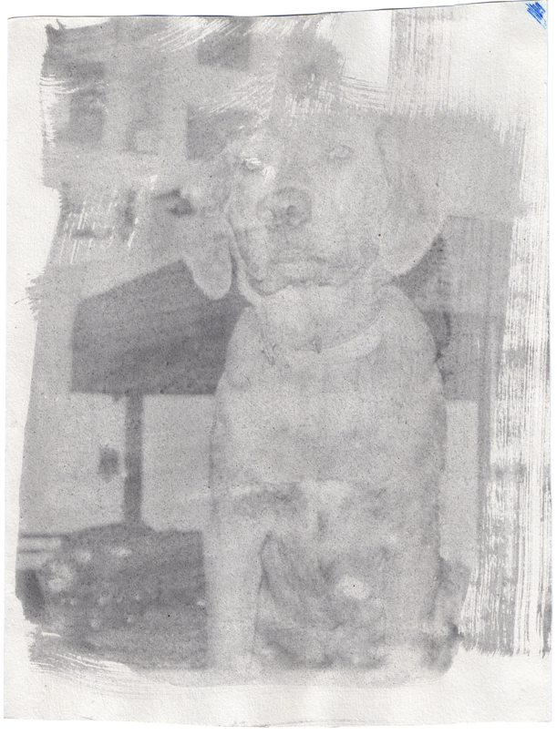

Hello everybody,
I've made a first real image; it looks very weak and it has low contrast but I am SO happy it worked. The process wasn't that difficult, and as it was mentioned I let it ripe for 30 minutes; I thought I would start at 30min and increase the next ripening time in order to compare the differences. The biggest problem for me is to keep the temperature stable. However, I've had a lot of fun with it. Bear in mind that it is only 1 thin layer of emulsion so I believe I will reach better results with thicker coating.
m.
Congratulations! Can't be sure, of course, but looking at your image, I'd say that a thicker coating might be all you need.
re temperature: If you start out with a couple of nested bowls, with the outer one about 5 degrees C warmer than the inner (waterbath) one you have your emulsion in, the waterbath temp will probably hold for the time you require. Make any adjustments to the outer bowl and your emulsion temperature will hold as steady and reliable as if you had an expensive electric water jacket,
Cute dog!
