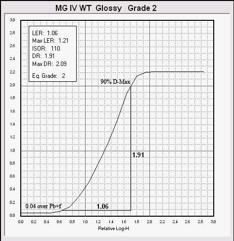

As I wrote earlier, the paper LER is determined by the log-H range between 90% of paper Dmax and 0.04 about paper base plus fog. Obviously, this doesn't cover the full range of the paper. The reason it is used is because they are two points of density that are distinguishable from Dmin and Dmax.
The two LER points is where S and H in the example below fall. A statistically average scene has a Subject Luminance Range of 2.20 This is what Normal development is based on. Like the paper, it measures what is considered to be the important points where tonal separation is generally desired. But it doesn't represent the full range of a scene as a scene frequently contains specular highlights and what the example calls "Cavity shadows." I usually refer to them as accent blacks. These will reach into Dmin and Dmax of the paper but are not part of determining the paper LER or Negative Density Range (NDR).

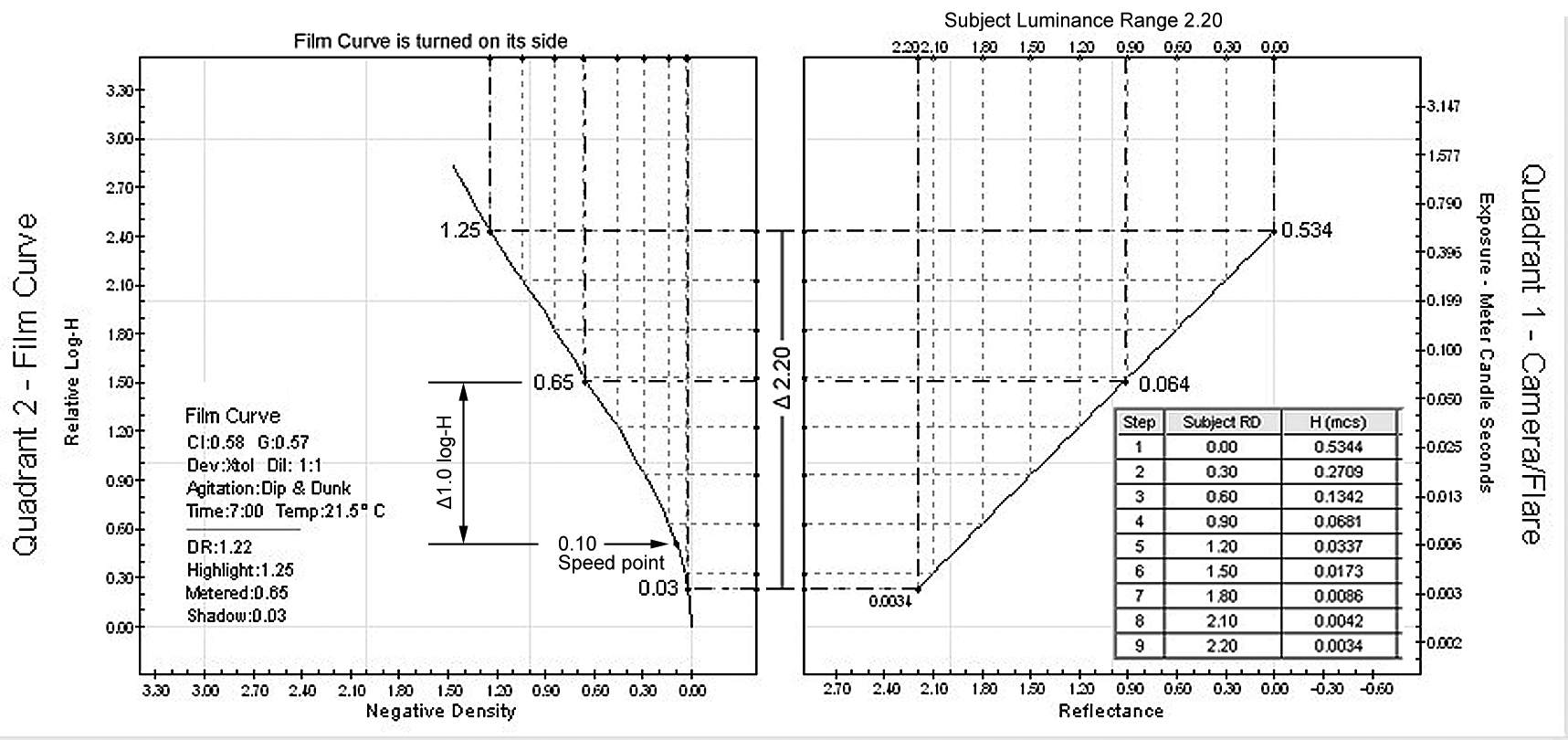

To determine the gradient of the developed film, take the Paper LER and divide by the Subject Luminance range - Flare.
1.05 / (2.20 - 0.40) = 0.58
Develop the film to an average gradient of 0.58 and you will get a negative with a negative density range of 1.05, excluding the density from the accent black and specular highlight. Side note: As the end results of photography are subjective, the LER isn't a hard and fast rule. It is simply a range that will produce acceptable prints to a higher frequency.
So you start with a scene having 7 1/3 stops and reduce it down to a negative with a density range of just over 3 1/3 stops if you want to measure Density in stops. This can get confusing using stops for Density.

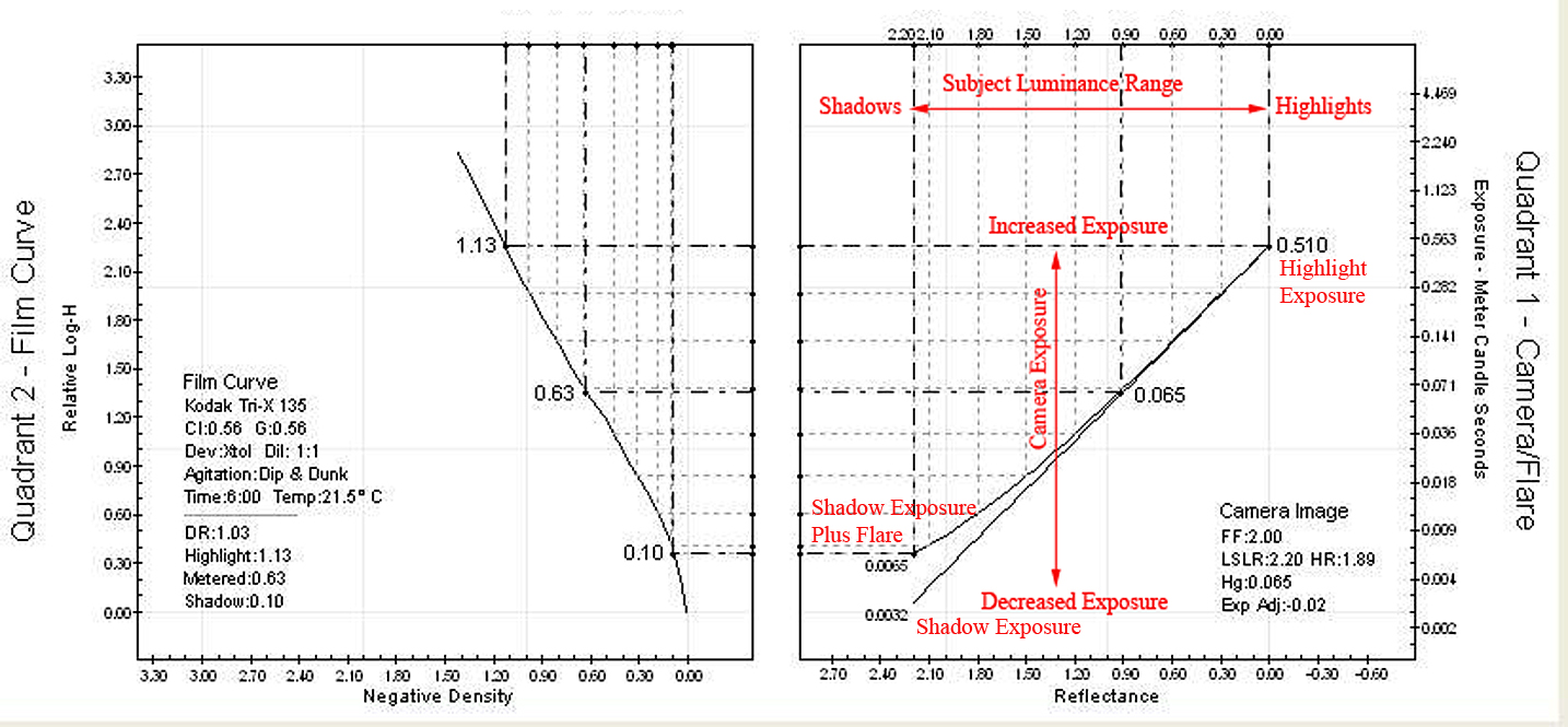

Two Quad with flare.

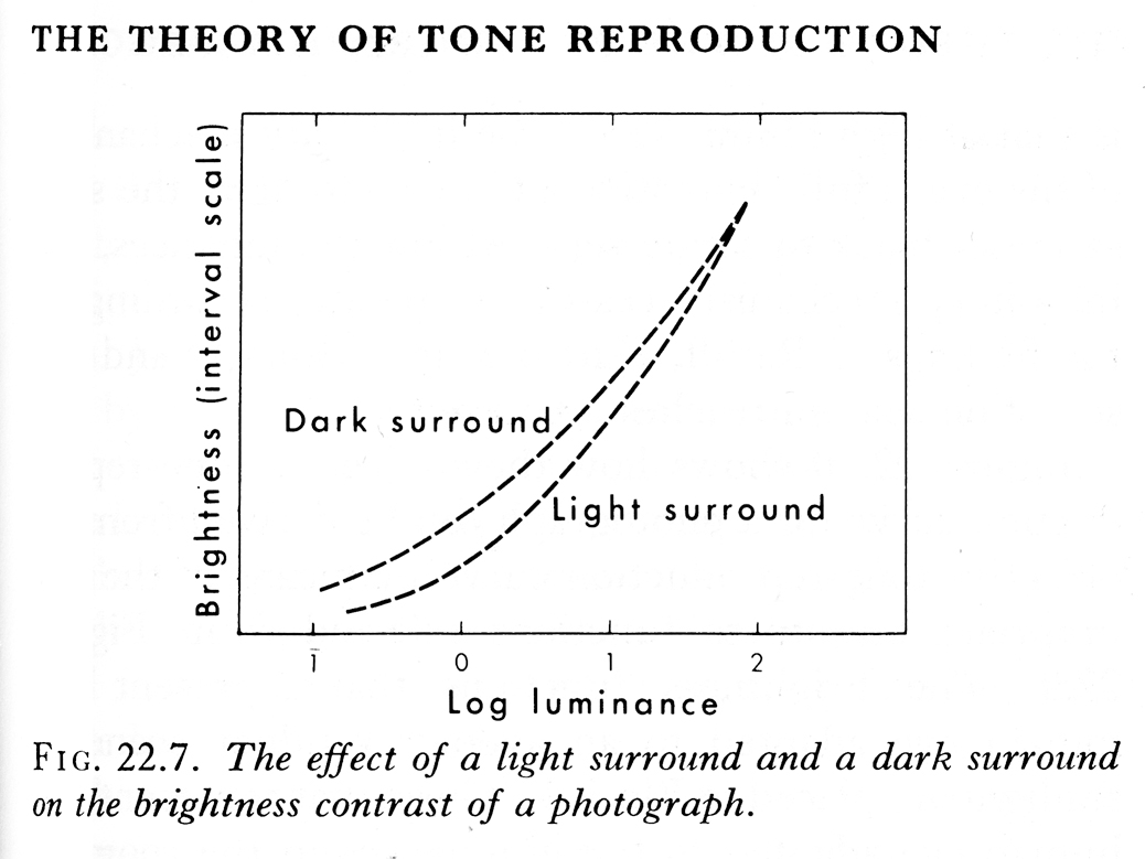

You place a value on Zone VII and it will look lighter if the surrounding tones are darker and darker if the surrounding tones are lighter.
Graph of dark and light surround.
And Inhibition and Adaptation. The value of the tones that surround and by how much.

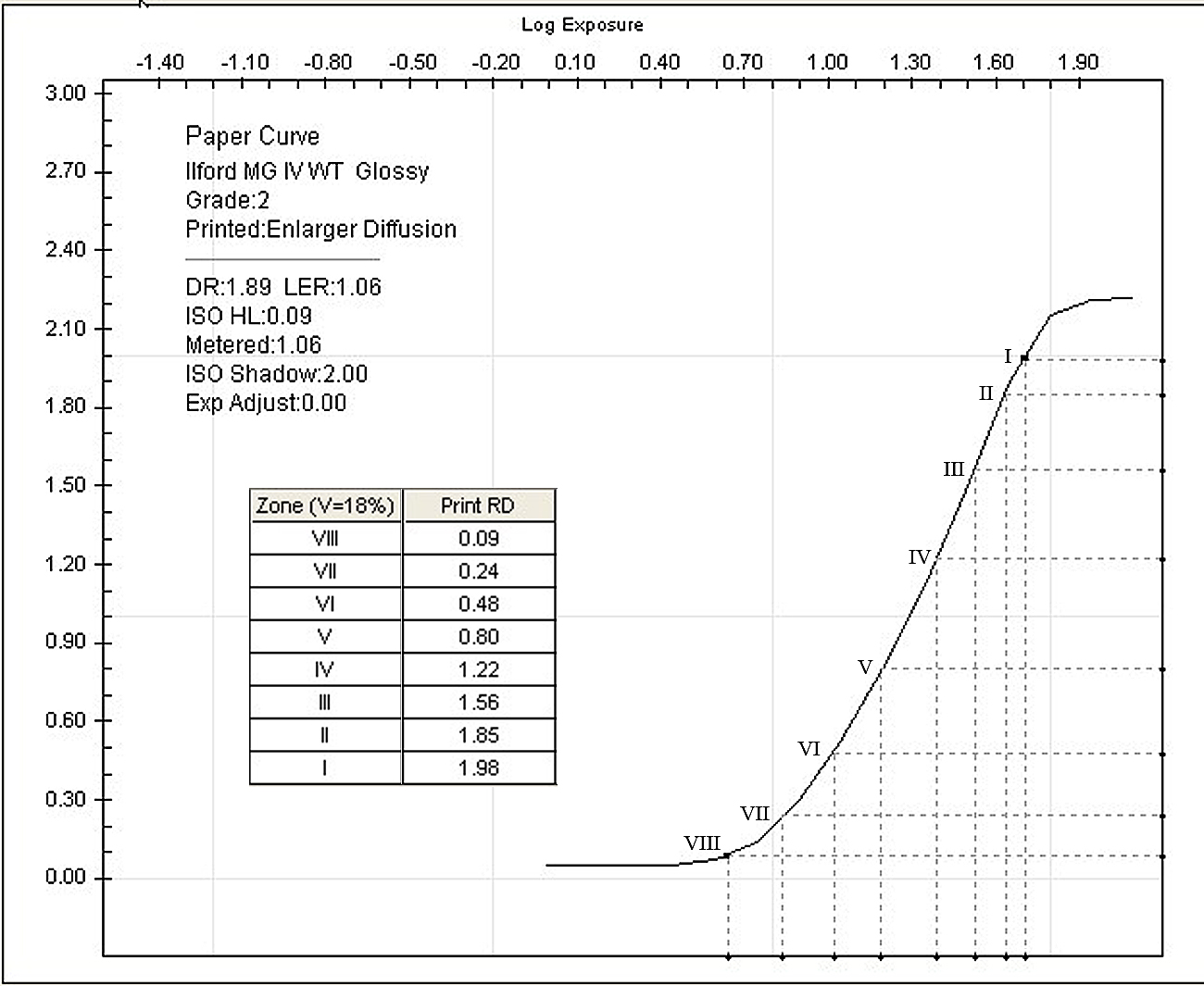

And now what print densities should Zone I, II, and VIII be. There isn't a set value. The type of paper (glossy or matte) and the photographic process used make a difference. Flare and the film curve also add to the mix. But keeping with a nice silver print, you can generally consider 90% of Dmax as Zone I and 0.04 over paper base plus fog as Zone VIII. It's the paper LER equation.
The placement of Zone II is dependent on the degree of camera flare, and the film and paper curve. The higher Zones are less influenced by flare and more by the film and paper curves. Here are Jack Holm's "Preferred" Zone value. Also something to consider, you can only see texture when it's a range and not a single tonal value.
Here is an example of how the Zones will tend to fall. Notice how the difference between Zone I and II is not as large in practice as is preferred.

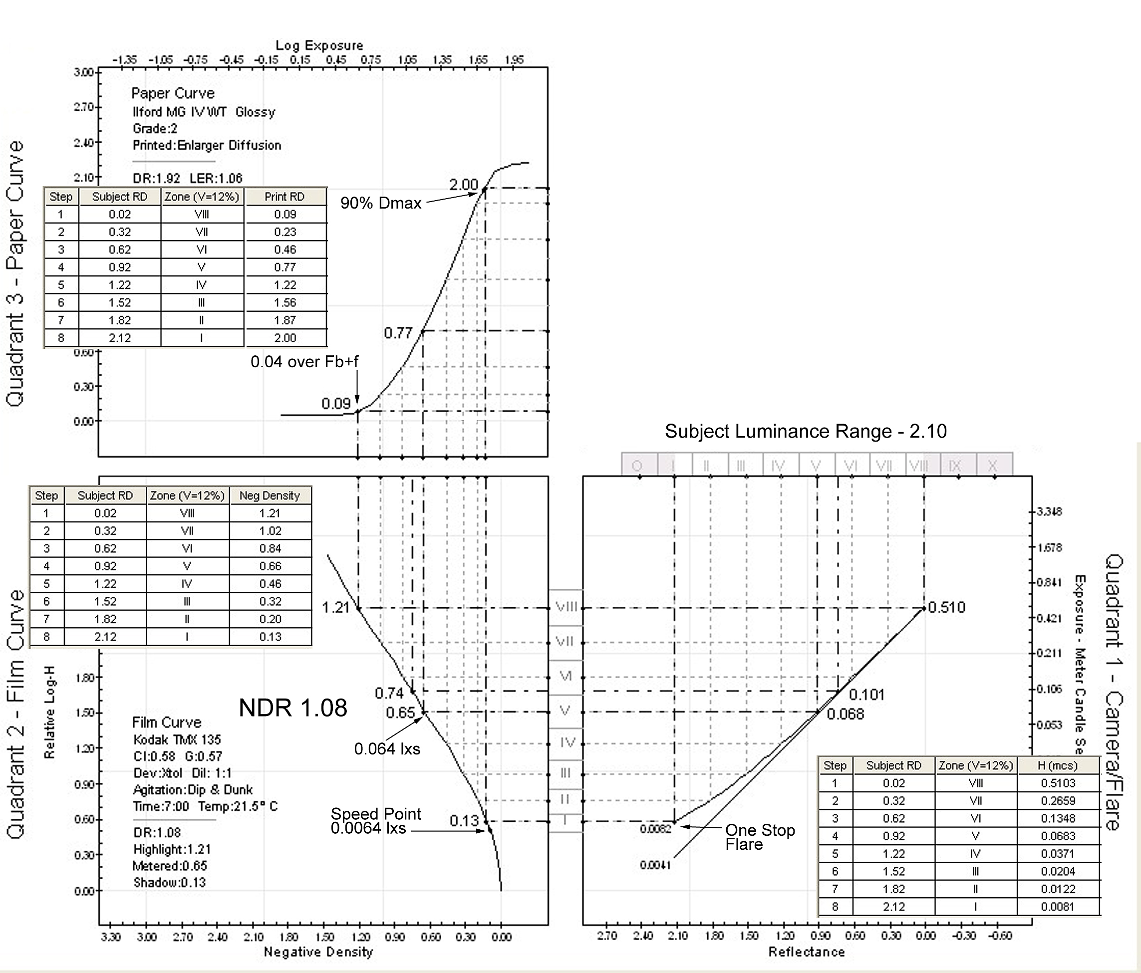

This example places the Zones in contact with a three quadrant Reproduction Diagram
I hope my brief comments and over compensation with graphs can help to point you in the right direction.

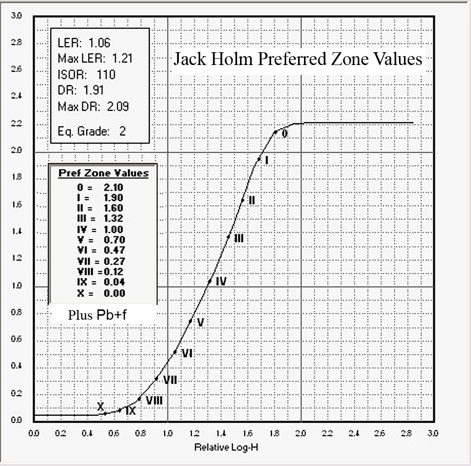

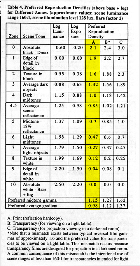

This might help some. This is the chart from Jack Holm's paper "Exposure Speed Relations and Tone Reproduction". For some reason Holm uses 128% for highlight Reflectance instead of 100% Reflectance. This might skew some of the values.
Where I see an important distinction is in Zone VIII not falling on 0.04 above paper base plus fog. 0.04 might be too light for a Zone VIII, but the difference of 1/3 stop range between the Zone System and statistically average ranges can account for a slightly darker value than 0.04 for the statistically average placement.
While you're at it, take a look at the Scene Tone notes for Zone 4.5 and 5.

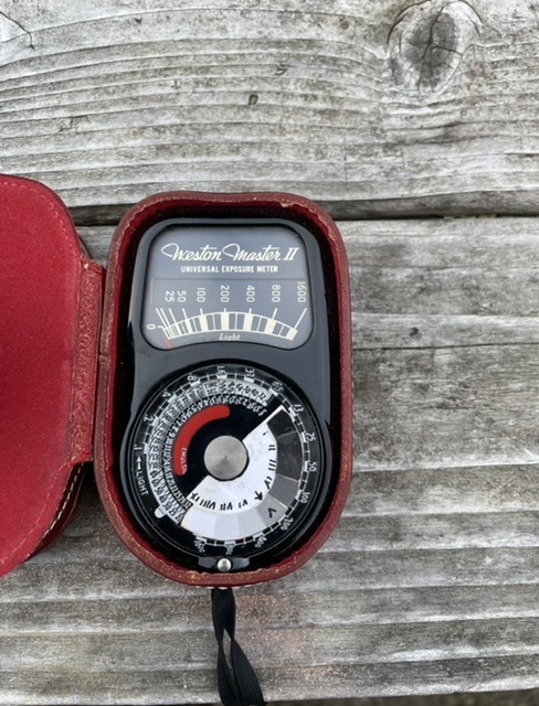

The compressed scale looks like what I use on my Zone System stickers for light meters. I make them up from actual test negatives printed on my enlarger. For me these show “WYSIWYG” (what you see is what you get).
I am often surprised what the needle says I would get on my print, mostly how quickly a scene in real life drops to shades of black.
Skies getting blown out are not as surprising.

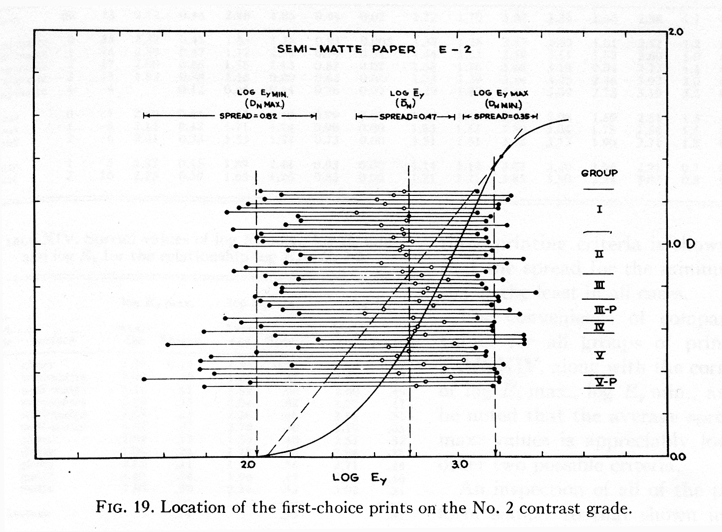

This example shows a paper curve with the negative density range from images judged as high quality superimposed.over it. We don’t know the subject matter or intent of the photograph, but in many cases, the negative density range exceeds or is less than the paper LER.
There are two basic rules that tend to accurately apply to quality photographs. They are lighter than the original. If the density range of the print matched the original scene, it would universally appear dark. The second is that viewers can accept compression of the highlights and shadows, but usually require the mid-tones to have a higher gradient that the original subject. Usually above 1.08.
Here is a four quadrant reproduction diagram. The fourth quadrant compares the original subject to the print creating the reproduction curve. Many reproduction curves have a reference curve that depicts a perfect 1:1 reproduction. Truthfully, I don’t believe Adams knew this let alone incorporated it into his scale.

I like Bill Burk's idea of taping the zones to the meter dial. Clever.

The graph of first-choice prints has many lines extending to the left of the paper-curve. I'll guess that some of those white areas were burned in the prints, moving them rightward. Likewise, some of the dark lines on the right were probably dodged, moving them leftward. These modifications make me suspect that negative density-range is not a good measure of the light-range that struck the paper. Nonetheless, I suspect the conclusions won't change: People like prints that are a bit lighter with high midtone contrast.

Thanks Mark, I think it’s a hybrid idea. Obviously based on Minor White’s Zone Sticker, but I got the idea of using real print tones from Phil Davis’ “Wonder Wheel” in an early Beyond the Zone System.
I don’t think when they did the studies they dodged or burned prints. The skies are probably just blank white in those cases.

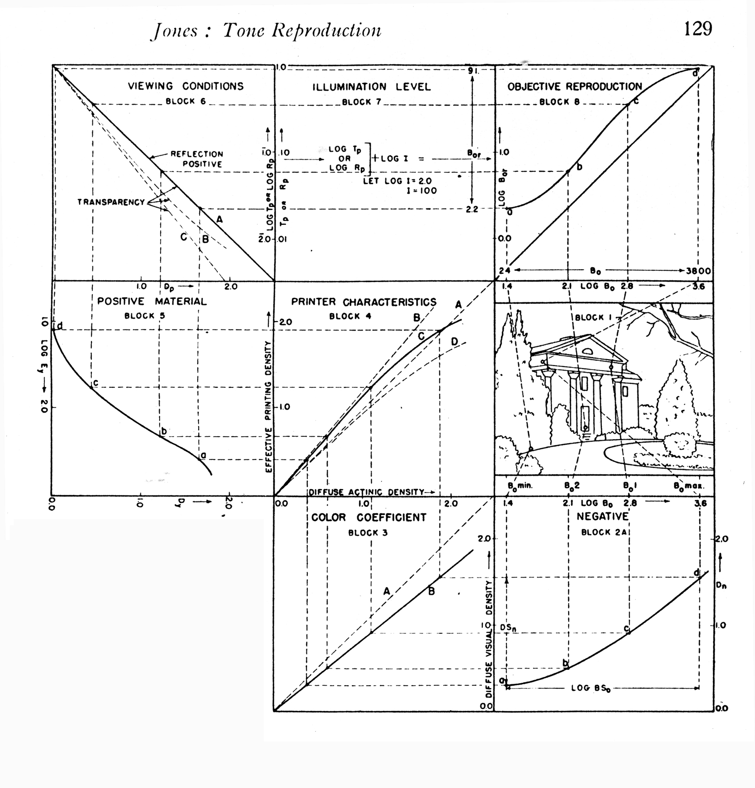

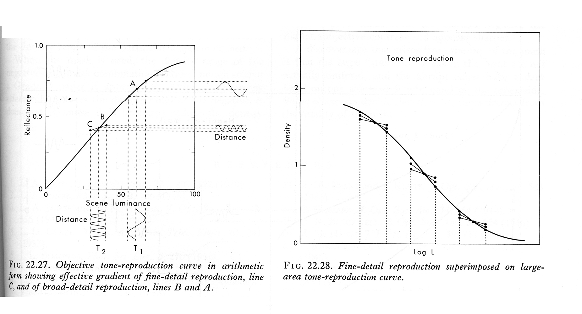

The number of quadrants can vary and easily increase depending on the aspects covered and what is integrated into a single quadrant or separated out into multiples. You may notice in the paper information section it refers to printing with a diffusion enlarger. The step tablet was enlarged and not contacted, so I was able to incorporate flare in the printing phase without an increase in quadrants. And since it was my enlarger under my printing conditions, it tended to apply to the results I would be expecting. With the Ilford papers, they are either from the enlarges where I used to work or from Herb Ritt's darkroom from when I consulting with his team. The more tests, the more examples available that fit more situations.
The Theory of the Photographic Process, 3rd Edition has examples of fine detail reproduction, effects of masking, and viewing conditions. It can get very granular and beyond my understanding.
Jones admits in a paper that there is no absolute correlation. We are ultimately dealing with a subjective experience after all. Even though matching the negative DR to the paper LER isn’t a perfect criterion, it is good enough to produce quality images in most situations, or at least with only a slight contrast adjustment. Jones made a large number of prints on different grades and exposures from each of around 170 different negatives (most are from the First Excellent Print Test). They were judged for quality from best to worst. The test wasn’t about creating specific criteria for paper grades, but to determine the best approach to objectively determine sensitometrically the paper grade that will consistently produce high quality prints. Jones concluded, “because of the influence of the brightness distribution and subject matter in the scenes photographed, an accurate prediction cannot always be made of the exposure scale (Log Exposure Range) of the paper which will give a first-choice print from a negative of known density scale (Density Range)… But what other course is there to follow? Either we must make the best of a somewhat imperfect relationship or face the prospect of having no criterion whatever for choosing the paper contrast grade.”
Jones also found “for the soft papers, the density scales of the negative (DR) should in most cases exceed the sensitometric exposure scale of the paper (LER), whereas, for the hard papers, the density scales of the negatives should in most cases be less than the sensitometric exposure scale of the paper (LER).”
Jones, L.A., and Nelson, C.N., Control of Photographic Printing: Improvement in Terminology and Further Analysis of Results, Journal of the Optical Society of America, V. 38, No. 11, 1948.
These two realizations are significant when considering the expectations and practicality of placing Zones. The thinking needs to be more in terms of tendencies and guidelines.
