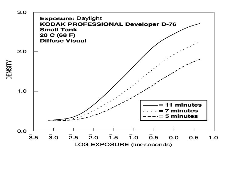

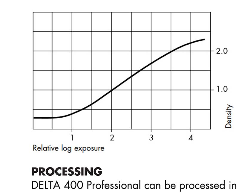

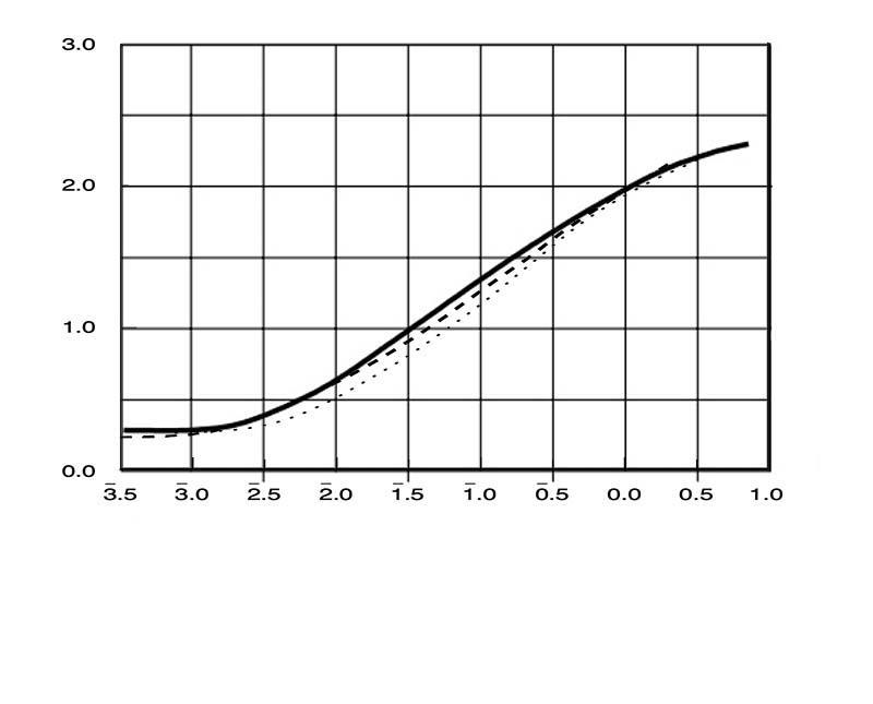

Why does Ilford graph their exposure from 0 to 4.5, and Kodak uses -3.5 to +1.0?
They seem to be showing similar information with differing zero points on the horizontal axis, but why? Is one "correct"? I'm trying to compare films and this isn't helping.

Because one uses a relative scale and the other an absolute scale (w. unit).

Both are correct on different scales. Ultimatum noticed that they both plot density over 15-stop range. So they can be compared with admittedly it's a bit confusing at first.

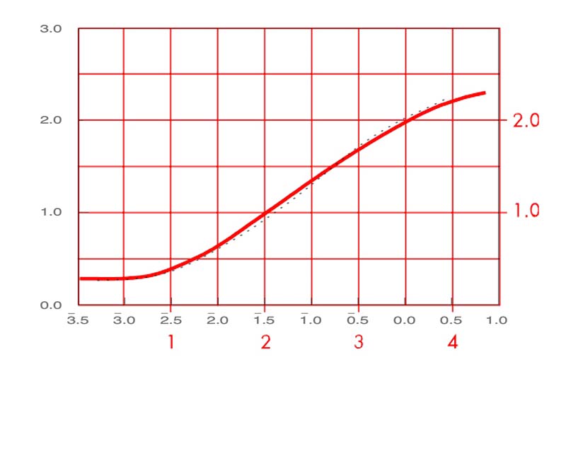

Here's another way to look at it, highliting the matching Y axis and possible mismatch of the X axis. This is Plus-X and Delta 400 superimposed. Delta 400 is red. Plus X is greyed. Because the manufacturers graph differently I'm not sure how much relevance there is in comparing brand to brand.

Kodak's graph is in actual units of log exposure in lux-seconds, and has minus signs (because one lux second is a significant amount of light). One unit in log space means 10x as much exposure.
Ilford thought the minus signs might be confusing so they added a constant, meaning their graph is in log(relative exposure), not in a specific unit like log (lux-seconds).
For amateur photographic purposes they're the same thing, just shifted by a constant. You only have to worry about the relative/absolute difference if you're trying to do calibrated absolute photometry.
Different films, in different developers, will have slightly different curves. To align the curves you would need to pick a standard density to align them (like "0.1 above film base + fog"). Then you would have to address the question of whether these curves are useful to you, or should you get a densitometer and measure your film, the way you process it, because your curve may be a little different from the manufacturer's standard.

Ok that helps, but Ilford's graph is "relative" to what? I'm confused. :smile:
Each mark relative to the others, all differing by same value.
To make things more easy to read, Ilford deliberately put their mark "1" at the exposure that lifts the curve just by the decisive level above minimum density. And from there you go with the other marks.

Not a dumb question, a perfectly good one!
Ilford's graph doesn't state units like Kodak's does. So the exposures it relates are relative to the far left of the graph, which could be labelled '0' on the X (horizontal) axis. Ilford's graph is also logarithmic (but unstated), so if the far left of the graph is one unit the 1 tic is 10 units, the 2 tic is 100, and 1000, 10000 successively.
The origin of Kodak's graph is "ten to the minus 3.5 power" in lux seconds which might be a little different from Ilford's "one unit" of exposure. To best compare, you probably want to match up the middle straight line parts, or match the curves at a low exposure point where they give approximately the same density.

In this image I think I've done what you and Michael suggested, by moving the Plus-X curve to the left so it takes off at about the same point as the red Delta 400 line. And this does seem to show that the characteristic curves are pretty similar between the two, at least with the developers, temperatures, and times that the respective companies were using to make these curves..

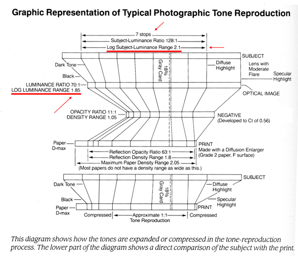

Using Stops along the X-axis isn't much different than relative log-H. Using anything other than Density along the Y-axis can be problematic because while a Density of 0.30 is equal to one stop, the average gradient for a normal
Subject Luminance Range is about 0.58. A stop exposure for a film developed to an average gradient of 0.58 will have a Density difference of 0.16 or 0.17 for each stop exposure.
There's no rule against stacking different references. Here's a Kodak diagram that does just that.

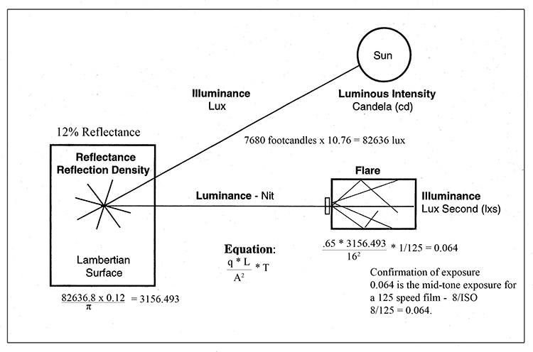

f/Stops along the X-axis would be confusing. F/Stops are part of an equation. Log-H is how much light strikes the film. For this to happen with f/Stops, you will need to know the Luminance, camera shutter speed , and the constant q for thespecific optical conditions. This means you will need to apply the camera exposure equation to each value along the X-axis. Since sensitometry uses sensitometer and not an optical system, you don't need to incorporate any amera variable thus eliminating many variables that can unknowingly influence the results.

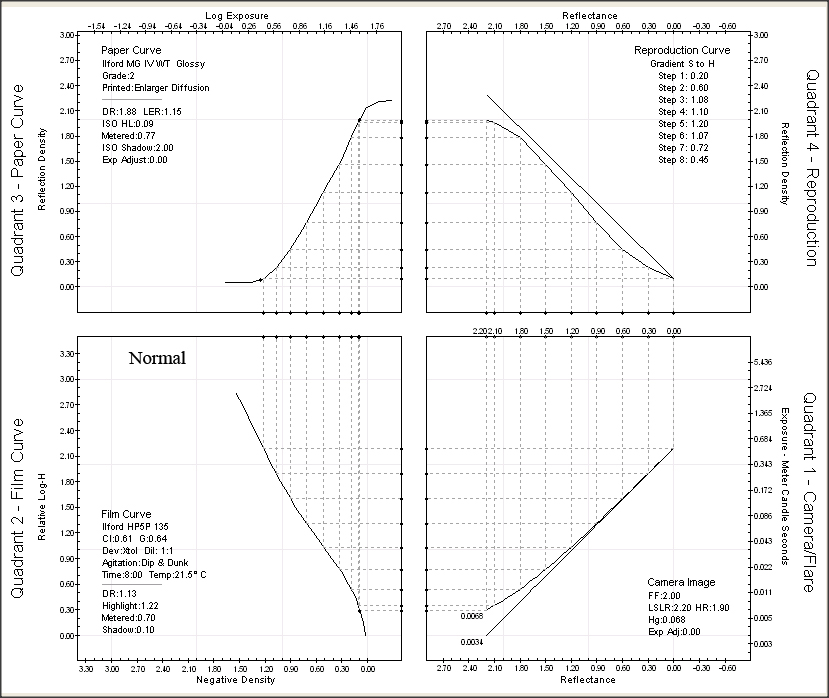

Finally, logs work for all areas. An example of a four quadrant reproduction diagram:
