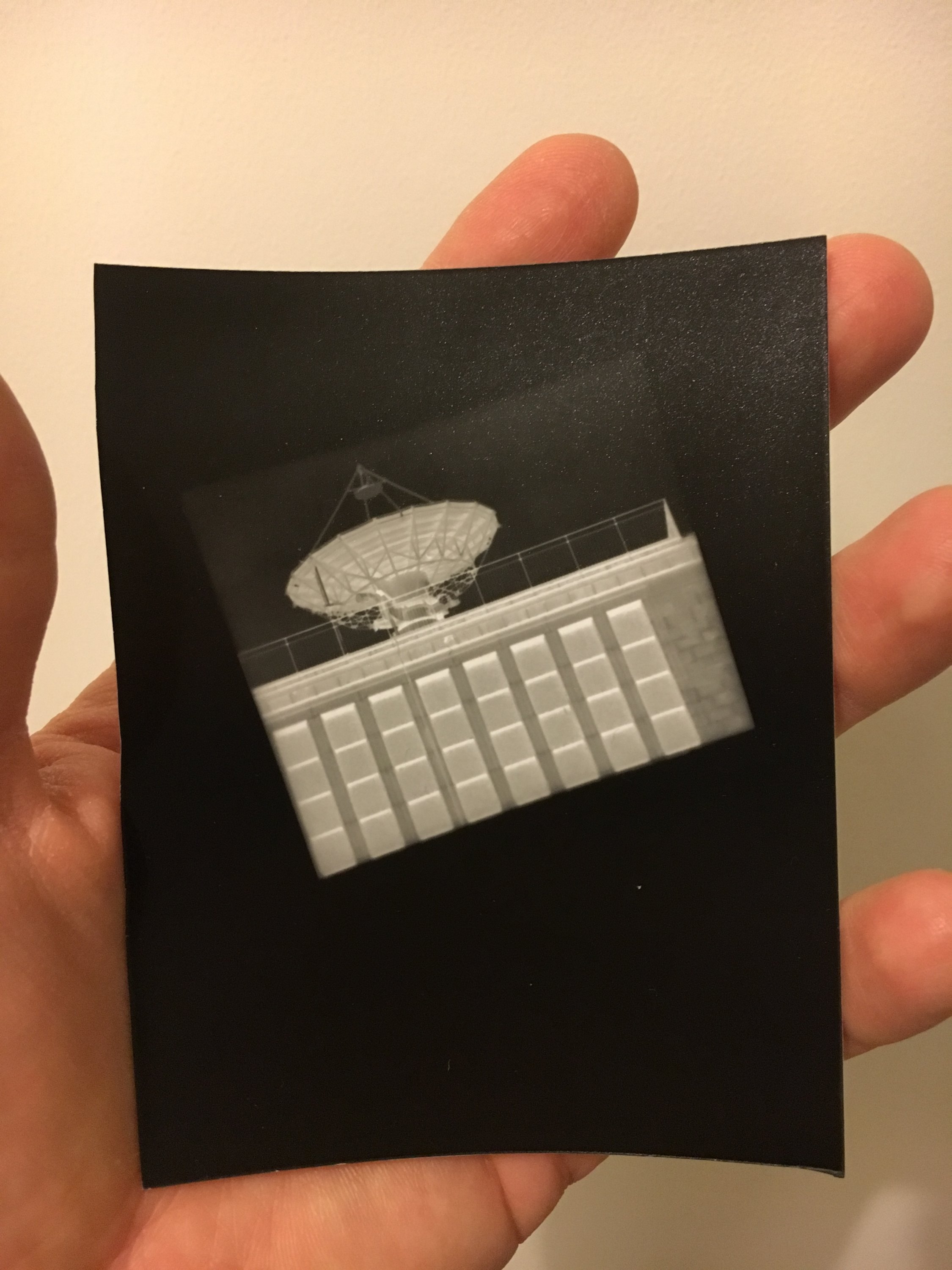

Thanks everyone! I just put two together, emulsion to emulsion and voila!
I think I’ll try the wet method as well as I’m curious!

there you go! That looks cool!
And adelorenzo is right, that image would look neat solarized. The simplest approach is to expose your positive as usual under the enlarger, and then when it's been in the developer for about 1/2 the time turn on the lights. Lots of variations possible depending on when you turn on the light and how long...

Woaaa! That’s sound exciting! I give it a go today! Do you have any recommendation for how long should I turn on the light as a basic? I know that it depends on a lot of factors but still. I’ve dim light in my room anyway. A few seconds or a bit more?

Start with 3 seconds and see what you get. If you get little to no effect, it's too short. If the entire print turns dark/grey after the exposure, it's too much. I found that in my darkroom (pretty bright light) I cpuld not get the exppsure short enough so resorted to shining the dim screen light of my phone on the print for about 5 seconds. So I'd suggest giving it a go with a pretty dim light and not the normal light in your darkroom as it is likely to be way too bright for a decent amount of control.

you can all get really kind of fancy about doing solarization...
use water instead of stop bath and take a flashlight and shine the flashlight in the water bath when you are rising it, or
you can take the print out of the water bath put your negative back on it all lined up, and put it under your enlarger and
selectively expose different areas of your print. its a trick i sometimes do if i have a super hot (white) area in a print that refuses to "burn"
and get tone, i just solarize the tone in there. its kind of fun :smile:
