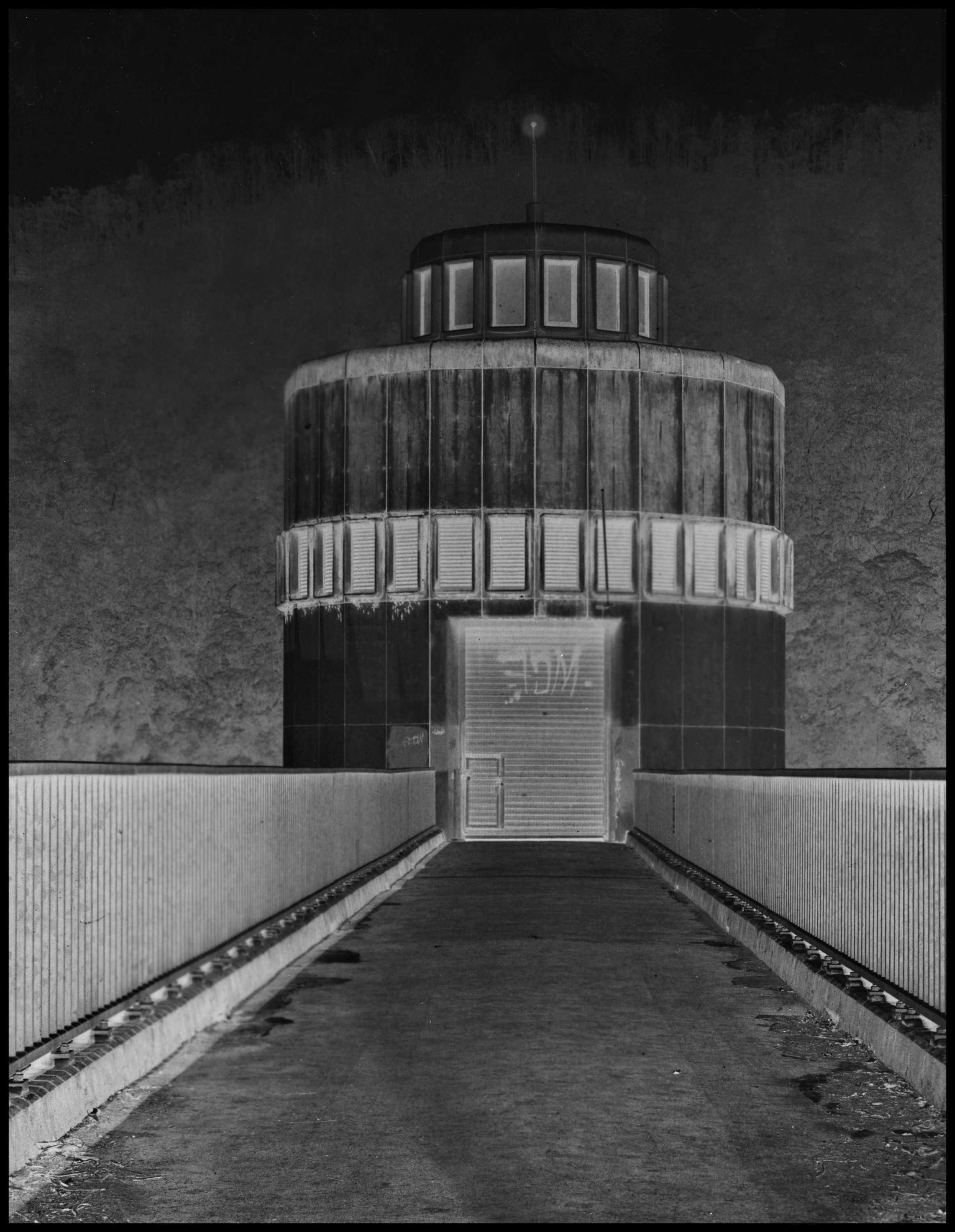

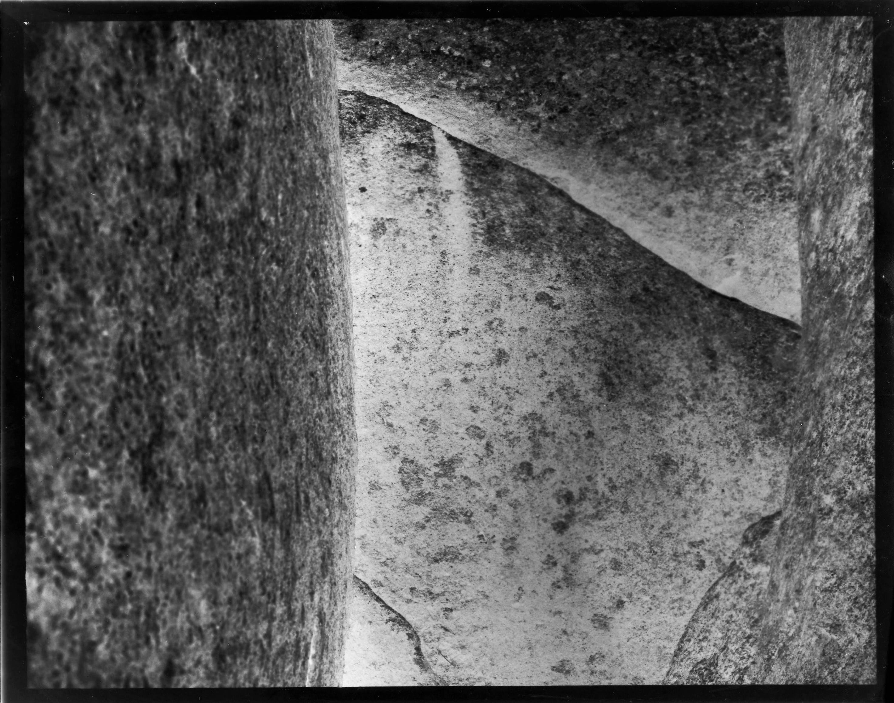

I have made a few negative prints by first making a positive and then contact printing to make a negative using ordinary ilford rc paper. Trick is to make the first print at least one grade lower in contrast than what you want the negative print to be and to do all your dodging and burning on the first positive print, for ease.
These are 8x10 prints made to be negatives.
View attachment 238915 View attachment 238916
Okay, so the new one should be a normal paper. First I was confused a bit.
