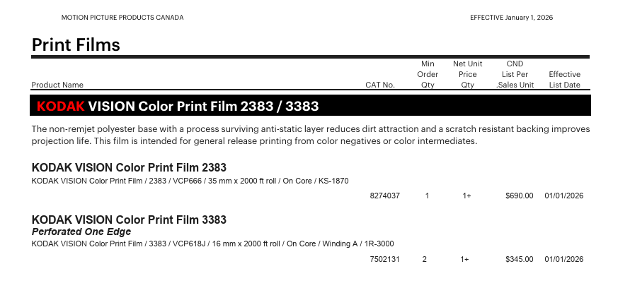

From the Canadian motion picture film catalogue (prices in $CDN I believe):
Here is the link for the US catalogue: https://www.kodak.com/content/pdfs/motion/Kodak-Motion-Picture-Products-Price-Catalog-US.pdf

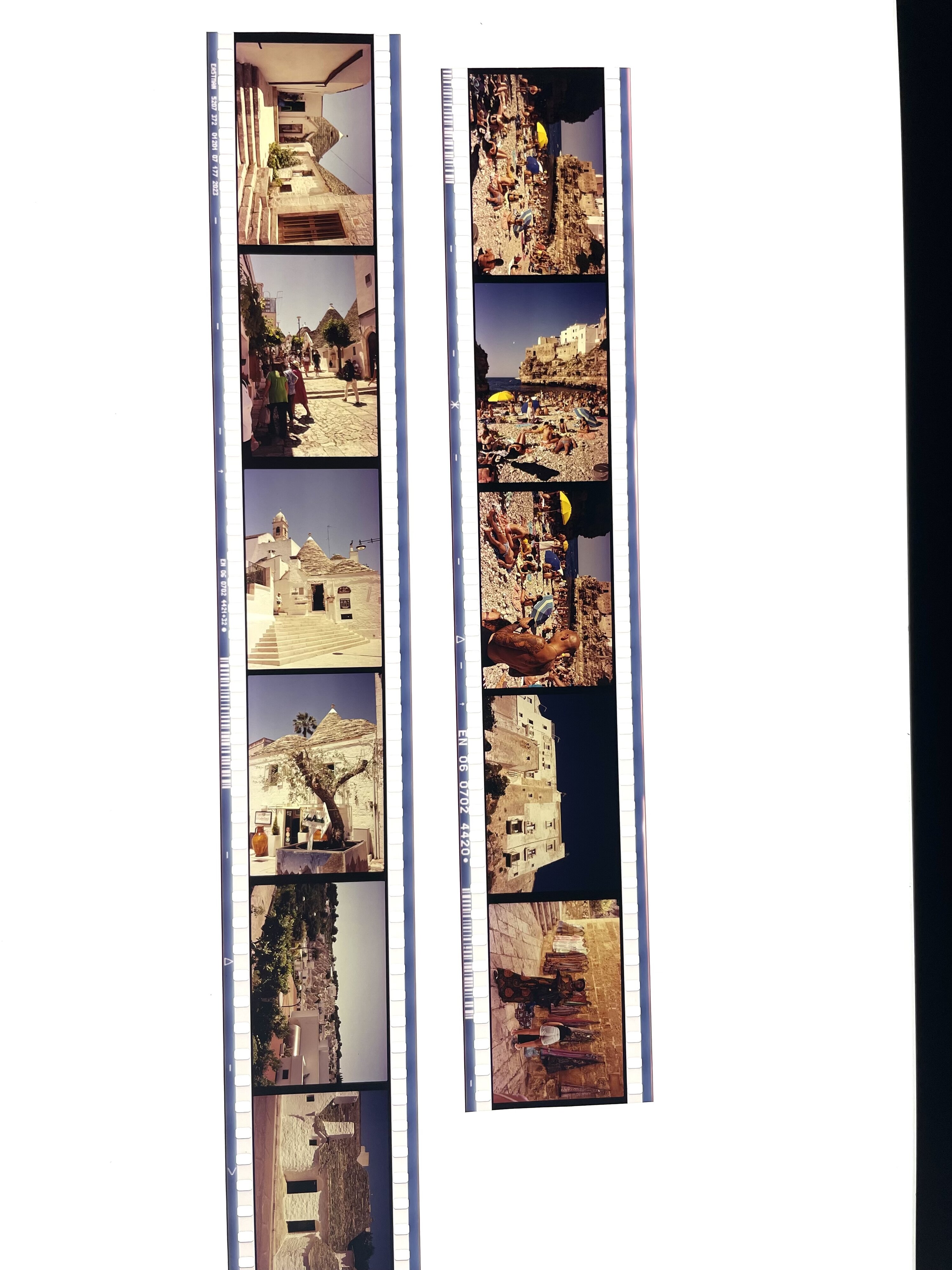

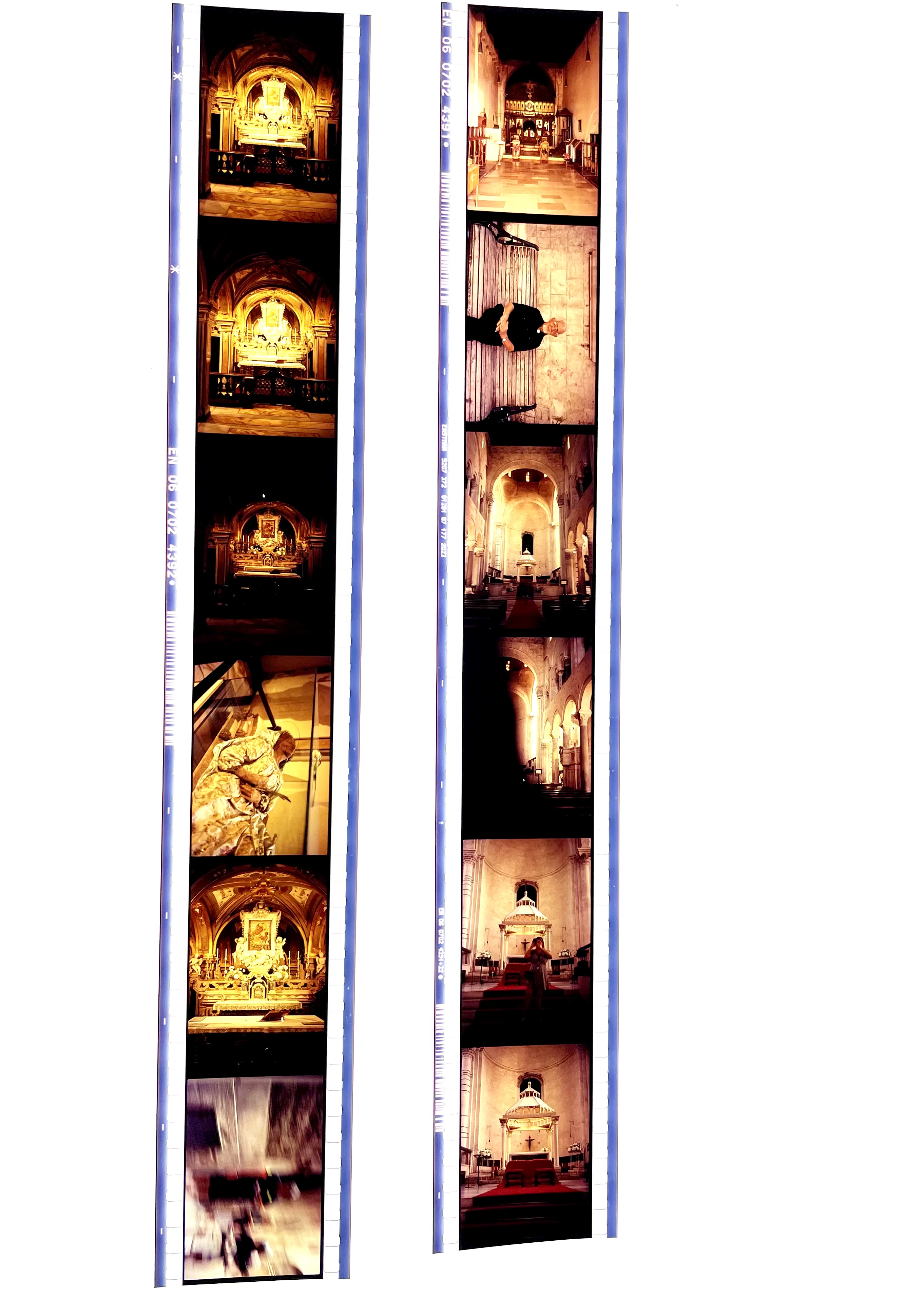

I do this regularly in Poland at WFDIF. The negative is contact printed onto film a duplicate.
  • KODAK-VISION-Color-Print-Film-2383-3383-data-sheet.pdf
Nice results. Which films do you use for your negatives and prints? I take it you use an enlarger and contact printing frame. Do you achieve better exposure latitude than using slide film? What about color accuracy? I was thinking of making slides from my negatives both to make slides out of old and new negatives and to achieve better exposure latitude for difficult scenes than I could with just slide film. I take a lot of pictures of classic cars at concours which are usually held in open fields with strong sunlight, making for highlights too bright and shadows too dark for slide film even with strong fill flash.
The attached photos show the film used to make the positive print. It's Kodak Eastman 5207 emulsion (Vision3 250D). I'm also curious what film @adamlugi used to expose in the camera.
WFDiF is an abbreviation for the Polish name "Wytwornia Filmow Dokumentalnych i Fabularnych" (Documentary and Feature Film Studio)
It is a state cultural institution https://en.wikipedia.org/wiki/Documentary_and_Feature_Film_Studios
Uh, no. 250D is a masked color negative ECN2 recording film. Any print made on it would have an orange mask; it could never be clear. We're looking at contact prints so we are seeing the keycode of the original camera capture film here.
OK, I get it now. So the photos were shot on Vision3 250D, and the emulsion code was contact-printed onto the duplicating stock.
Thank you for the explanation @koraks 😀👍
You got it! So part of the question is answered (i.e. original recording was on 250D), but the question of the print stock remains.
I'd like to add that I really like those positives although they are rather heavily biased towards yellow. However, given how time-consuming it likely is to make these, I can very well imagine why one would accept some degree of compromise w.r.t. color balancing.
Some time ago I used to see quite a few eBay listings for respoolled 2383, but I never bought any. Now… there's simply none. The European catalog states that the minimum order for both 35mm and 70mm is a 2000-foot roll, and for 70mm the price isn't even listed.
There's probably little chance with 70mm anyway (the format itself is a bit odd - the frames are actually narrower than 65mm), but they might still sell the 35mm.
The policy of selling only to production companies might be possible to work around, since print film is designed to compensate for the color mask of the negative stock, so shooting it in a still camera doesn't really make much sense anyway.
But 2000 feet is a lot of film… just to experiment with.

In this case it was Vision 250, but I have also done it with 50D and 500T. Regarding the colors, you’re right – they are not perfectly accurate. They appear slightly warmer than the negative that I print in the enlarger. The lab technician suggested exposing a certified Kodak grey card, which should improve the color accuracy. Each frame is exposed individually, but the films are spliced together. For example, in one “roll” there may be about 15 pieces joined together. I will look for the codes of the positive films and send them .
