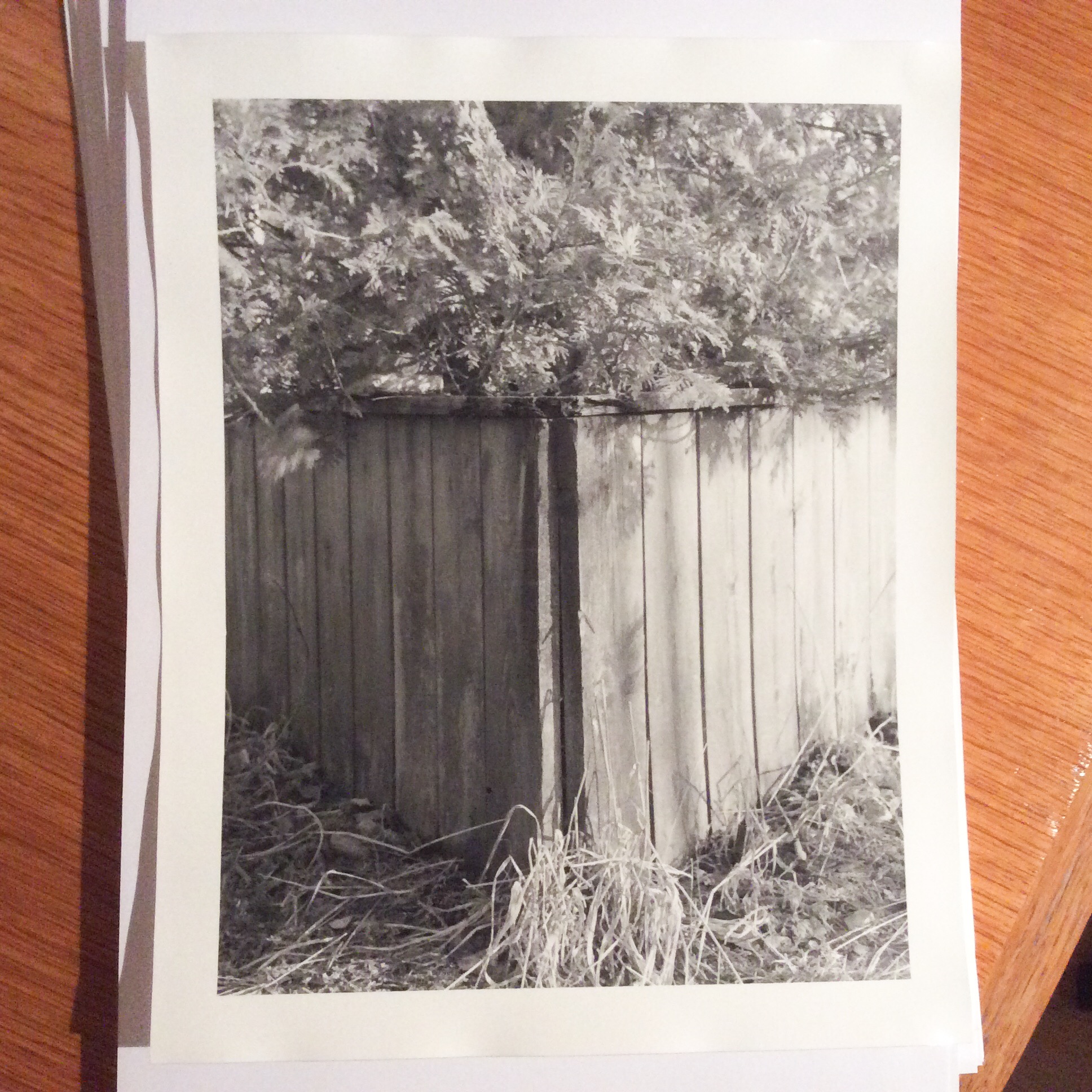

I shoot 3mm, 120 [6x6] and 4"x5". I have a few 35mm negatives that have made stunning 24"x36" prints, but those are rare. I have made many large prints from 6x6 and 4"x5" and those are much easier to make than with 35mm. The improvement from 35mm to 6x6 is greater than 6x6 to 4"x5". I have more choices of lenses, for myself, in 6x6 than 4"x5" and yes I could buy more lenses for the 4"x5" cameras. I prefer the flexibility and lens choice in 6x6, especially the rectilinearly correct SWC, over 4"x5". I have rarely needed the shift and tilt capability for landscapes. I use a fine grain developer, replenished XTOL, and Tri-X film for black & white and Kodak's Portra, VividColor and UltraColor 400 speed films for color negative work for prints from 11"x14" to 30"x30".
Nice! I also have a couple of 35mm negs that have printed well at 16x20,but they would definitely be nicer if they were atleast medium format. I made this 8x10 from a 4x5 negative tonight and I really like the roll off and clean details.
I borrowed an swc once, they’re a little out of my price range at the moment though. We’ll see how much I use the 501c going forwards...

Those prints look horrible! The tonality is way off and I can see the grain from a mile away. At that size, you should only be making contact prints!:wink:
Seriously, what's the reason this person says you should only be printing from 4x5 (or larger) even at a 8x10 print size? IMO that's pure snobbery. Respect or not, everyone's standards are different and this person just wants you to conform to theirs.
Do YOU like your work? Should you print 16x20's from 35mm? Maybe not, but if you really want a 16x20 of something you shot on 35mm, then by all means print it.
Thought I replied to this but I guess not, thanks for the vote of confidence. As they’re landscape photos it was that that they lacked detail and depth that was his main issue. I don’t really have a choice with the old negatives, but will try shoot larger formats going forwards anyways and keep the Nikon for fun. If I end up getting some nice 35mm negs I’ll continue to print them a thing 16x20 :smile:
