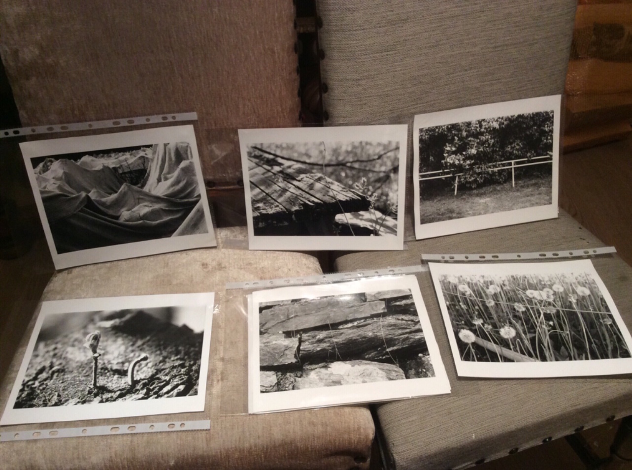

    I'm actually thinking the 690 will replace my 35mm camera for walk around (without target) shooting, whilst the 4x5 I can take out to more specific sites. The 35mm I can keep for family/fun.
    I also like the 6x9 proportions. Good to hear that up to 16x20 you feel the look matches a portfolio with larger negative enlargements. Maybe a GW690 is in my future :smile:
    Interesting point about tendencies in viewing different paper sizes. Im going to reprint some of these to continue to see how much I can get out of the negatives and get more aesthetic variation, but maybe limiting them to 8x10 is also a good idea, thanks. Later photos can always be larger.
    Will probably print the native 6x9 ratio with the 690 as I already like the 35mm framing. And yep, I find photographers really like to get in close to a print compared to the general public :smile:
  10. OP
    crumpet8
    crumpet8 Member
    Messages:
    395
    Joined:
    Nov 3, 2015
    Location:
    Scandinavia
    Shooter:
    apologies for the poor lighting on the prints, in my apartment, on the chairs. Thought I'd just show what pictures I'm taking rather than quality/detail.

    Those prints look horrible! The tonality is way off and I can see the grain from a mile away. At that size, you should only be making contact prints!:wink:
    Seriously, what's the reason this person says you should only be printing from 4x5 (or larger) even at a 8x10 print size? IMO that's pure snobbery. Respect or not, everyone's standards are different and this person just wants you to conform to theirs.
    Do YOU like your work? Should you print 16x20's from 35mm? Maybe not, but if you really want a 16x20 of something you shot on 35mm, then by all means print it.
