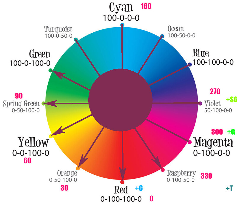

Personally, viewing filters are not very helpful to me. I scan into photoshop, analyze the curves and color balance to get an idea. It can be a tedious process when you first begin, but once you find the correct filtration settings you can pump out prints extremely fast. I normally over-expose c-41 but they're all at similar density, and print 8sec@f11 or thereabouts. When you're close it takes only slight filtration change to get the color balance you want. Just need a color wheel:
cmyk-HSB by Aaron, on Flickr
I have read nearly everything written online about RA-4, from here, RFF, LFF, flickr, read all the tutorials and watched everything youtube has on the subject, which are mostly short ten minute clips. There are some very knowledgeable people on here who have done RA-4 professionally for years. Don't worry about the learning curve, as you can get answers pretty quick. It's more fun than B&W printing.

I clicked on the link you provide. hoping that there would be a full, explanation as to what all the figures mean but there wasn't. Can you help here with an explanation or a link to the explanation? Thanks
pentaxuser
1kgcoffee
Jan 19, 2017
500
Calgary
Certainly. The numbers below the colour xxx-xxx-xxx-xxx refer to CMYK. The numbers next to that in red refer to hue. I'm using a new method of printing color with condenser head and LED light bulbs that outputs coloured light controlled by hue saturation and brightness. For typical film it's in the range of (H:327, S:0.3) and (H:333, S:0.3 - ie 30%) If you follow the line from raspberry to the center wheel, thats about where I print at. Just imagine that the color becomes less saturated towards the center. I guess it would be equal to M-45 Y-45 which is typical for endura. All the advantages and pitfalls of a condenser head for RA-4 printing
If you add red, the print will become more cyan, that's what the "+C" denotes beside Red. It's basically a supplement for helping me to evaluate colour balance
