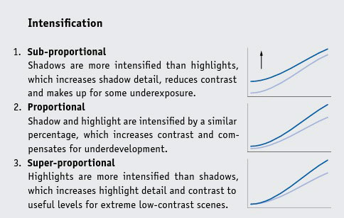

Selenium toner can be used for proportional intensification (highlights and shadows are intensified by the same percentage, which increases contrast). What you want is a sub-proportional intensifier, which increases shadows more than highlights and reduces contrast. However, the chemistry too toxic for me to realistically recommend it. If you are interested, search the web for articles by Liam Lawless. I consider him to be the expert of 'Negative First Aid', which is the title of his four-part series.

That's what proportional intensifiers such as selenium do. They are called 'proportional', because they affect highlight and shadow densities at about the same percentage. But a 10% increase for a 0.1 shadow density is not the same as a 10% increase for a 1.2 highlight density, hence, the contrast increase.

Attached a simplified graph, how intensifiers work. Selenium is a proportional intensifier. You'll find recipes for all thee kinds of intensification, but most ingredients are too toxic to recommend without strong hesitation.
