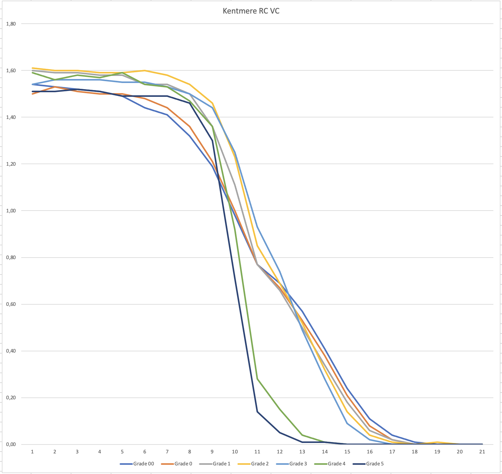

Well, here is user-provided family of curves #1, then. This took me maybe 10 minutes using the Dektronics and Excel, measuring and graphing the data from a stack of Kentmere RC VC test prints made with a Stouffer projection strip. I will redo them when I have the time to sit down and characterize my materials properly, but this is a thing of beauty:
This paper seems to have a problem. Hardly a slope difference between 2 and 3, contrasted with big slope difference between 3 and 4. And Dmax in the range 1.5-1.6. Old paper? Matte surface?

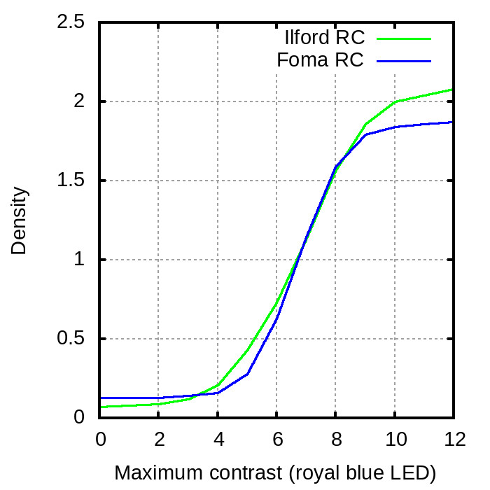

Mine arrived today (that was fast!).
And one paper-graph deserves another. Here is Ilford RC (> 1 year old) compared to Foma RC (2 months old). Both stored refrigerated. This shows both papers at maximum contrast (blue light). On the X-axis, three steps is one stop.
Foma has higher max contrast than Ilford, but Ilford has whiter white and blacker black.
It's a quick and dirty graph, so no pretense at exactitude intended.
