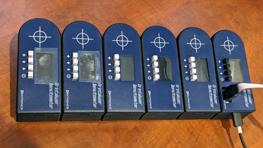

Its been a while since my last post, and while I've been posting plenty on the Dektronics social media feeds and YouTube channel, I figured I should post another update here.
I've now built several more of the pre-production units, and you can see here:
The first two on the right are for my own development purposes, the next two were recently used for EMC compliance testing, and the last two on the left are the first ones I'm planning to send out to actual test users in the near future.
Yes, last week I actually took the Printalyzer Densitometer to an EMC compliance testing lab! Everything passed, so as soon as I get the report back I'll be updating the labels and documentation to reflect all the regulatory language. This is the last major piece of "red tape" before I can start publicly distributing the device.
Here's short video I made where I talk about the various bits of product testing I've gone through over the past month:
From here on out, my plans are to build and distribute a couple more evaluation units, and then use the feedback to polish the device software and documentation. From there, I'll start gearing up to actually build production units.
