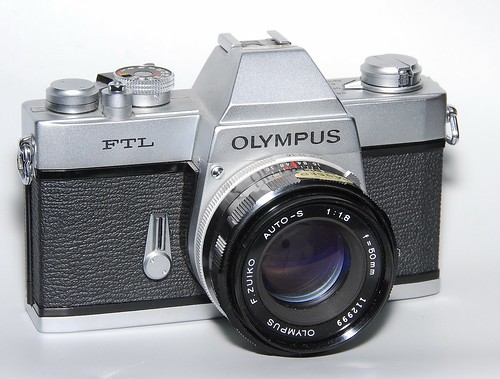

Do you know for how long Olympus FTl was made? Never seen one?
Not long 1971 - 1972. Full aperture metering in a screw mount camera.
