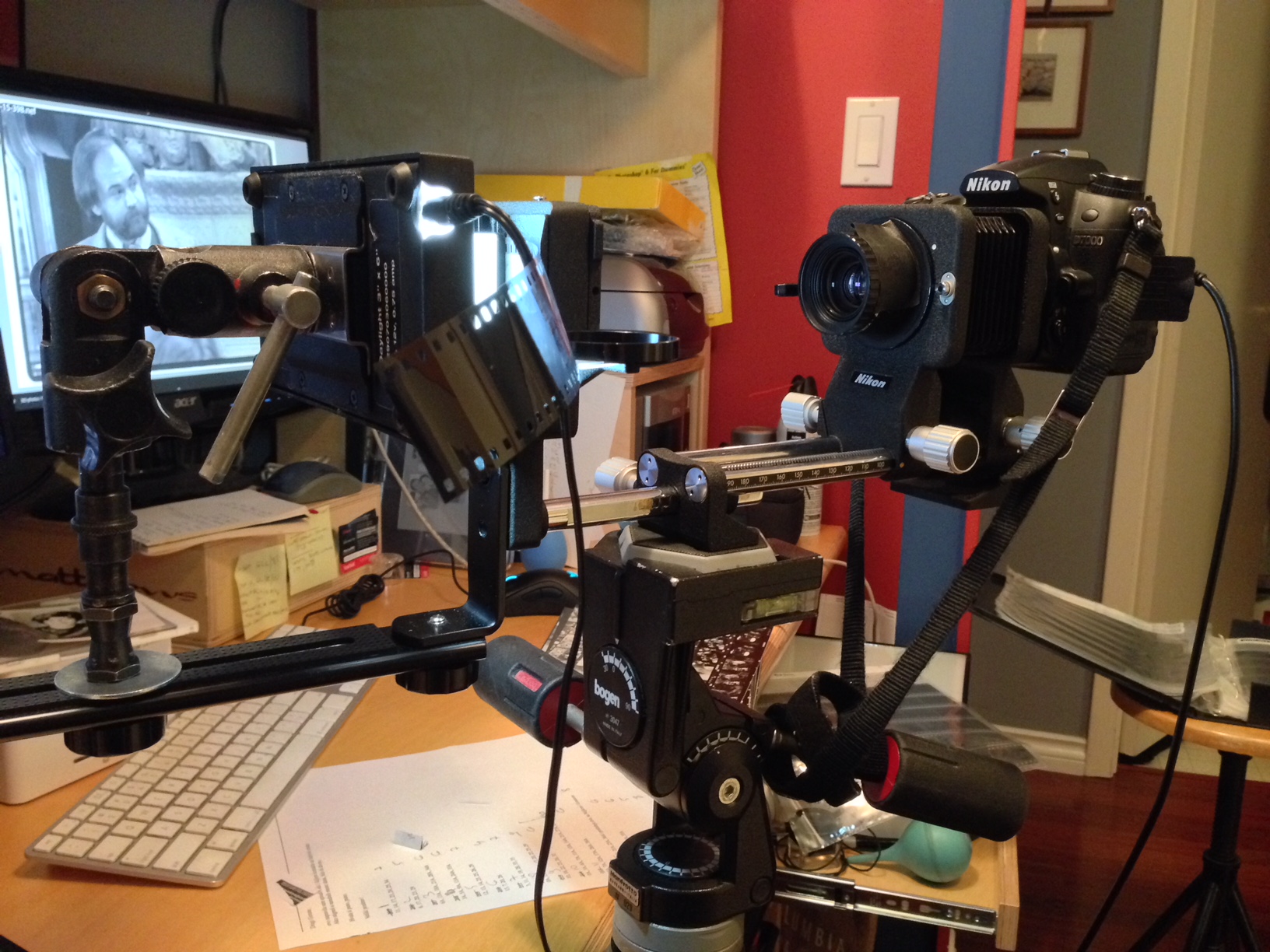

Laci, I'm using set up with Nikon D7000 to copy 24x36 for more than 5 years now. I'm talking from my experience. This is my set up from 3 years ago, kind of midpoint. A few things changed since. One significant thing is, I changed lens to 75mm, no practical difference in the set up. You see camera model, you see full frame on the monitor and 80mm enlarging lens on bellows, what else I need to prove to you? Back in the film days Nikon designed bellows and Negative holders to be able to do 1:1 with Micro nikkor 55mm at infinity with bellows at minimum extension and it is still valid with full frame sensor.

For me this setup is ideal for 35mm negatives. For 6x6 negatives I have totally different setup.
If you do not use bellows you mention and use extension tubes you will be use to use 50mm lens for your copy process. You will need to experiment with length of the tubes and that is reason why bellows is easier to use.
Question is how are you going to line up negative and camera to be perfectly parallel and keep it that way during the process? From experience I can tell you it's very hard and that is reason why I picked Nikon PB-5.
