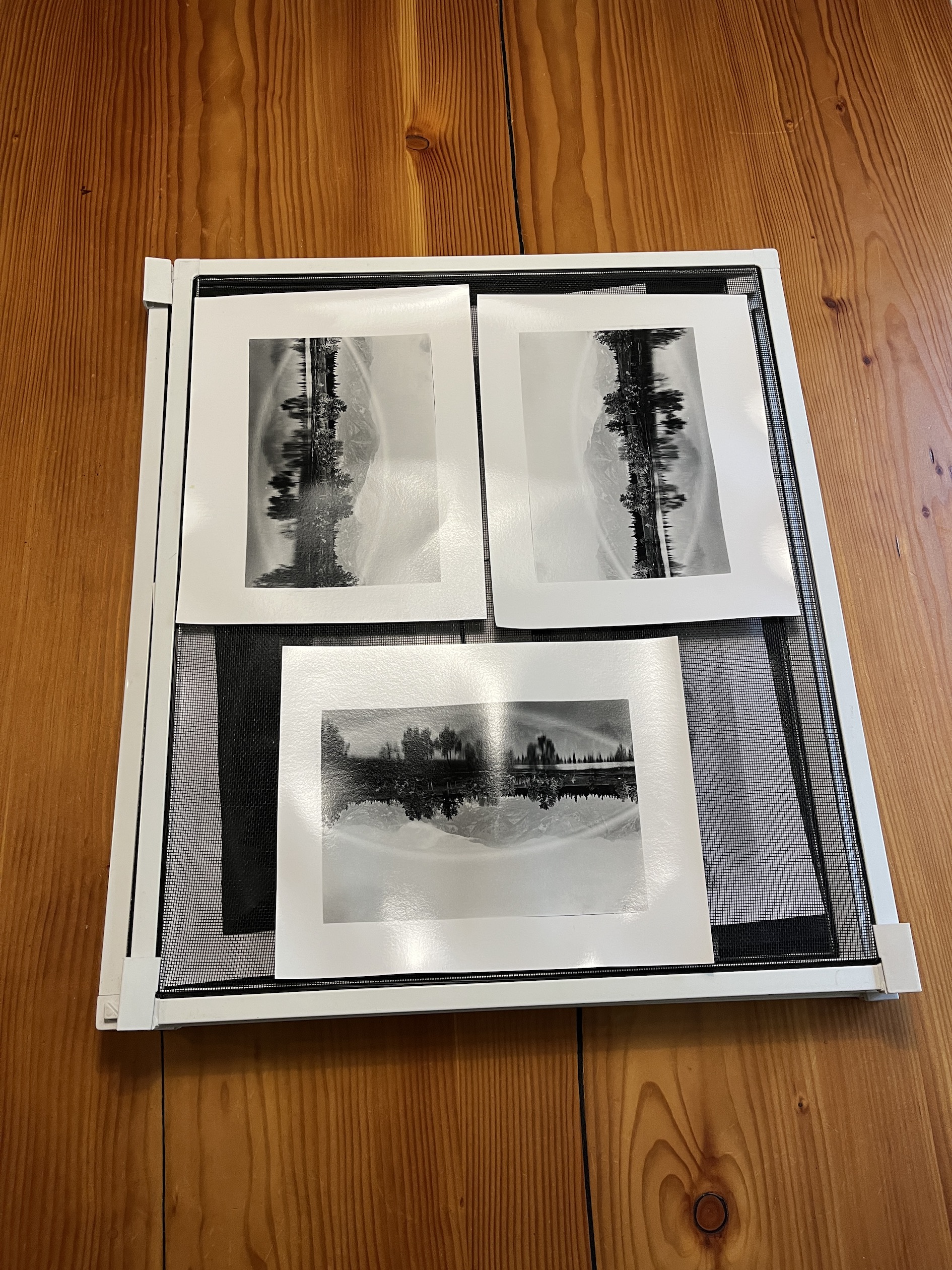

I have 6 screens, fiberglass, expandable window screens, the size I have can dry one 11X14 or 2 8X10s on each screen, because of the frame they stack really well.
There are larger sizes, I got the size I did as it fit on top of my patio table.

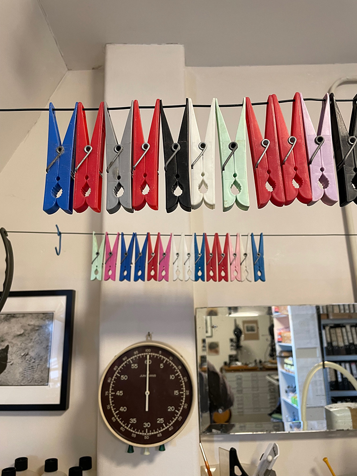

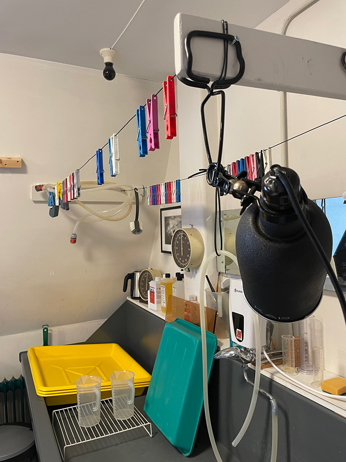

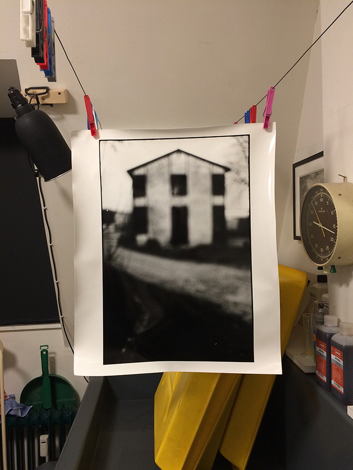

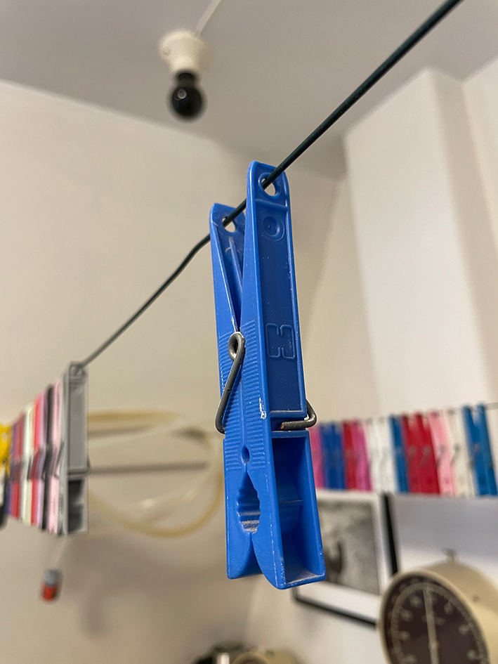

Hi Matt, I think very differently about this. I have always dried my fiber prints by hanging them above my sinks, since the mid-eighties. Never ever they came down. I have always done (still do) lots of 16x20 in. and 20x24in. First Agfa Record Rapid, then Ilford warmtone. Almost always glossy paper and for sure the larger sizes were on glossy paper.
(I can't be sure if this way of drying also goes well for matte or semi matte papers. But I think it will).
It was dust and lack of space that made me experiment with this. The printer who trained me (about 5 years in a Paris lab) had the drying racks that, of course, worked fine. But they needed to be kept clean from dust once every month, and sometimes sooner. We didn't like that, but couldn't find a way to prevent it. He should have built closed off drying compartments, but there was no space for that.
See the attached images. These pegs are 10cm long. Of course, they leave a mark on the paper, but as said before I trim 1cm off the print, all four sides. With fiber paper, this trimming helps to get very flat prints, together with the drymounting press. The last image is a 20x24in. print.
