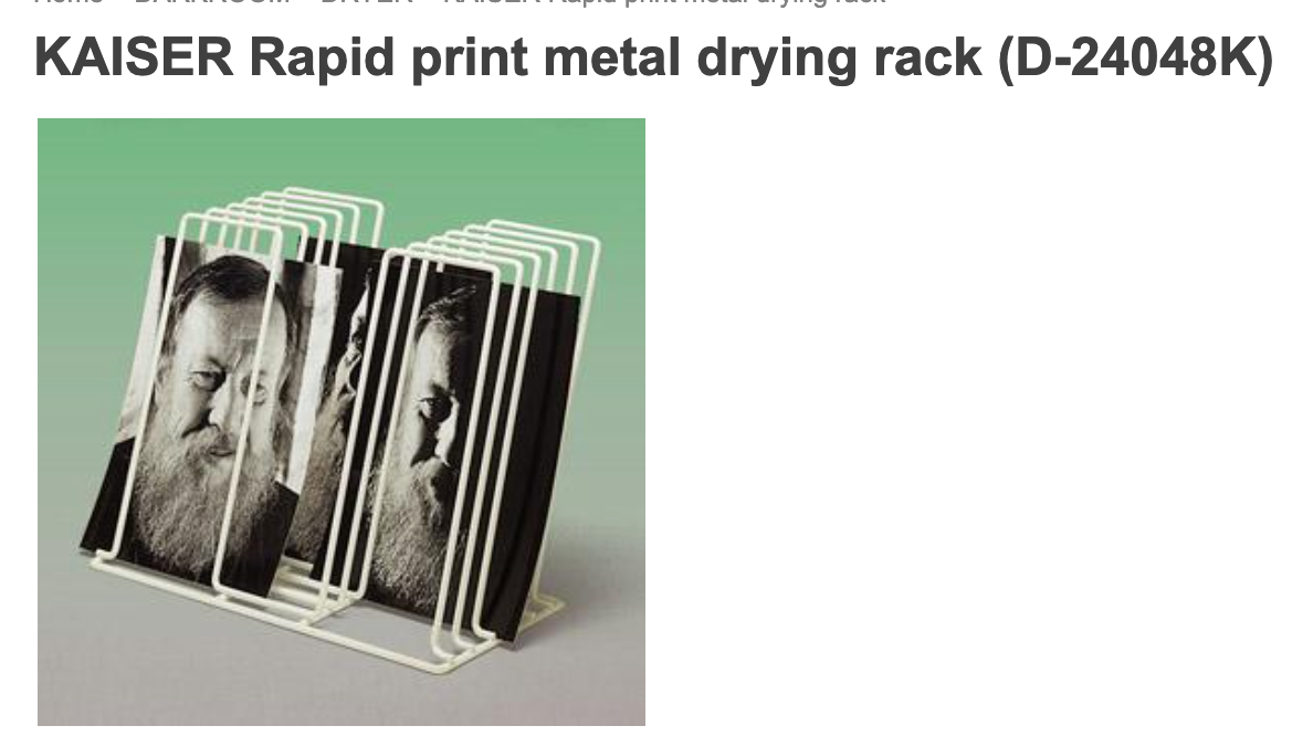

Hi guys
Here is a quick question
Due to space constraints, I cannot use fiberglass screen when drying fb paper, so my question is: is it possible to use rc paper rack and then use Heat Press to level fb paper?

I don't see why not. I don't know your heat press. I use fiberglass screens. Once the prints are completely dry, I flatten mine in a drymount press. I'd just watch the temperature. I use 190F for a minute or two (sandwiched between mat board with a layer of release paper.

I use a couple of dish racks, the folding kind for RC, I just let them air dry unless it is test print to find how a print drys down I use a hair dyer. FB I dry on screen outside on my patio.

if you use dish rack to dry fb, whats happend? I also use dish racks to dry rc in my dish washer
Too much curel, face down on a screen with a second screen on top FB dries somewhat flat, I then put into my mounting press to flatten.

It isn't very easy for moisture to escape from a heat press. I think you might have to take the print out to steam and in again a few times.
Before that, try a cold press. When the prints are dry enough that they don't flop when handled by the edges, stack them up neatly with a clean card or waste print at the top, and put them under a sheet of heavy glass with some books on top. (I use a sheet of strengthened glass from an old double glazing unit.) Leave them like this for a week. You can get FB prints surprisingly flat like this, and you may then consider the hot press unnecessary. It's best to do them in a stack so that there is an air gap at the sides for moisture to escape. Judging just when they are dry enough to place under the glass is something you will learn quickly. If they feel limp and cold they are too wet and will stick together. If they feel crisp they will flatten eventually, but not so perfectly and will take much longer.
I think your main problem will be to avoid pressure marks where the print touches the rack. If you can achieve that, you are 90% there.
